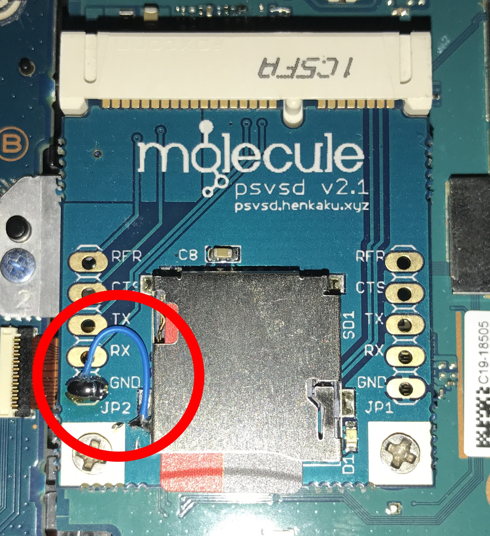

U might want to add some of this to your index of psvsd Data while for spheresolid versions might not have this issue older ones might and you night want to make sure they know about it. I did what the original poster u/M1lk4h0l1c did on vitahack it fixed my right up but it was a devil of a time finding the information
https://www.reddit.com/r/vitahacks/comments/6x28bz/psvsd_v21_fix_for_microsd_card_detection_issue/
