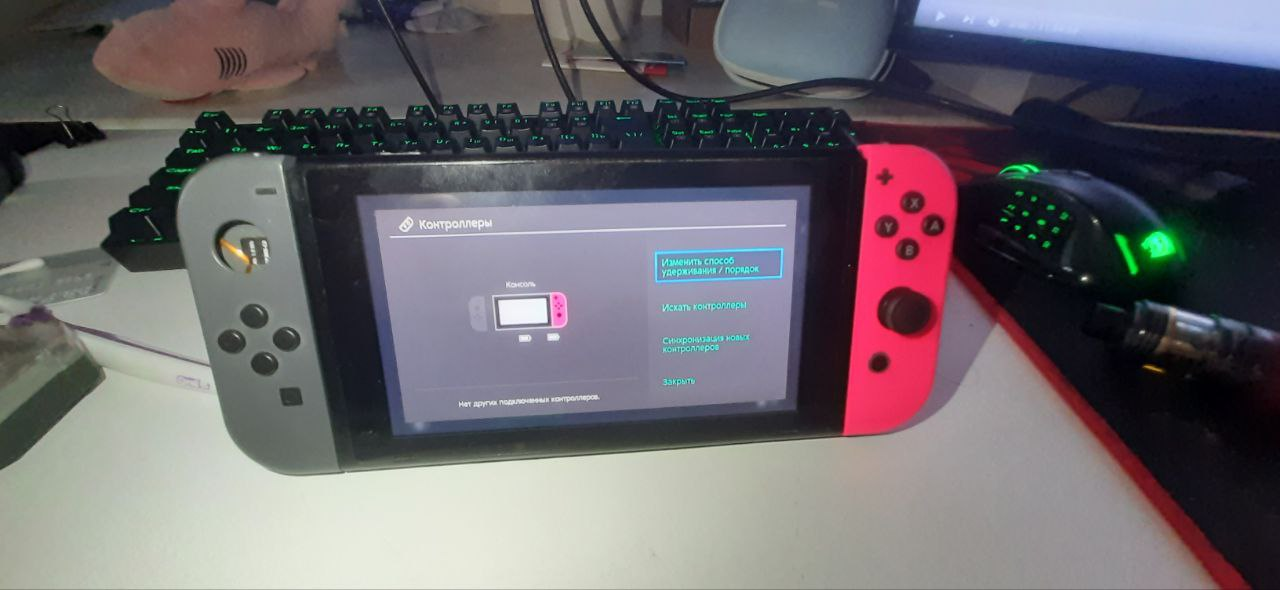

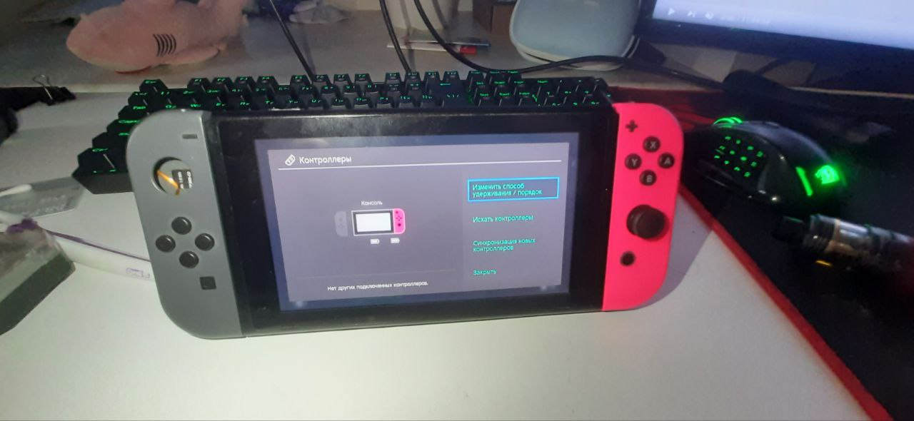

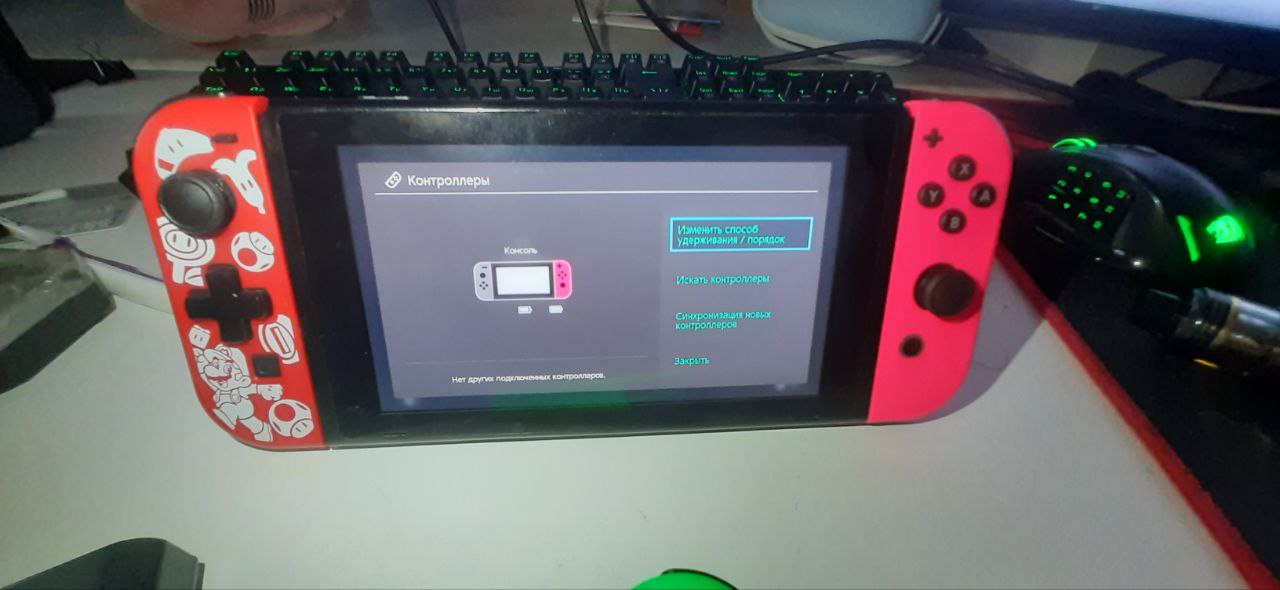

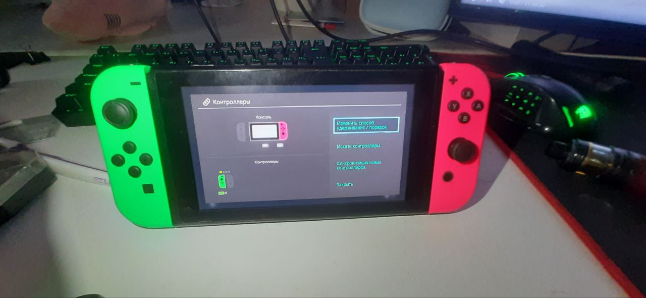

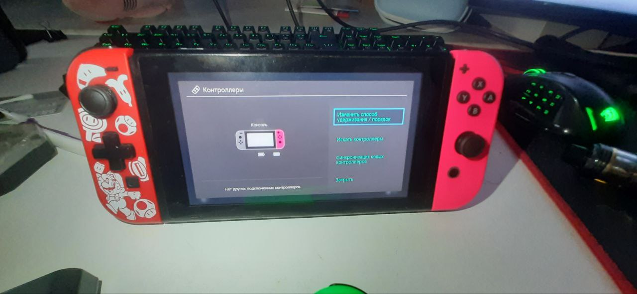

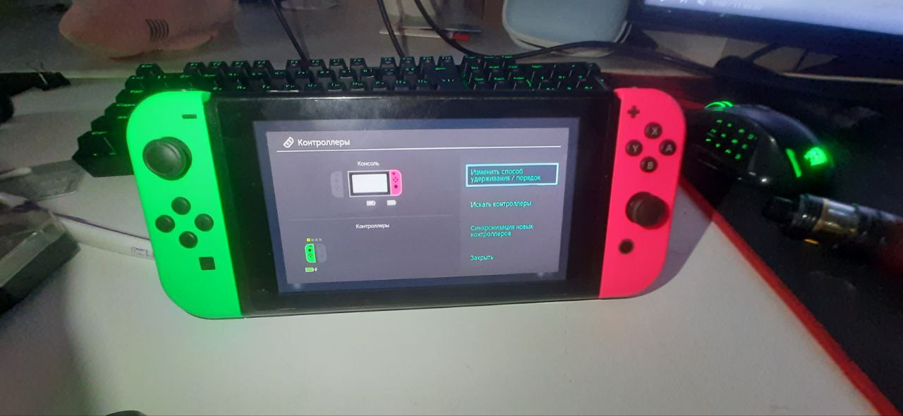

Hi everybody. I am writing again with a problem that I have not found a solution to on the Internet. The fact is that I bought new joy-con and they worked fine for 1 month. After that, the left one (green) began to be defined as connected via bluetooth (although the console is in handled mode). Sometimes it connects (I didn't find a pattern, it happens randomly) and works fine for a while. Before this case, I had not installed syscon\mission control. And the fact is that this happens with both the new and old joy-con. And when the console is connected, it even determines its color! (I see a green or gray color on the left, when connected, but the joycon is only charging, and no more.) At the same time, it is a fake (which does not have bluetooth - it works fine!)
At the same time, there are no problems in hekate - joycon works as it should.
I've already tried all the ways from Google. I deleted all the controllers, cleaned the contacts, and rebooted the console.
I have last version Kefir \ Hekate \ Atmosphere and hwfly chip. Switch v1
Pic 1 - old joycon
Pic 2 - new joycon
Pic 3 - hori clone joycon (only handled)

You probably need to replace the left joycon rail on the Switch side.
Reactions: BigOnYa
I've also seen that when installing the mod chip, when removing the the metal lid on the CPU, its possible you have damaged trace lines on the motherboard. Just a possibility to look out for, good luck.
And how does this explain the fact that HORI works fine, and that any joy-con works in Hekate?
I read this in the next topic, but the fact is that the mod was installed about 4 years ago. The only thing that has recently been the repair of smd components on the power supply chain... Could it have had any effect?
