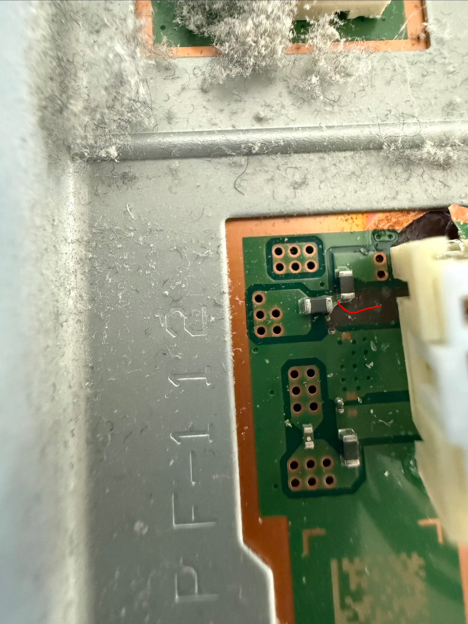

I bought a ps5 knowing that the power connector on the disc drive was ripped.
3/4 lines are no problem restoring.
But the last one is a little bit tougher.
Is my only option here to solder a jumper wire where the caps are? Or is the alternative points. See the picture and where I have painted a red line.

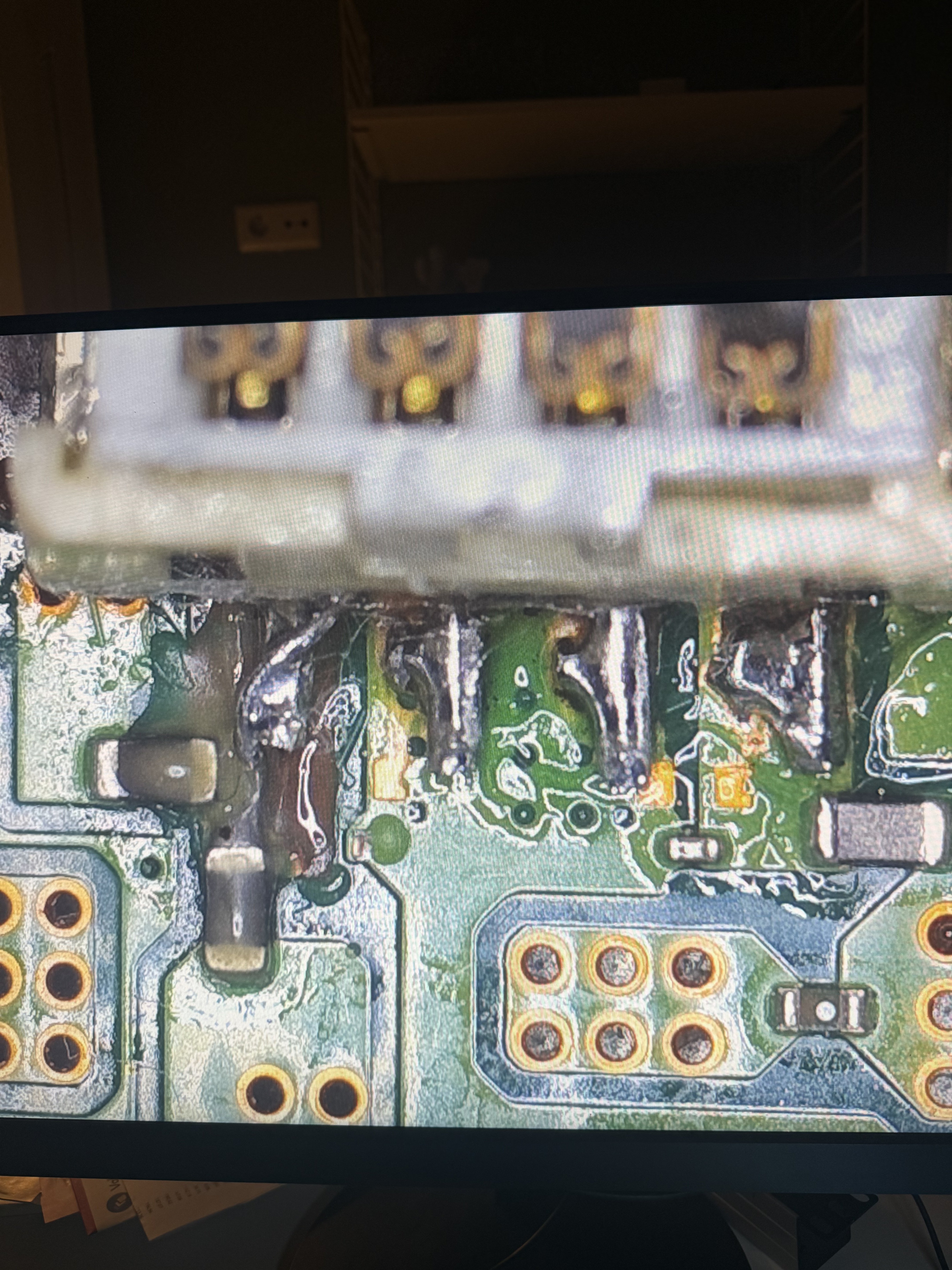

Fixed! Did as i suggested myself, now the system is up and running and the disc drive is working properly, did bend the connector pins the other way and did scrape and solder. Did use a jumper wire between the 2 caps to the connector pin. Works perfectly
