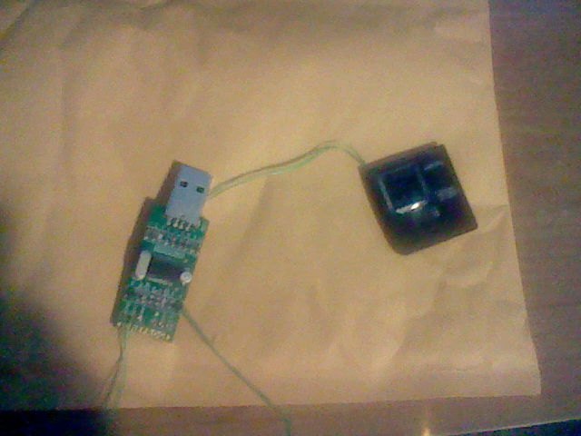

I asked for something that would help me debug the 00000000 return address problem, and received this.
A Supercard with exposed chips, but more importantly, serial port wires and a USB dongle at the end. It outputs at 57600 or 115200 baud via the JZ4740's UART and its input and output are accessible to Linux at /dev/ttyUSB<n>. I'm free to implement memory dumpers and function loggers over that bus; I just need to define my protocols. The serial port may also survive some of the "crashes" of slower-rendering games at 0 frameskip and allow me to see what's up a bit more.

a) That is correct. This debug Supercard has exactly access to the same things as a regular one. A regular Supercard also has a UART for serial line output, but no wires come from the pins at all, which is the only difference.
b) During the Supercard's initialisation sequence, only the very unhelpful characters "BC" are ever output, at 57600 baud. That won't be useful :P
