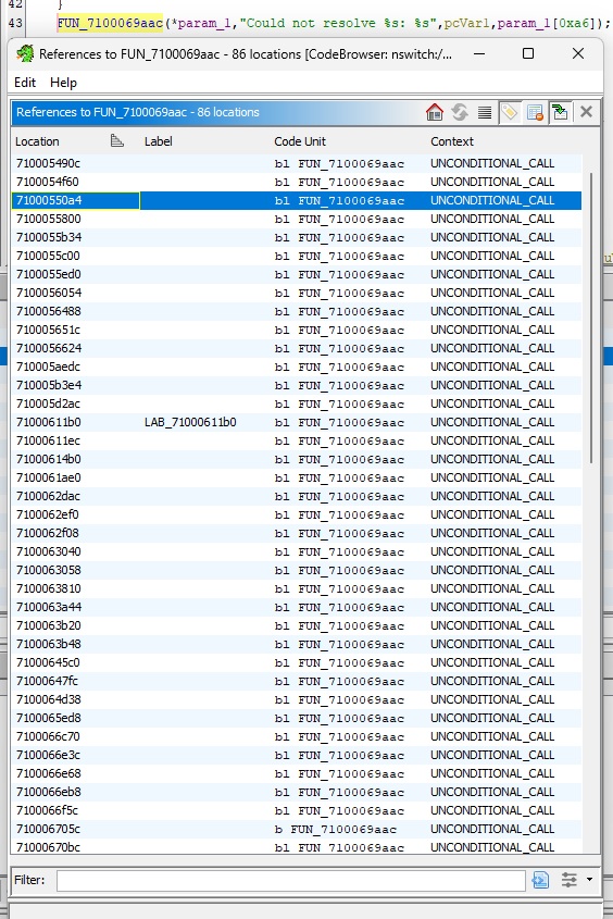

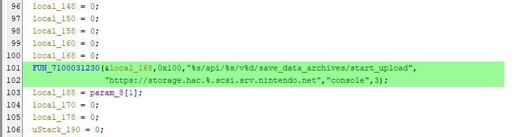

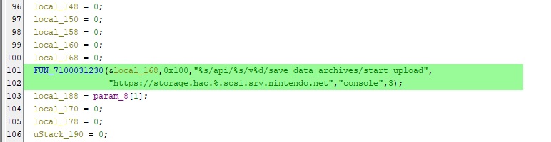

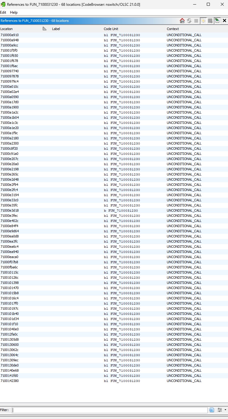

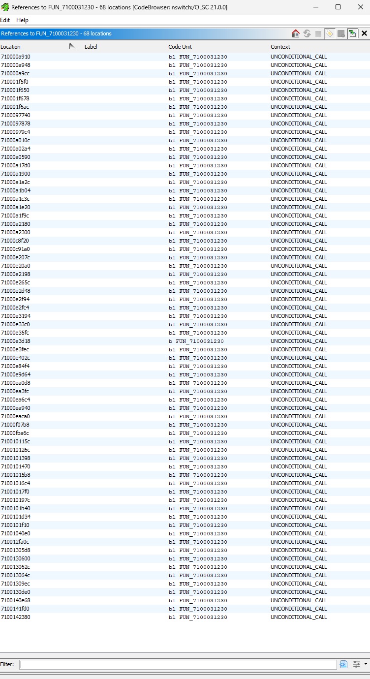

1. read switchbrew documentation
https://switchbrew.org/wiki/System_Settings
https://switchbrew.org/wiki/OLSC_services
2. pair knowledge that error 2155-xxxx is HTTP
3. open up OLSC in ghidra, start work.
4. identify what function is doing the downloading and uploading of saves (0x31230 21.0.0)
5. identify function that handles failed http transactions / reports errors whenever it's not doing what it should ( ultimately 0x5a740 is what sets the instruction for -2, 1, or 0, with 1 and 0 being fail conditions
6. all of the relevants calls for 0x31230 originate from:
0x10aa20 and 0x10c210
identify which codepath checks for airplane mode, force patch it into always thinking its airplane mode

Hello everyone, with atmosphere, syg or sys patch, mission control, every time I start a game, whether it's original or nsp, I get a continuous “please wait” loop. While deleting files and pasting, I managed to solve the problem, but when I copied some files back, the problem returned and now I can't remember what the solution is. I also tried reinstalling games, but nothing worked. Thank you all

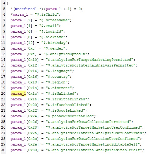

it's unlikely to lead anywhere as im not familiar with anything not signature verification related.
im going through linkalhos codebase https://github.com/Switch-Bros/linkalho/blob/master/source/core/generator.cpp#L19
C++:
static auto PROFILE = R"({"id":"#NAS_ID#","language":"#LOCALE#","timezone":"#TIMEZONE#","country":"#COUNTRY_CODE#","analyticsOptedIn":false,"gender":"male","emailOptedIn":false,"birthday":"1980-01-01","isChild":false,"email":"•","screenName":"•","region":"","loginId":"•","nickname":"•","isNnLinked":false,"isTwitterLinked":false,"isFacebookLinked":false,"isGoogleLinked":false})";
(there's also a 0x32] = "$.analyticsForDataCollectionEditableSelf"; below this as well
from what i can tell linkalho's order of affairs is incorrect, and missing new tags
C++:
