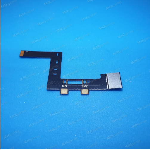

Hi so I installed sx core on a lite.
It all worked as the instructions said, flashing blue light, turns to green and red error message on the screen.
Left it for a while, came back to set up emunand.
Started ok, entered into the menu had it plugged in it started setting up emunand but came up with an error message and turned off.
Now doesnt turn on? took the back off to look, took sd card out and press power button it flashes blue but then goes to a solid bright I think white light, nothing on screen.
I have read through as many threads as I can and can not seem to find this issue?
I did think it could be the ribbon cable was damaged as I managed to get it to work once after disconnecting it and trying to straighten but its not worked again since that one time?
Could it be the cable or could the chip need re-flashing?
Any tips would be great I don't want to de-solder the whole thing but will if I have no other options?
Thanks
This is the cable I mean?
I believe you need to reflash the mod chip firmware. connect it to a pc via the micro USB port and update firmware using sx updater and the latest firmware from the website.

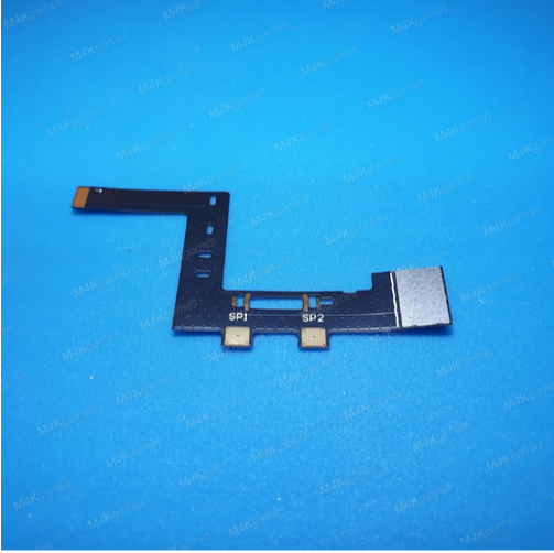

Thanks

Hi, this was not the problem and now it works fine. I found when I kept trying to turn it off and on at first I had this issue with the white light. If I turned it off and left it a couple of minutes it was OK. I think it just needed time to reset and catch up.
