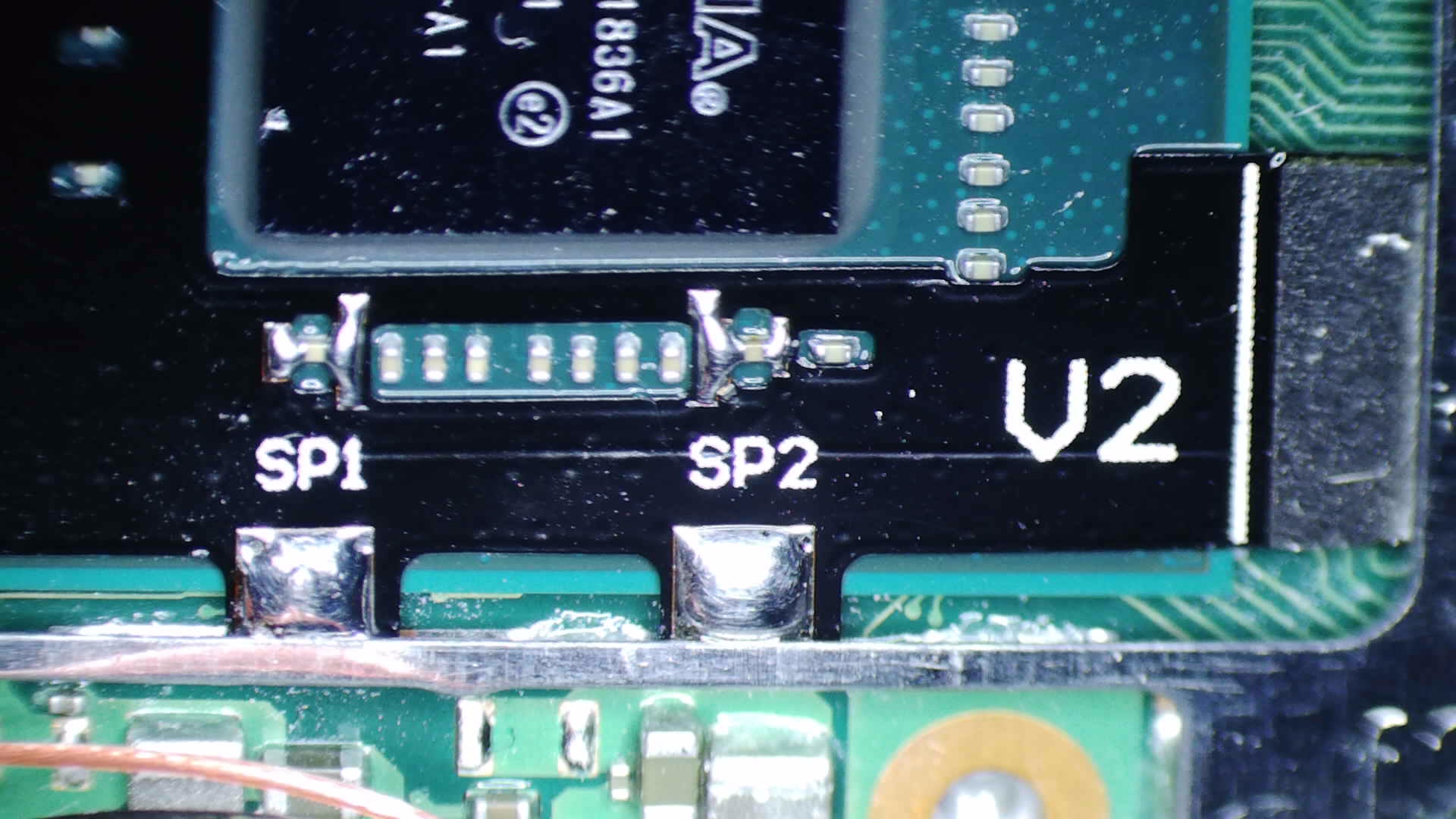

Bridge one side of the qsb pad to left side of the cap and so on.
Some people bridge everyting or remove caps, or remove the pads on the cpu.

They are not supposed to be bridged by solder or removed. Otherwise the install would be much easier!
"Test units recieved" thread has links to new capacitors in there somewhere. Someone with more knowledge can follow up to tell you how important they are. Good luck
And this thread has them, but now is more clear,first i just posted the link with no explanation.
