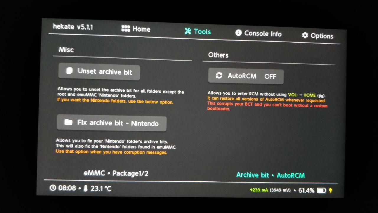

Yes AutoRCM is disabled:

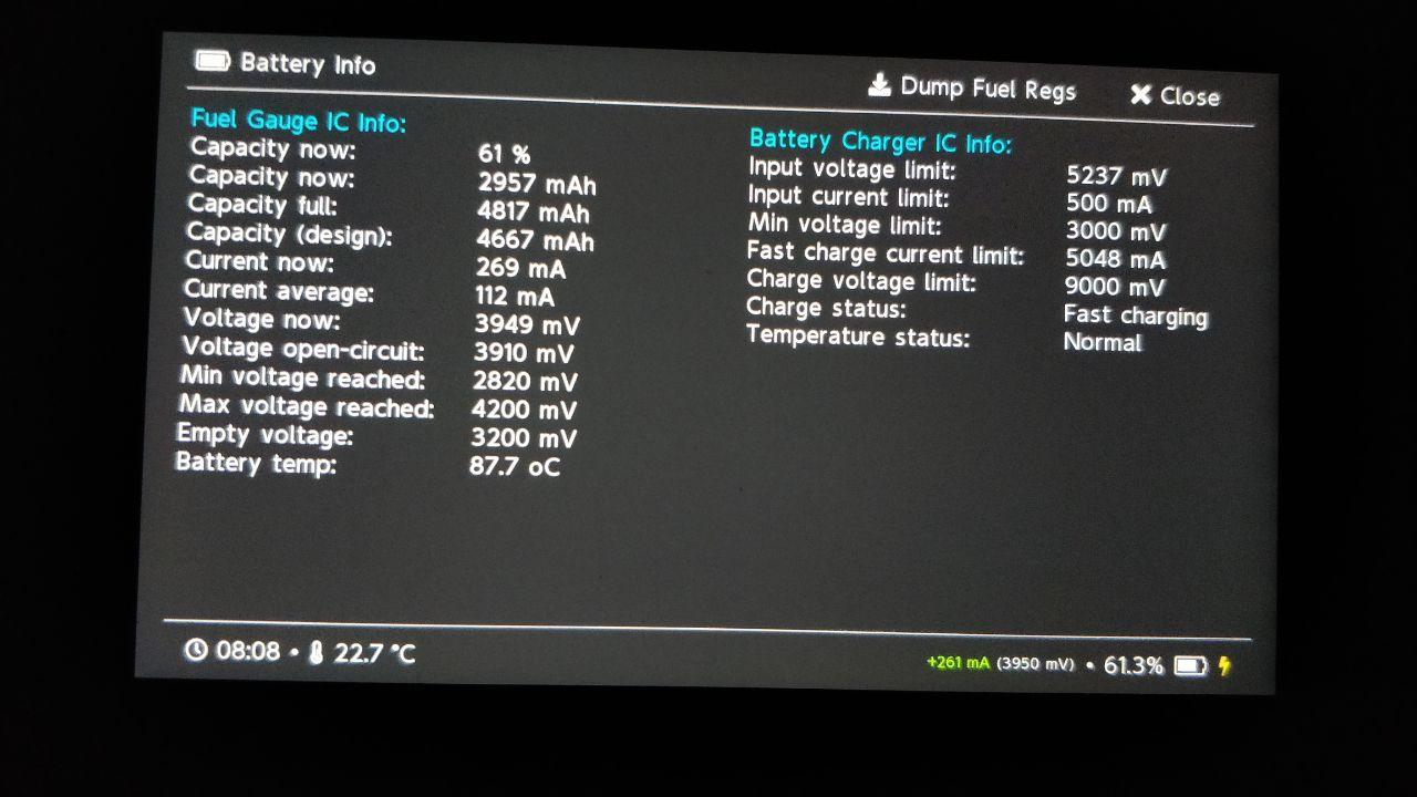

I've done some more testing and it seems the switch will only charge to around 60% when off
I have also tried a spare battery and it did the same thing!
Here's a picture from the battery status:

I believe there were battery sync issues early on with some linux builds or something, and possibly there was some homebrew created to fix the desync issues, but you would need to do some researching.
https://gbatemp.net/threads/ctcaers-hekate-w-battery-desync-fix.509321/
There was also some battery related issues with a certain FW I believe, as well as faulty docks and chargers breaking Switches, is it possible you have a Switch that has been subjected to 3rd party chargers breaking it?
I forgot to mention I've tried that fix before, I believe it's similar to pulling the battery out.
I'm not sure of the switch's past, but I would have thought if a 3rd party device broke the switch charging, it wouldn't charge at all?
Ah well, was worth a shot, and who knows but it's got to be an issue with the Switch if you have tried 2 batteries. I'm assuming the cable is fine and genuine, it just sounds like the Switch isn't charging as fast as it's draining, which to me sounds like a hardware fault if I'm honest, could be the port or a dodgy capacitor maybe. Hope you get it sorted
