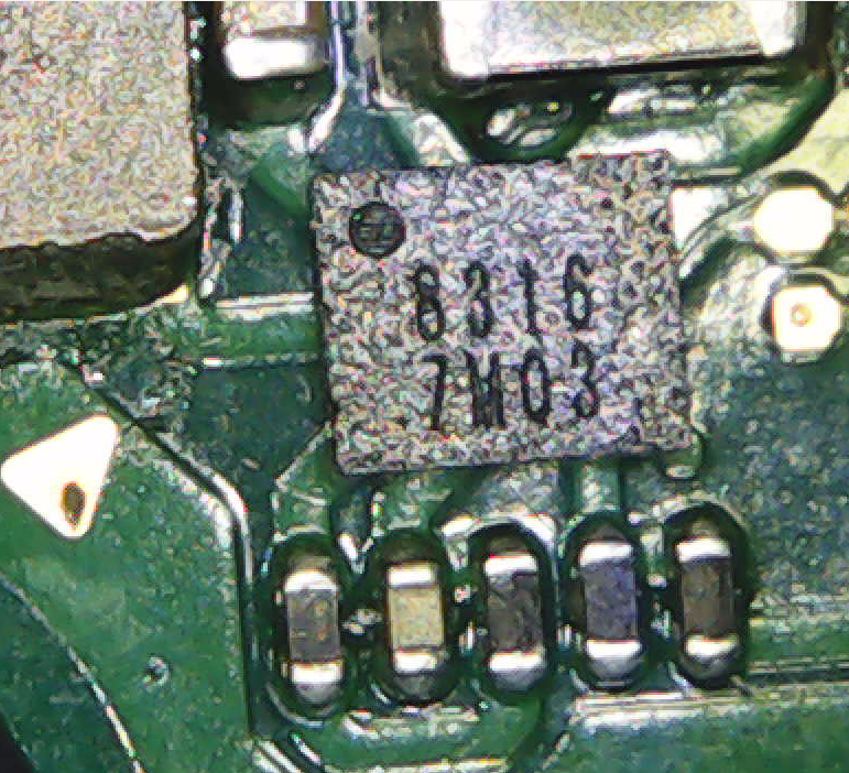

So I have a working LCD, checked the diodes and they seem good, as well as the inductor passthrough components and those seem alright. I suddenly noticed something i didnt see before, what appears to be a damaged IC near the LCD clip. It looked like a piece of glass was wedged underneath it, and it seems like its part of the chip itself. Pictures included/ (sorry they are bad pics)
Before I test too much further do you think this could be my issue?

Thanks for tagging in. I actually fixed the joycon issue, and had someone else assemble it for me. They then informed me of the new issue of not having video in handheld mode I post pictures of what appears to be a damaged component which perhaps you have an idea regarding it. Thanks in advance!

I imagine it is the LCD timing controller or a DC/DC converter (though I think DC/DC conversion is handled elsewhere).
The reason I say that is there is an inductor and a capacitor which is probably used for timing purposes.

I might be wrong but I think that's how chips look on the inside (silicon wafer? not sure)
Might the plastic have been melted?
Anyway, it might not actually be damaged. Hopefully it's just the exterior coating and the inside is fine (or maybe hopefully not, since that means you have to look elsewhere for the fault)

omg lol how did you get that to chip off!! ahaha
it looks like a DC~DC converter, similar to the one next to M92 chip, I just took a pic with the microscope from one of the boards I have here in case it helps

I`ve found a couple of chipped ones on my (bought as scrap) boards.
It seems that when people are using tweezers to get the ribbon out, they are levering on the IC to lift it.

Every pin needs to be sat correctly in the FPC connector.
Best way to replace, is to heat it up from the underside of the board. Around 370 degrees. Will lift off when ready.
Otherwise you will melt the BTB stacking connector for the emmc & fan / switch FPCs
100% agree! I would like to clarify one point if you have opportunity to preheat the board or "oven treat" on 200C do it first, that will prevent board from delimitation(bubbling) and wrapping... i had one switch on repair... that started to bubble right the second i heated it up.... so disappointing... it breaks the traces in to the internal layers.....

Absolutely correct.
Or just increase the heat gently. Do it in stages.
Don't go hotter than 260 degrees over plastic

Not sure about my heat-gun readings, but my one doesn't melt the "switch" plastic elements before 340(C)
I replaced the alleged DC/DC converter and had no change unforunately. At least its not worse than it was. I cannot be 100% sure my swap was flawless though. Back to square one for now :(

@Pintglass kindly mentioned could be a BD8316GWL ... (thanks for that mate! btw) could you post some pics of the bottom of the chip? how many balls/pins etc. maybe we can find a datasheet from which we can read voltages and you can use that to check if the right voltages are getting to the chip
