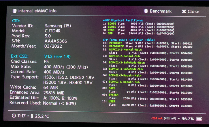

You probably meant the emmc.
Just my assumption, likely Hekate pulls the SKU information somewhere from the emmc.
Sometimes the emmc connector goes bad over time.
Just opening to do a repair is enough to make the emmc stop working.
If you emmc is fine, you should see something like this in Hekate.
If you get an error message that the emmc is running in 1-bit mode, then there is something wrong with the connector.
You could try pressing the location of the connector down gently while booting.
Sometimes, people press on the emmc board with too much force and then pins bend or break.
Hekate boots without anything from the emmc.
The BOOT0 and BOOT1 partition should be valid in order to both the CFW/OFW.
BOOT0 and BOOT1 are not encoded specificly for each Switch.
If they are corrupt and you need to repair them, just make sure you have the BOOT0/BOOT1 for the same model.

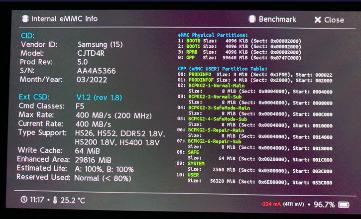

Have had some to check the switch again, did check that page and it looks like it's okey.... But this is the information I get from Hekate, is there anything in this information that tells me what's wrong with the device?

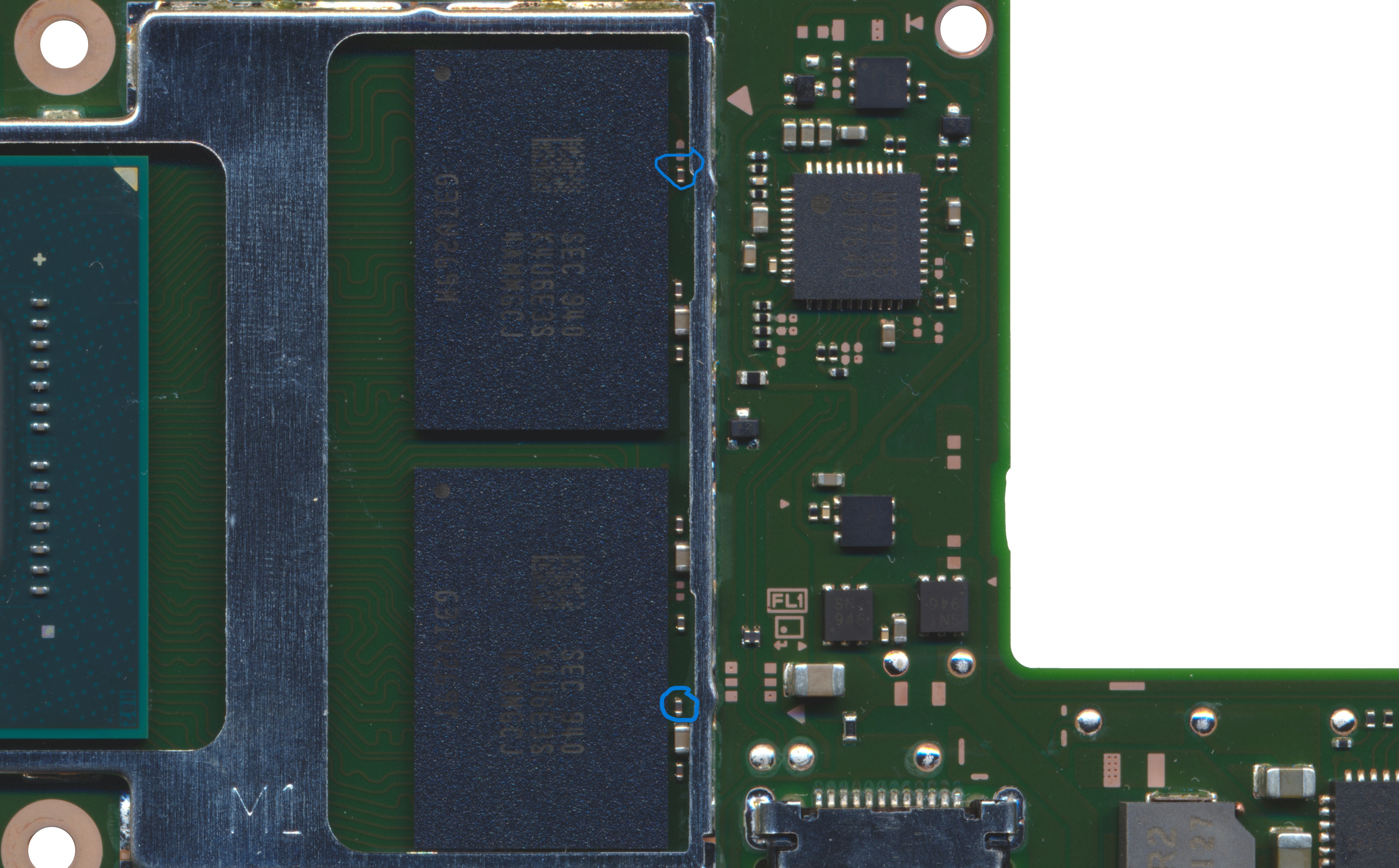

Hello,
Random question but does anyone know the value of these resistors next to the DRAM on a V2 switch?
