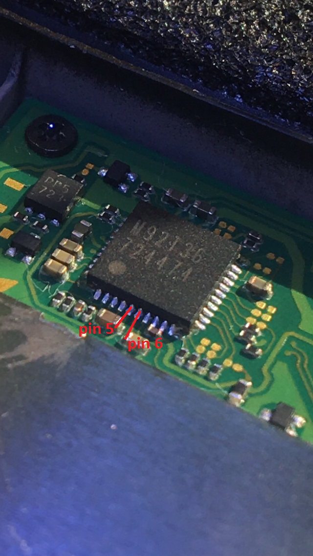

Often the M92t36 chip from the logic board is the one that creates this problem, but until you make some multimeter measurements on it, you're not sure if it should be changed or not. Measure with the multimeter if you know and check pin 5 and pin 6 on M92t36. Plug the charger. If you have between 3 - 6v on pin 5 and 6, it s not the M92t36.
Read these theard carefully and you may find what interests you.
https://gbatemp.net/threads/m92t36-or-bq24193.528016/
