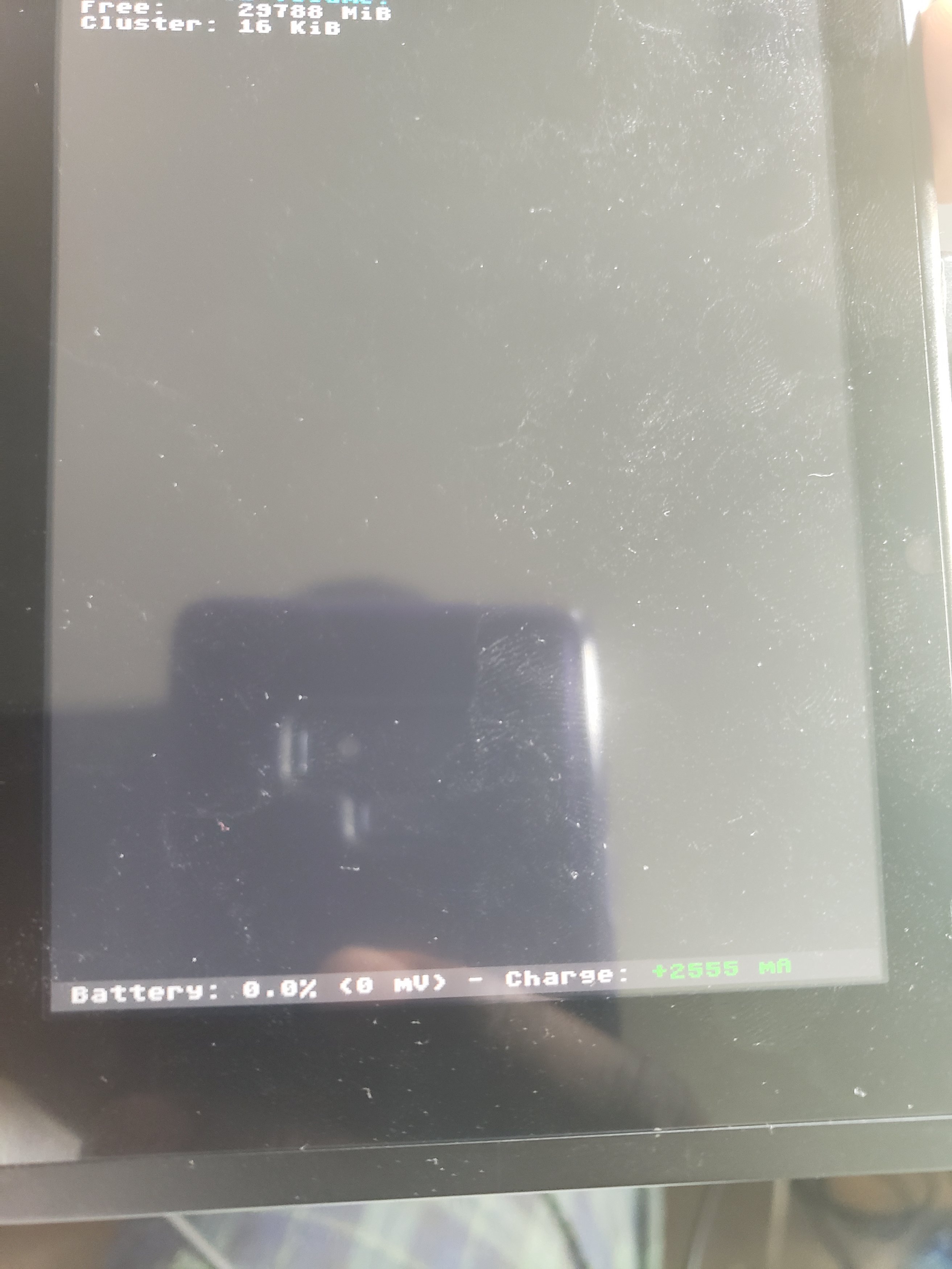

    It booted the older version of hekate as @Ttm3 suggested but it doesnt read the battery state. I replaced the bq241 but it still would not boot or read the battery. Tried different batteries with same results.
    it stays on even without the power cable on hekate or any other payload

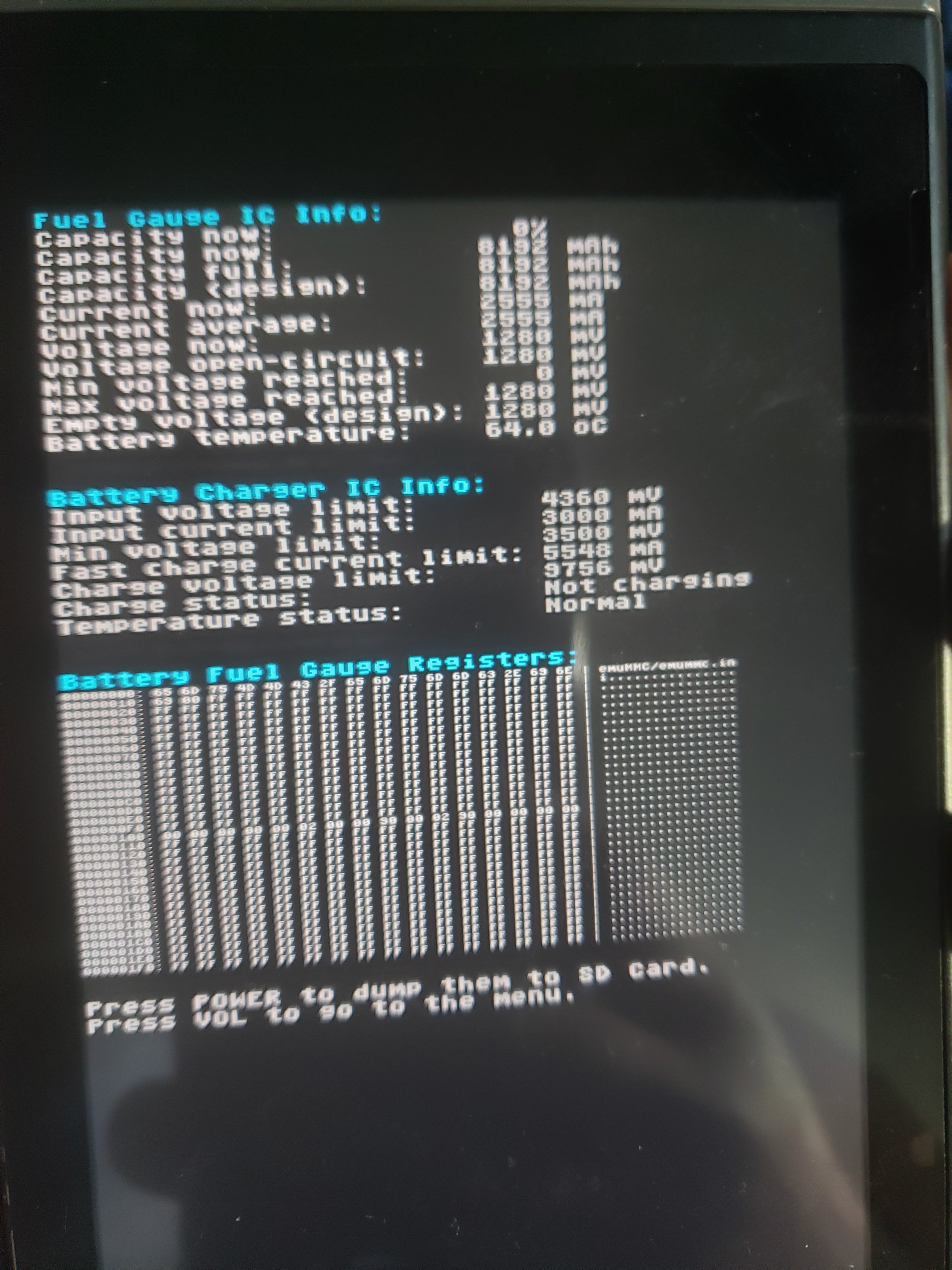

    All the chips seem to be working as they shld.I will try swapping the MAX chip from a donor

    The MAX chip was damaged from the alligator clips on my helping hand

    The one on my donor board is not better so I will have to order some. but I am confident replacing it would solve the issue.
