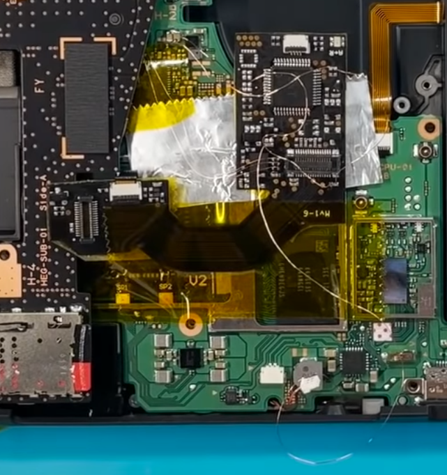

im not an expert sorry for asking but what actually causes the v2 switches to be hacked by the chip like what entry point is it abusing.
The chip glitches the BCT check in the Nvidia X1's bootrom. The SX Core/Lite/HWFly is written with a custom bct generated with the tools intended for the Nvidia Jetson devboard, which is directly injected to the nand, then rapidly drops and increases the voltage to the CPU just long enough so it skips over a branch but short enough that it doesn't crash the console. Nvidia has mitigations in other parts of the bootrom for this type of attack but forgot it in the most important part, which is the BCT check.
Yes from nand points to Lite Chip - QSB is just an easier way to install and arent 100% needed. Some did their lites like this when they didn't have the nand qsb or they damaged it.

So what instead of the ribbon a direct wire is used. Where does the wire come from is it custom for the switch or something and would someone have to manufacture them with the chips?. Sorry I have never heard of this method so it's new to me.
A regular plain wire gets soldered from the nand point to the Lite chip. Should be 4-7 points or something like that so that would mean 1 wire for each point. Basically the connection the QSB would normally make has to be done manually. Also, had forgotten, you need I believe 3.3v to power the chip so you would also need to find 3.3v on the OLED Mobo and solder that to the 3.3v on the SX Lite 3.3v pad.

Interesting, I wonder when people will figure out the solder points on the Nand.
Reactions: HollowGrams
Is the touchscreen Broken or is the problem software support. Did he use a core chip .
No really sure, looks like he had to modify it quite a bit from all the wires.
Hopefully a more professional solution is made.
