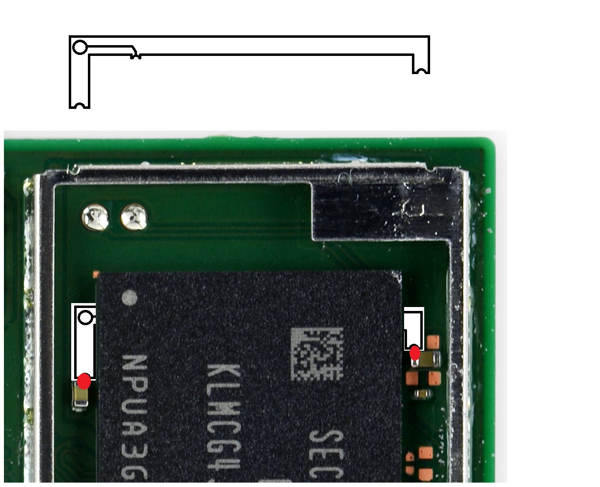

Good work on the adapter, it seems like the scene is using it as the defacto way to get to dat0.
I was wondering however, if you believe it can be optimised, to make it thinner, so it fits under the shield, so people don't have to rip it apart.
Another good addition would be "anchor" points, to fix it in place, instead of using solder mask.
I doodled something up in paint - let me know what you think:
This way you would first slide it under the shield, so it drops on the PCB and then you slide it under the eMMC with 1-2 tweezers.
The DAT0 point would peek out on the side.
Once you meassured the resistence against GND to check if it has a connection, you solder the adapter to the 2 caps / resistors on the side to keep it in place forever.
I had a similar thought. Only concern would be how accurately the placement of those caps reproduces.
Indeed we might have a misaligned anchor point, so we can always make the solder point on your "board" a bit bigger to accommodate for the misplacements of such anchor points.

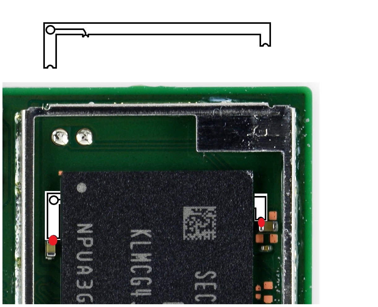

It’s intentionally generic. This is so it’s not specifically designed for the switch. Making it thinner is up to the fab you make it with. PCBWay’s thinnest option is 0.08mm which is limited to one layer. The thinnest option with 2 layers is 0.1mm which is what the current design is to help people who are a bit heat ignorant and just blast 400c.
In terms of size, you’d want to have sides that wrap around the bga tightly so there’s no room for error. With your sketch you have the room to be misaligned. Obviously your anchors help with this, but this goes back to my first point about being intentionally generic.
With thinner I meant making it smaller so it fits between the shield and eMMC, so peoppe don't have to rape the shield while installing it :D
But if you say it's a generic adapter, we have to design a Switch OLED specific one 🤔

'Rape' seems a little overstated, a small incision at the edge allows the overhanging part to be bent upwards and you can simply bend it back into place before you put the cover back on.
