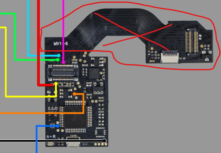

I was considering cutting the Core "excess". Like so:
What do you guys think?
Of course the chip would be ruined, but at least I think it'd fit better.
Cores are almost same size if not smaller footprint. Im sure you can fit either in there nice and snuggly. No need to cut the chip honestly. In fact cut the alumi heat plate to acommadate the Core.

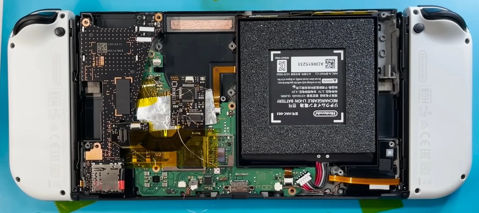

Someone posted this picture here in this thread some pages ago (I don't remember).
I'll try fitting the Cores like so.
I though about that but was not too sure if the wires in the top portion of the core are required to maintain connections
Reactions: mvmiranda
Right!
At least, if your OLED dies, god forbid :) or if, for whatever reason you need to removed the chip to use in a V1 or V2, you'd still have a working one.

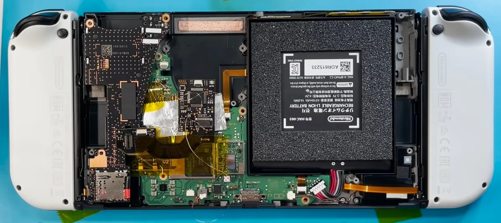

I finally did it guys...couldn't have done it with the help of @sthetix on Twitter. His diagrams and videos were great. I don't have the tools to properly reflow the eMMC so I bought the DAT0 adapter off PCBWay. Originally got the SX Core and realized it was too big, possible, but was too much of a headache...so I threw that SX Core in my original V1 Switch just for fun. Picked up a HWFLY Lite for this. Fits beautfully. Got the red light on boot many times, had to completely disassemble and check all points with a mulitimeter and reflow/rewire a few points. Definitely the most difficult, time consuming, and expensive mod I've ever done, but it was worth it...fun, educational, and hella stressful :D
Edit: If anyone in Canada needs the DAT0 adapter (only shipping within Canada, pay me via Paypal) then PM me. ;)
wow nice
Did you use a microscope?
Do you have much expereience with soldering/micro soldering before?
How hard was it to do the micro soldering?
I have soldering a few things here and there, no real experience with micro solder though.

No microscope. Not much soldering experience, last time I solder this much was a PS2 modchip, lol...feels like 20 years ago. Huge wires and giant solder points.
I have good eyes and a steady hand. I bought a SMT soldering learning kit to learn microsoldeing. Was about $25, sooo worth it.
I just used my eyes to quicky tap each solder point after tinning and fluxing both ends to be soldered. I inspected with a small magnifying glass with LED. For points A and D cpu connector cable I used a head visor, pic attached.
