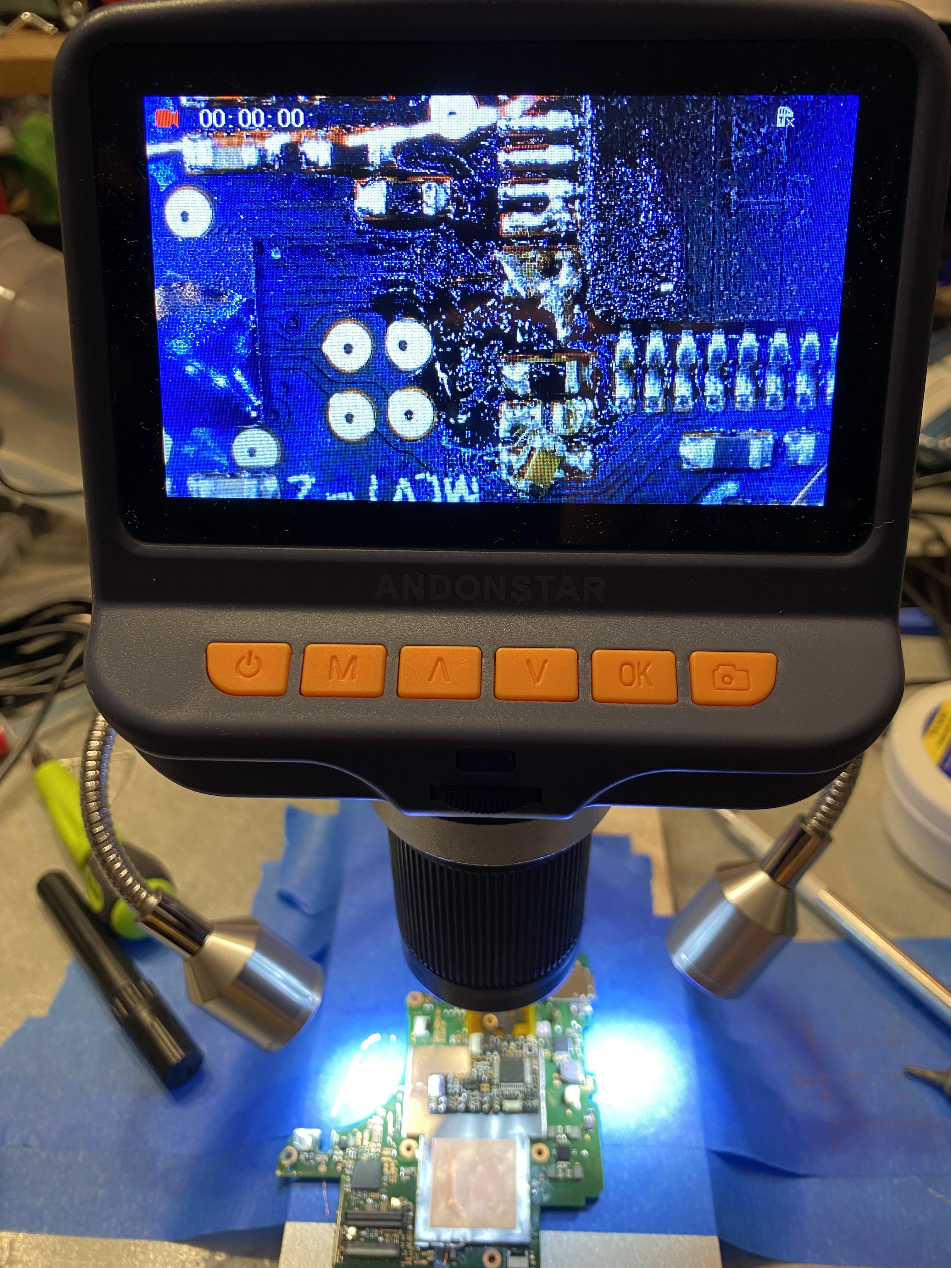

Yeah a microscope is recommended. You should have seen the balls on the emmc chip they look like tiny pin holes.
wow, everything looks so big in the video.

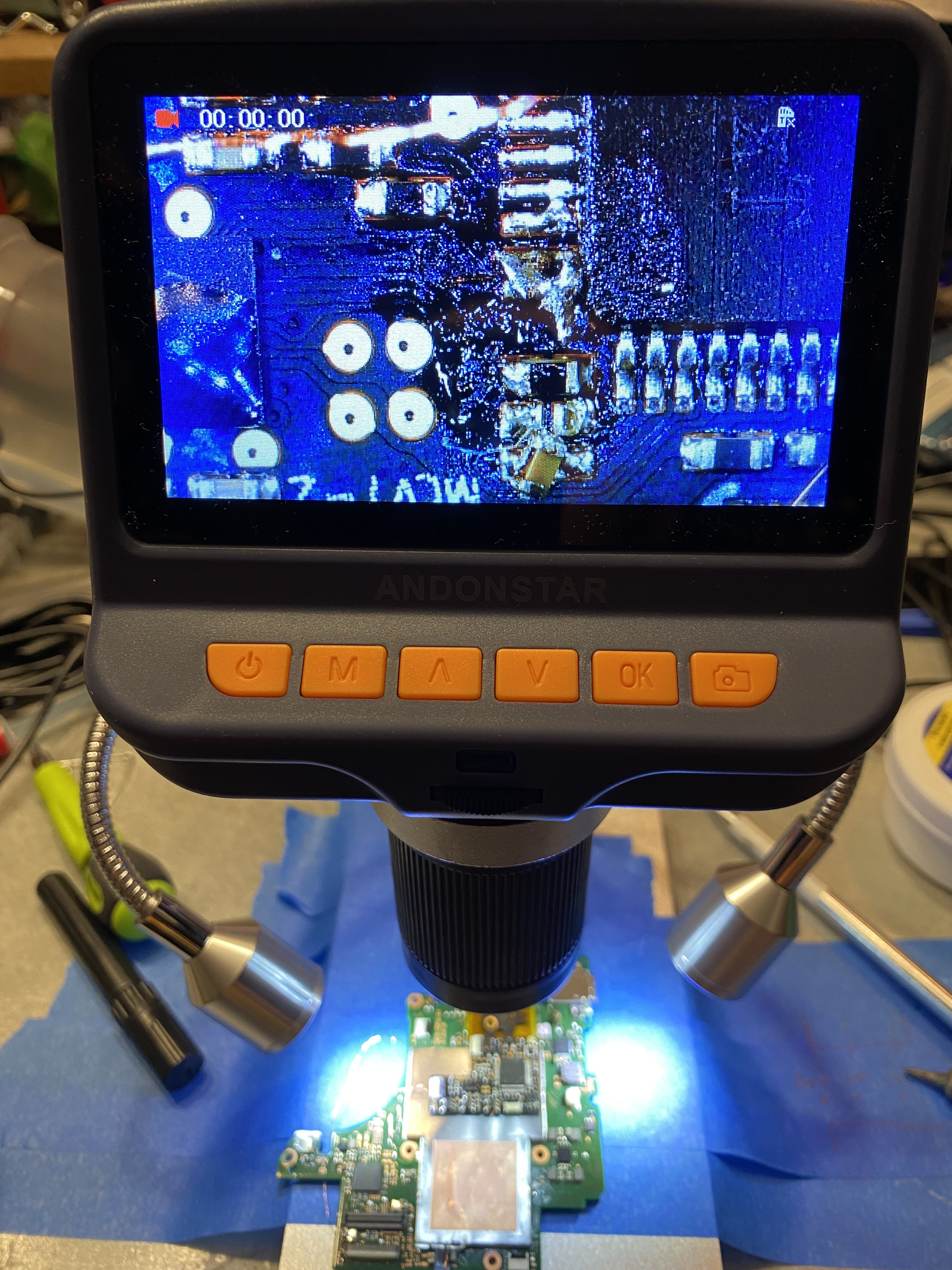

What kind of microscope do you recommend.

I'm pretty happy with this from Amazon (Germany)
I cut the 2 silver clams, to keep the motherboard plain. The stand is from my point of view a must to get clear picture.

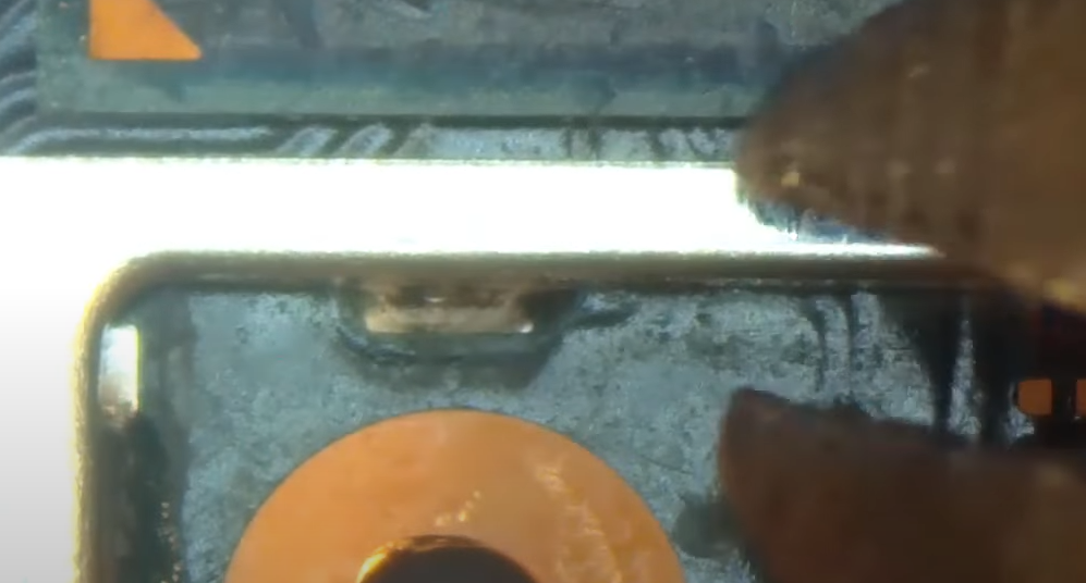

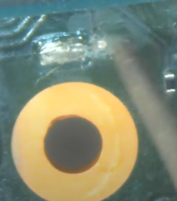

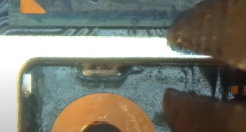

How did you scrape away that one solder point after you cut the metal frame? (See pics below)
I dont have a grinder pen

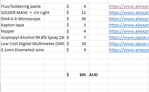

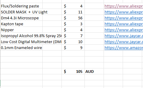

This is my cost for the materials for soldering:
Dont think i'll do any more soldering after this as well.
Pretty sure the chip is Fubar at this point. I'm not skilled enough to remove the solder bridging the three legs and I have no idea where the SMD popped off from.
For the grinding spot, I used a Dremel with a tiny grinder tip on the lowest speed setting and it worked fine. The solder point is TINY. Definitely need the Solder Mask on that point afterwards.

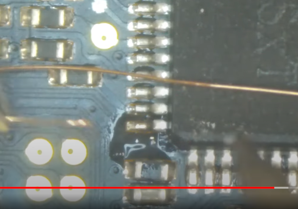

This is how the chip suppose to look, you could try solder wick to mop up the solder from the legs, the only problem will be locating the resister.

OOOH! I will try to salvage it. Doesn't hurt to try. Here's a closer look at the damage:
Blue Square - Where the tip landed. The corner of the black chip is a little discoloured. Is this a problem?
Red Square - Looks like the leg bent sideways. Is it a problem to straighten once the bridge is removed with Solder Wick?
Yellow Square - Looks like a leg is missing? Or bent into the solder glob....not sure this is fixable....
Green Square - Is this where the capacitor goes? Does the orientation matter? If the capacitor has prolonged exposure to the tip, would that ruin it? I had to scrape the capacitor off the broken tip of the soldering iron.

OOOh…. How does one remove the solder bridge. And where does that capacitor go?
You can use a solder pump, solder wick (also called solder braid) or even your soldering iron.
Use a good flux, put a small amount of solder in the tip, clean it off (you don't want to apply more solder, just make the tip ready to "suck" the solder excess) and quickly touch the bridged areas and pull the tip towards the "end" of the pins, almost as if you're sweeping the iron. DO it quickly, do not sit the iron to "melt" the tin.
Touch, Sweep and remove. In one movement.
The flux will help evenly spread the heat and the melted tin will be "sucked" by the iron tip. The surface tension of the melted tin will "pull" (or suck) the bridges out of the board to the iron tip.
Sounds too much but it's actually quite easy!
As for the capacitor, @grubgrub already posted a picture of what the areas should look like. It's like this:1637772372498.png
