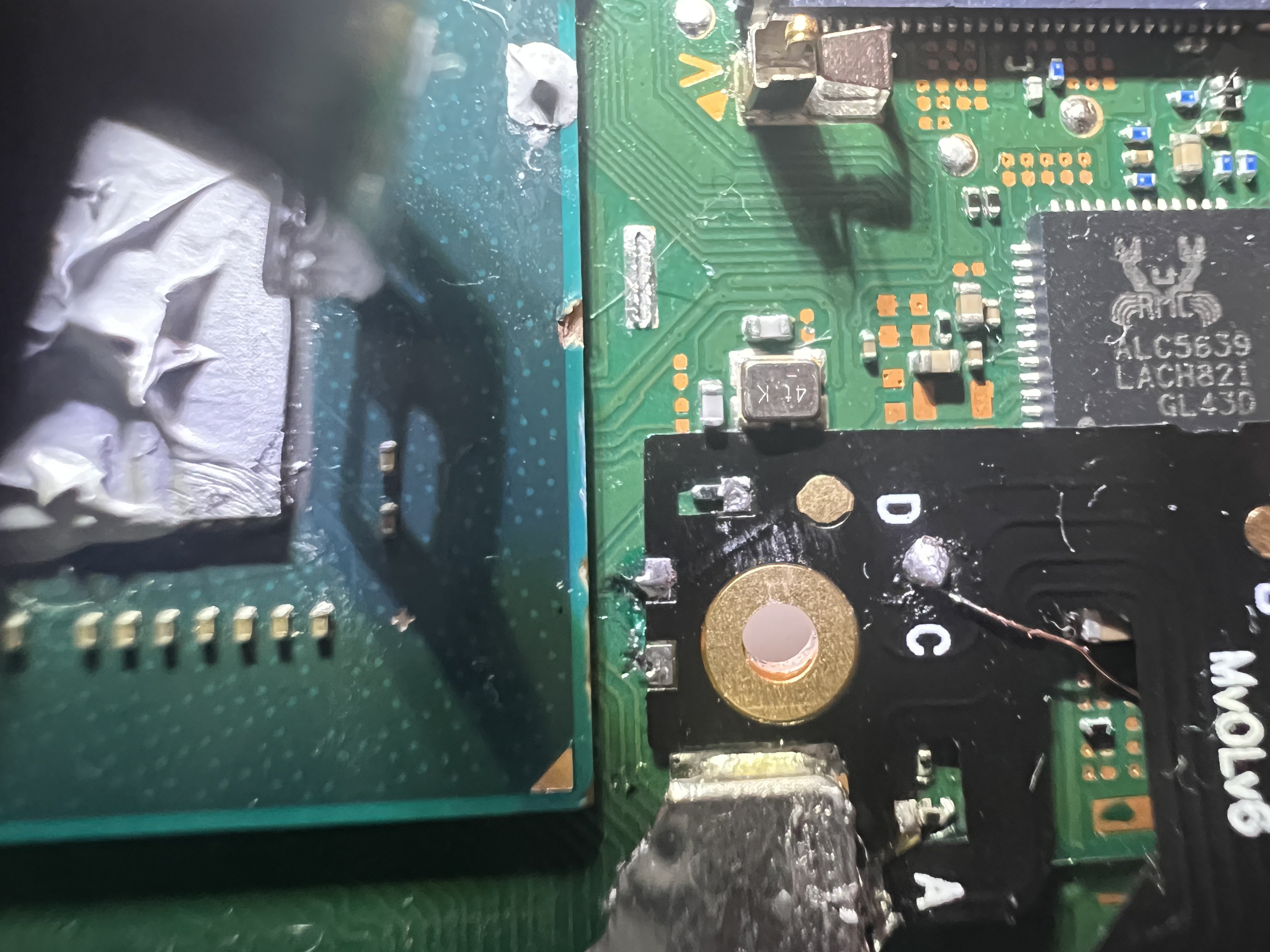

Hello People , i tried to Mod my Switch Oled , semi successfully but it just wont boot anymore and wont go Past the Nintendo Logo. i noticed after taking it apart (and trying for a Dat0 Adapter that i failed so i just did the Kamikaze method instead), that the console didnt boot past Nintendo Logo and showing me Low Battery icon right after. i thought maybe after all is done it may work again so i kept going with the Picofly. Even after finishing everything and getting the Golden " No SD CARD" i just wont boot to anything . i prepared a working Sd card with hekate (even tried the full HATS zip ) i wont boot into hekate. as soon as it detects the payload its will just show me Black screen. tried just putting in a empty sd card and the picofly would say "no Payload detected". what could have gone wrong here ?? i was thinking about reflowing the emmc but i dont know if that even would make a difference or if my problems even have anything to do with that? Also tried charging it the night but no difference , i even tried it with a known working full battery , still the same .

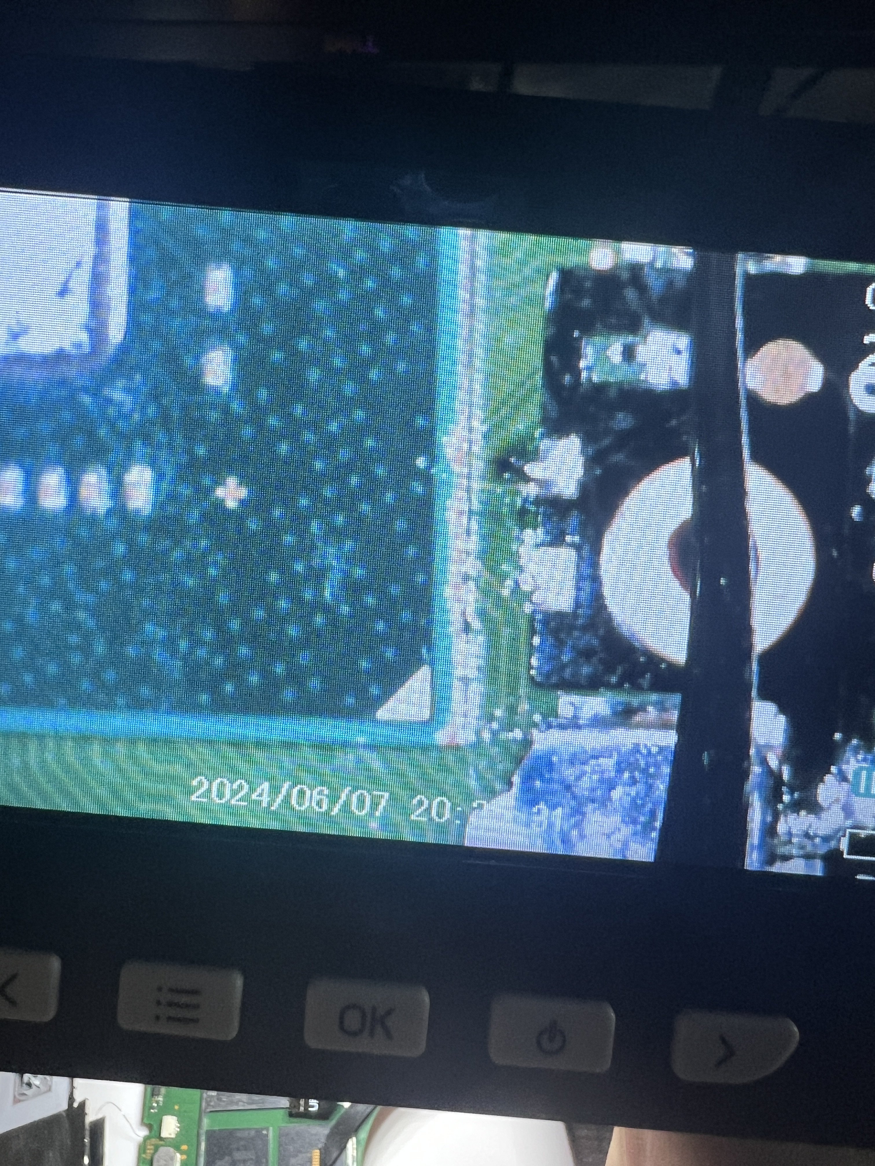

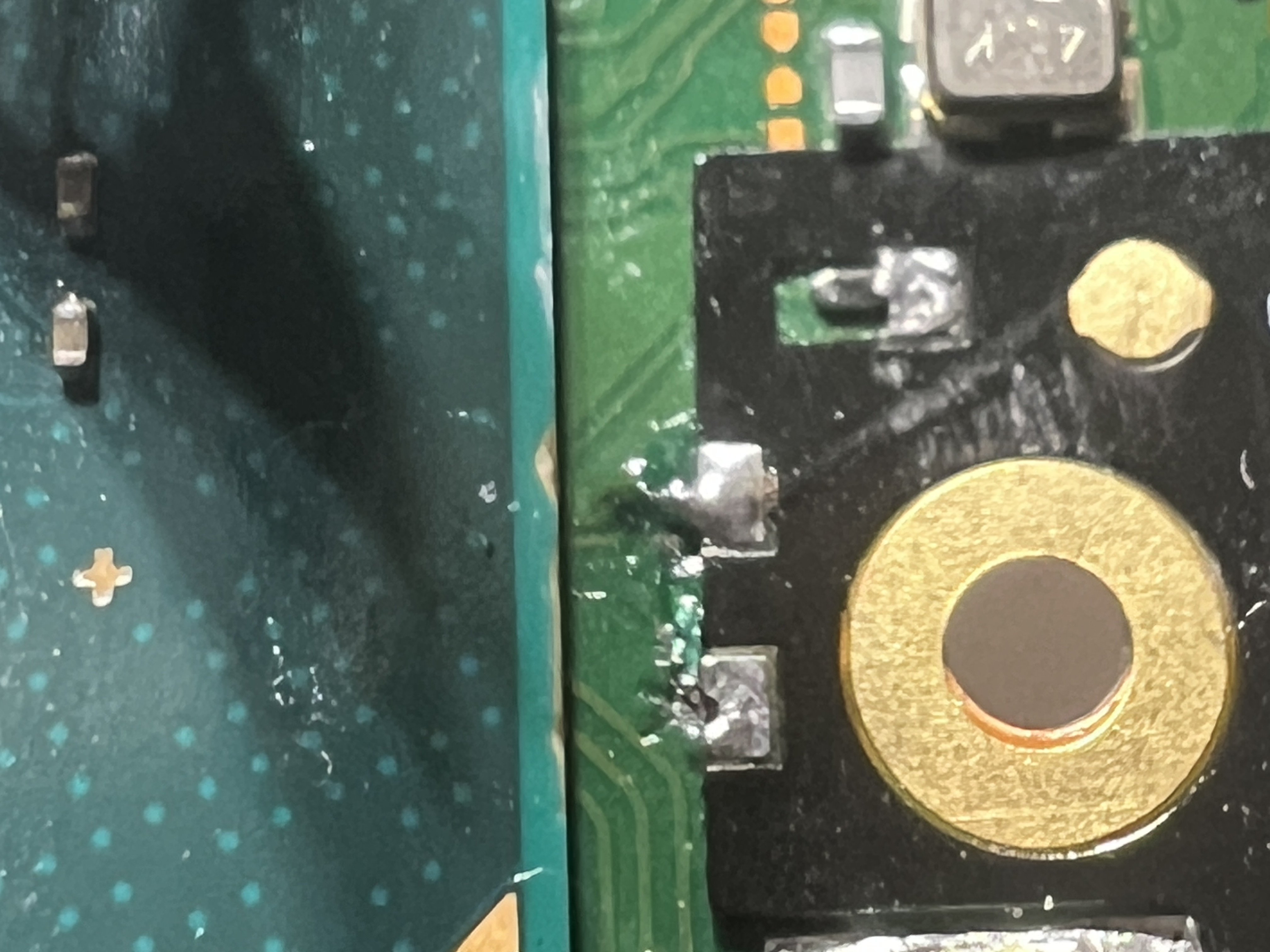

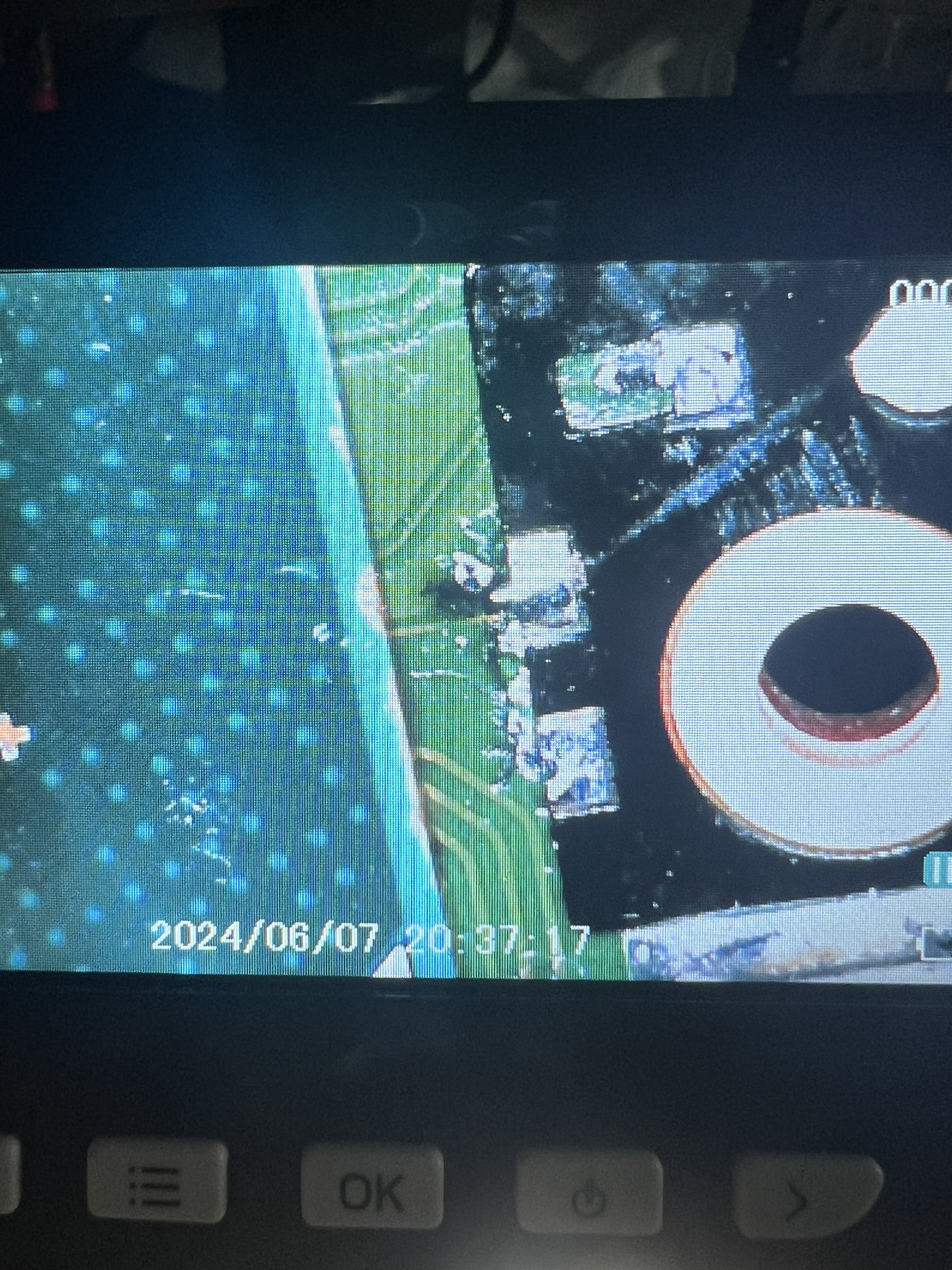

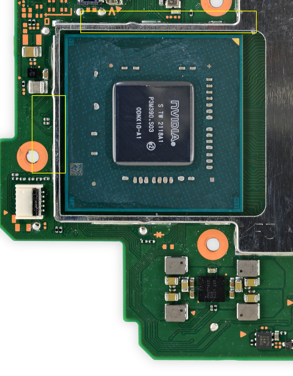

SHOW the cpu area around by removing the metal sheild, you might have cut trace around the clk point(like yellow mark arae in picture)

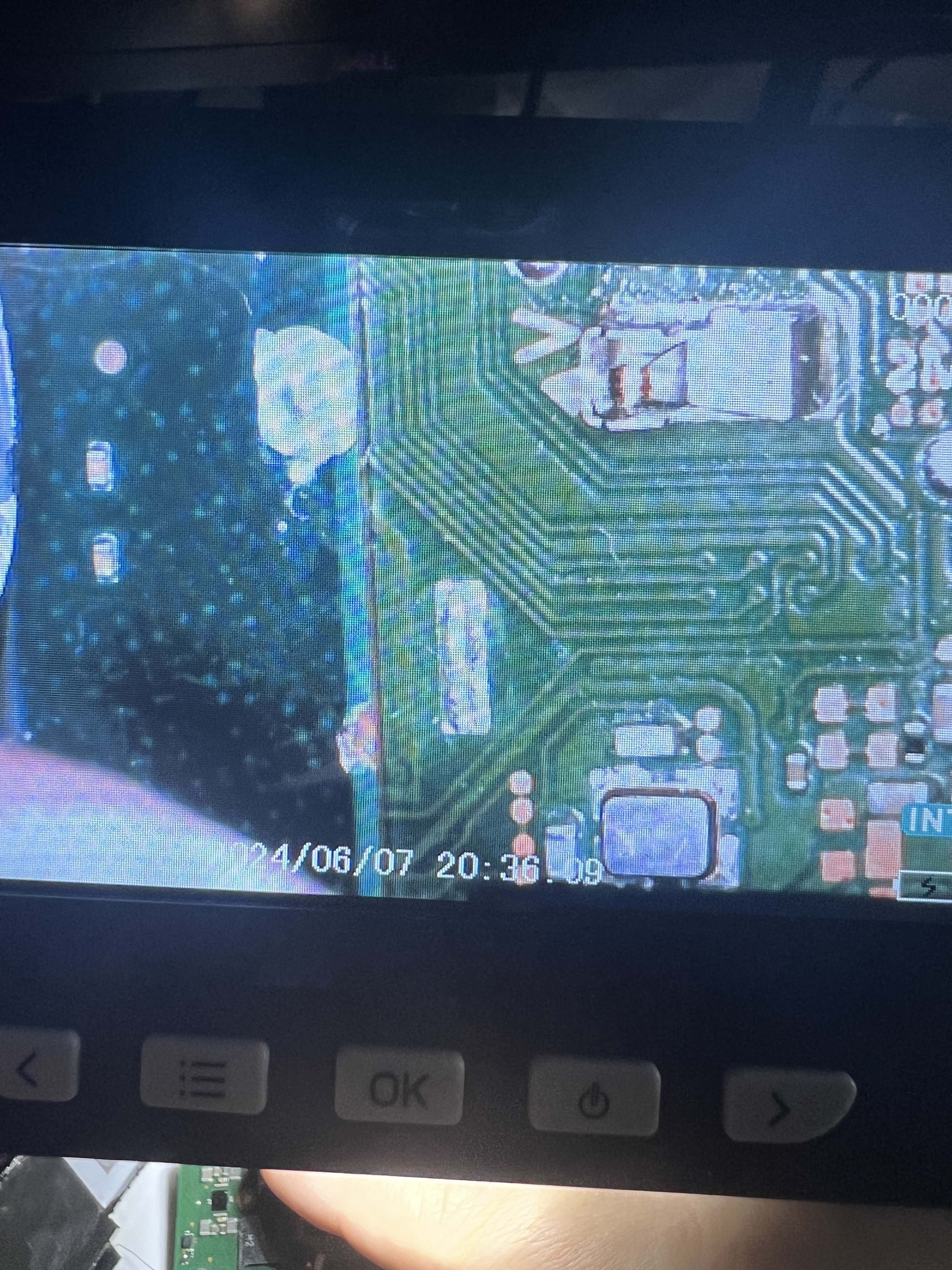

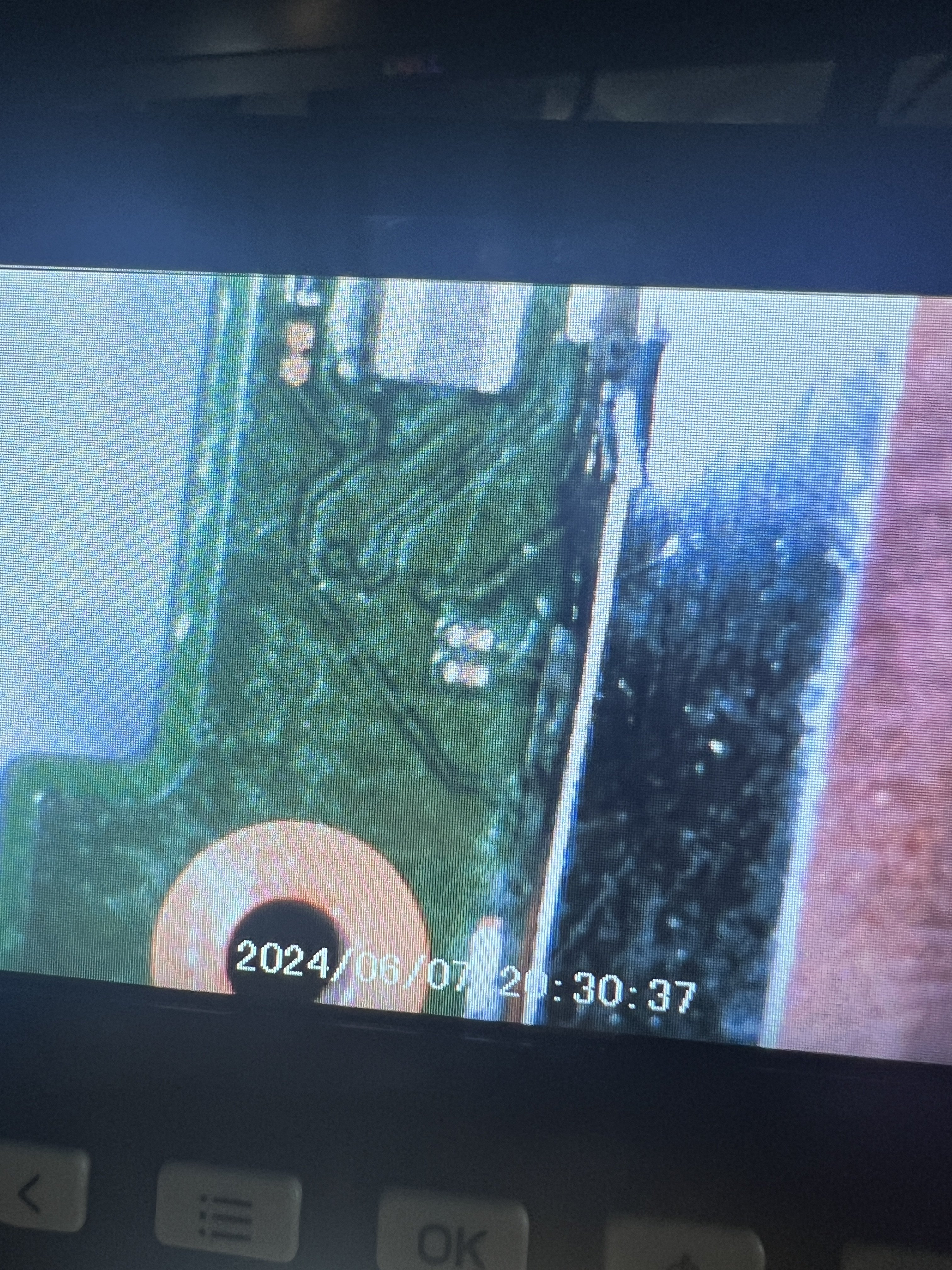

found the culprit i think , is that enough to kill it ?

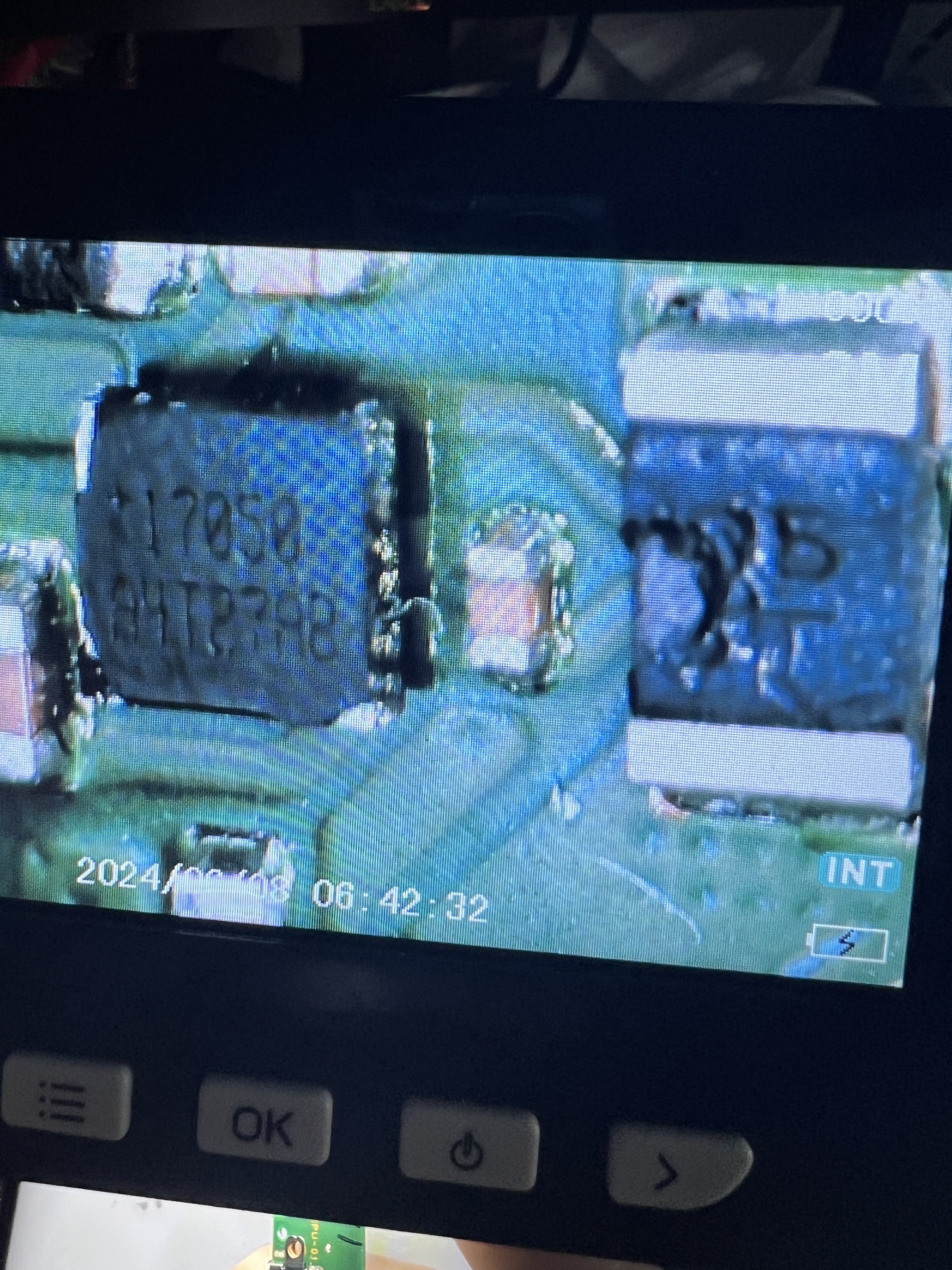

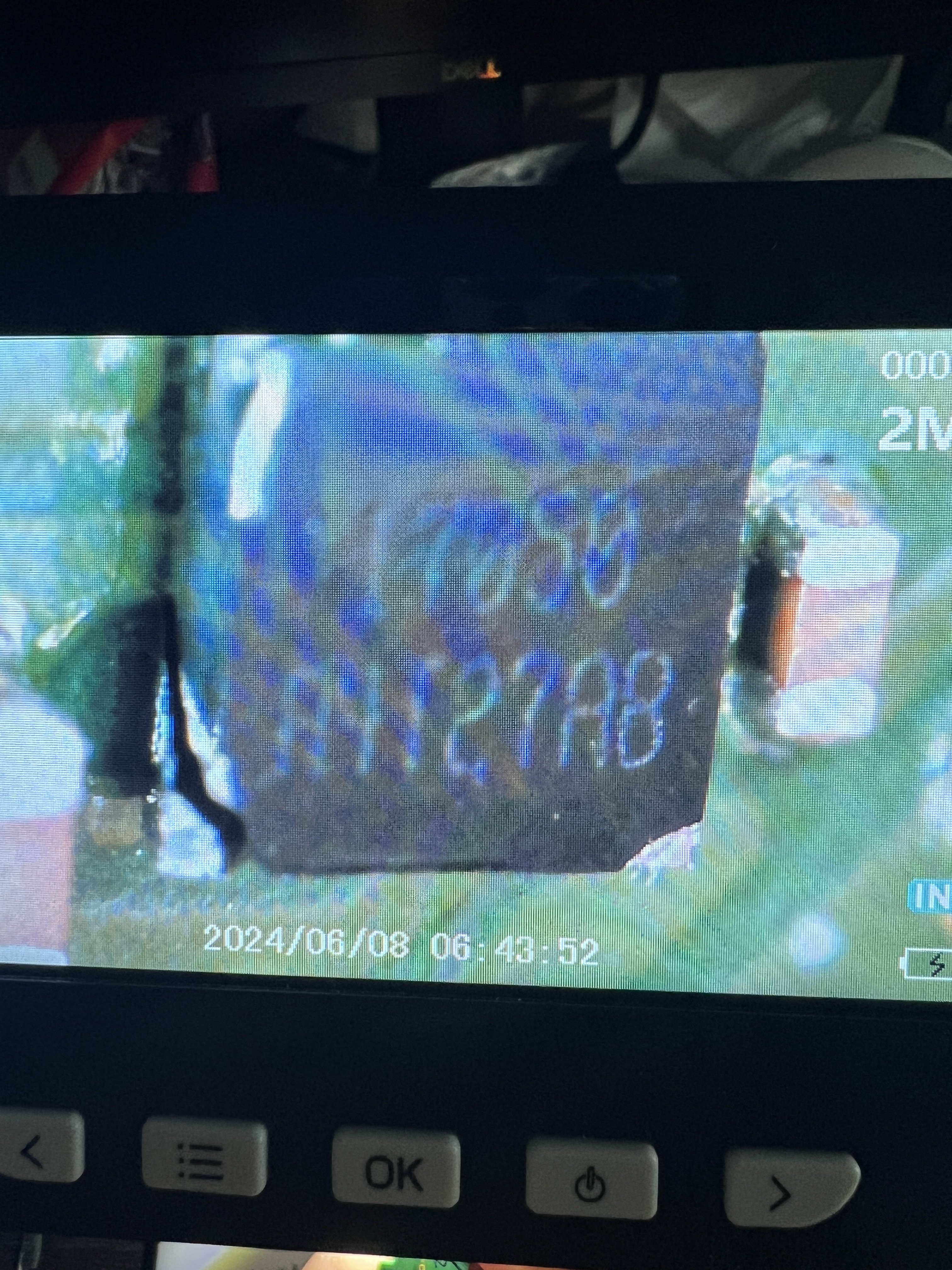

clearly fuel gauge max17050 broken and those 2 missing cap on CPU left would lead to no wifi or hang on 2nd boot logo in the future.

Sorry for the bad quality pictures but if u refering to the two caps on the Picture img_2552 they are infact doing good and chillin just were they suppose to :D cause of the bad quality they look missing. I already ordered a new 17050 chip. do you think the smd on the right with the 05 on it needs a replace ? also any tips on how to get the old one of the board without destroying the surrounding ? i have a heatgun suppose to have a 300 celcius mode and a 500 celcius mode, i bought a v1 board just to have some stuff that i could use and i noticed they use the same fuel gauge ic , but i butchered the chip because it wouldnt come off even with 500 celcius , probably also killed it anyway cause of the heat itself,
the 05 mohm resistor should be fine just top coating broken. Fuel gauge is BGA-9 type but should not take that much heat to take off (usually around 360C with little flux ). I guess it would be recommend to get help from phone repair shop or find someone more exp on hot air station BGA/microsoldering in order to minimize further damage on this OLED board.

still only nintendo Logo i guess the fuel gauge ic was partially working and now that i removed it , it only boots off usb cable but wont boot with battery only , since it doesnt detect a battery anymore .
got the chip today but to my bad luck that one small smd between the 05 ohm and the bga chip flew away when i was reflowing the bga chip :(:((( you know what kind of smd that is ?
