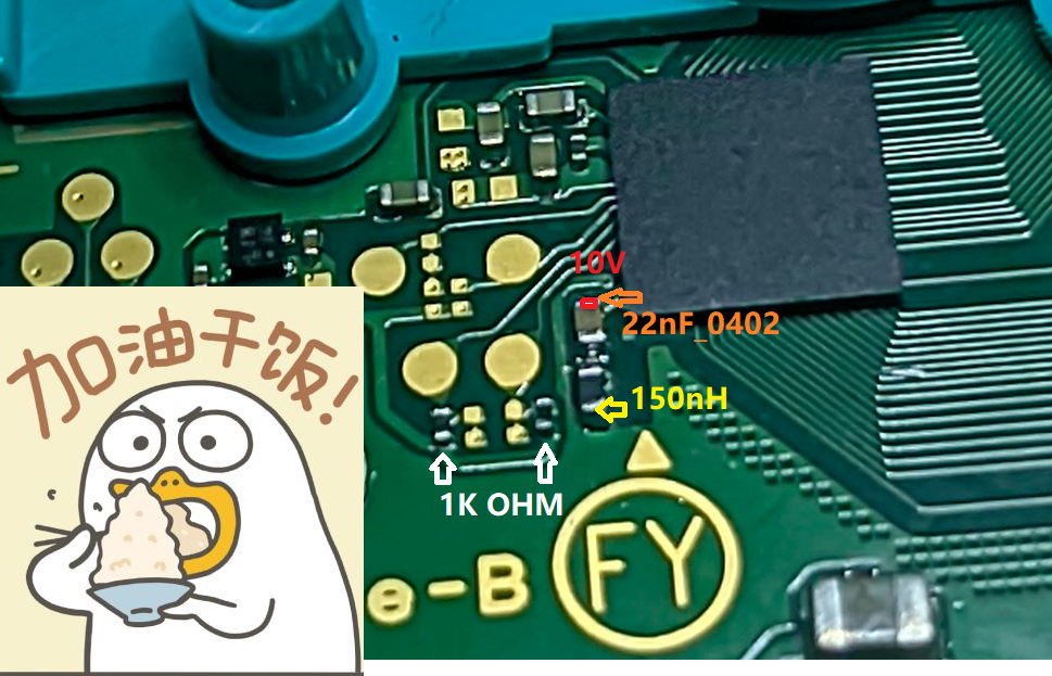

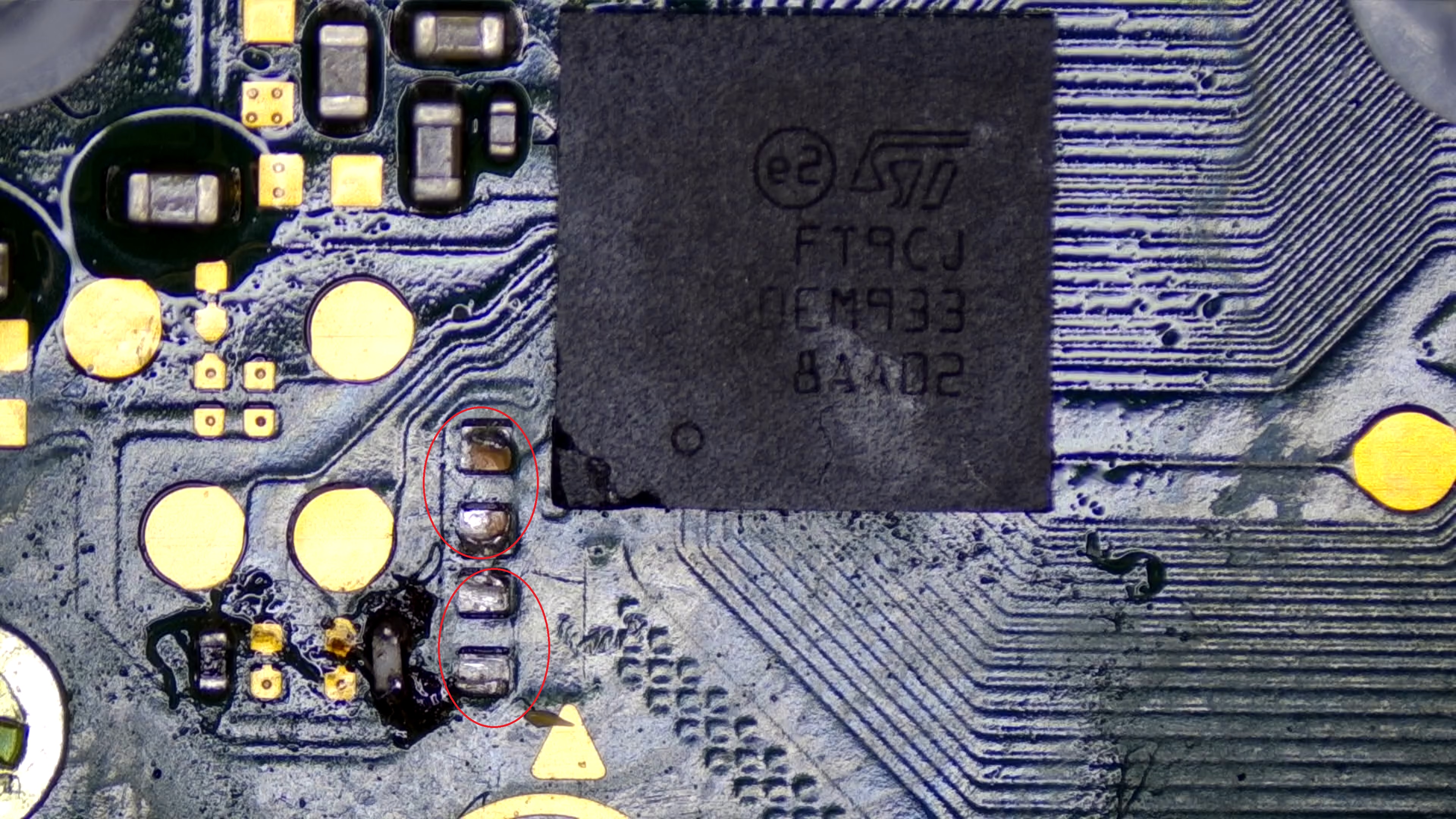

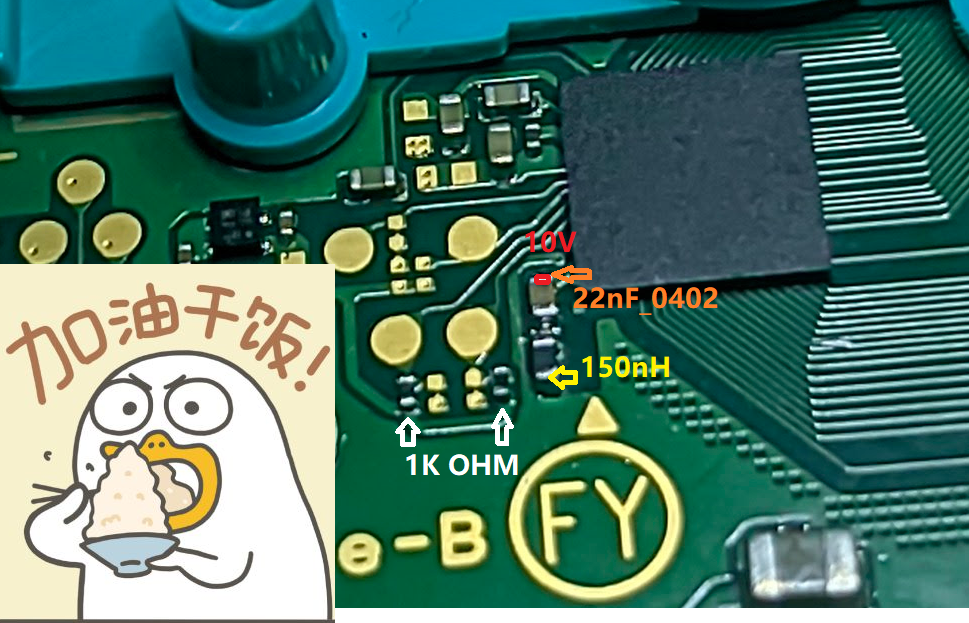

I have a Switch Lite with a lost resistor next to the FT9CJ touchscreen control chip after sx lite installation.
Could anyone tell me the right resistor to buy. I understand that it is a 0201 resistor, but don't know the value.
Thanks a lot
And I have another question about caps.
Do you know which type of caps are these two?
Thank you very much.

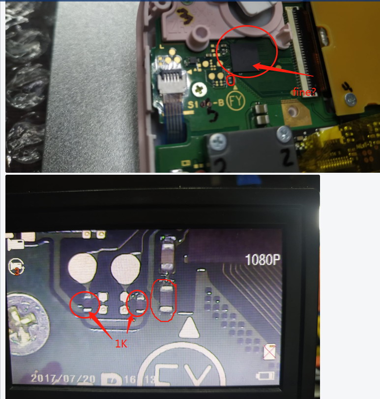

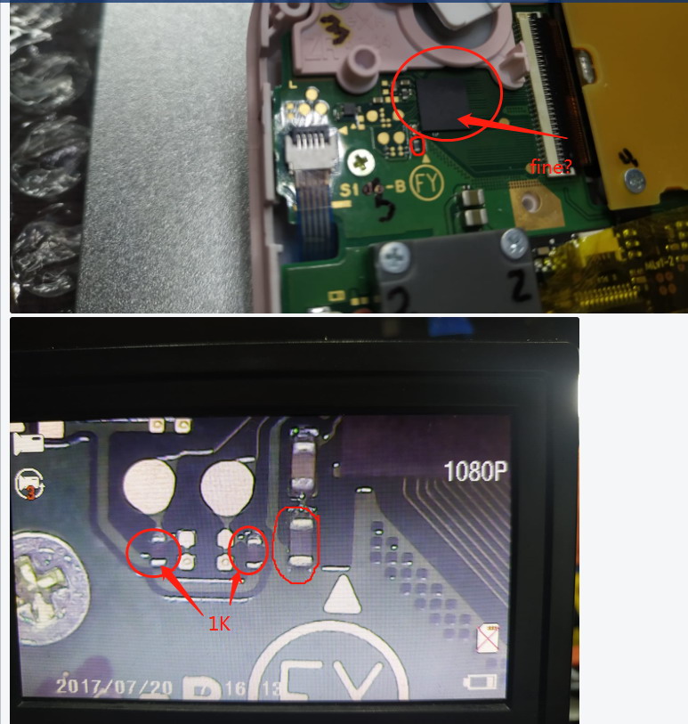

If the touch fails, you can look at the two 1K resistors. If it is normal, it may be a problem with the touch chip and you can try to reball.
Can anyone tell me the value of this resistor? The larger one next to the FT9CJ chip (circled in red)
