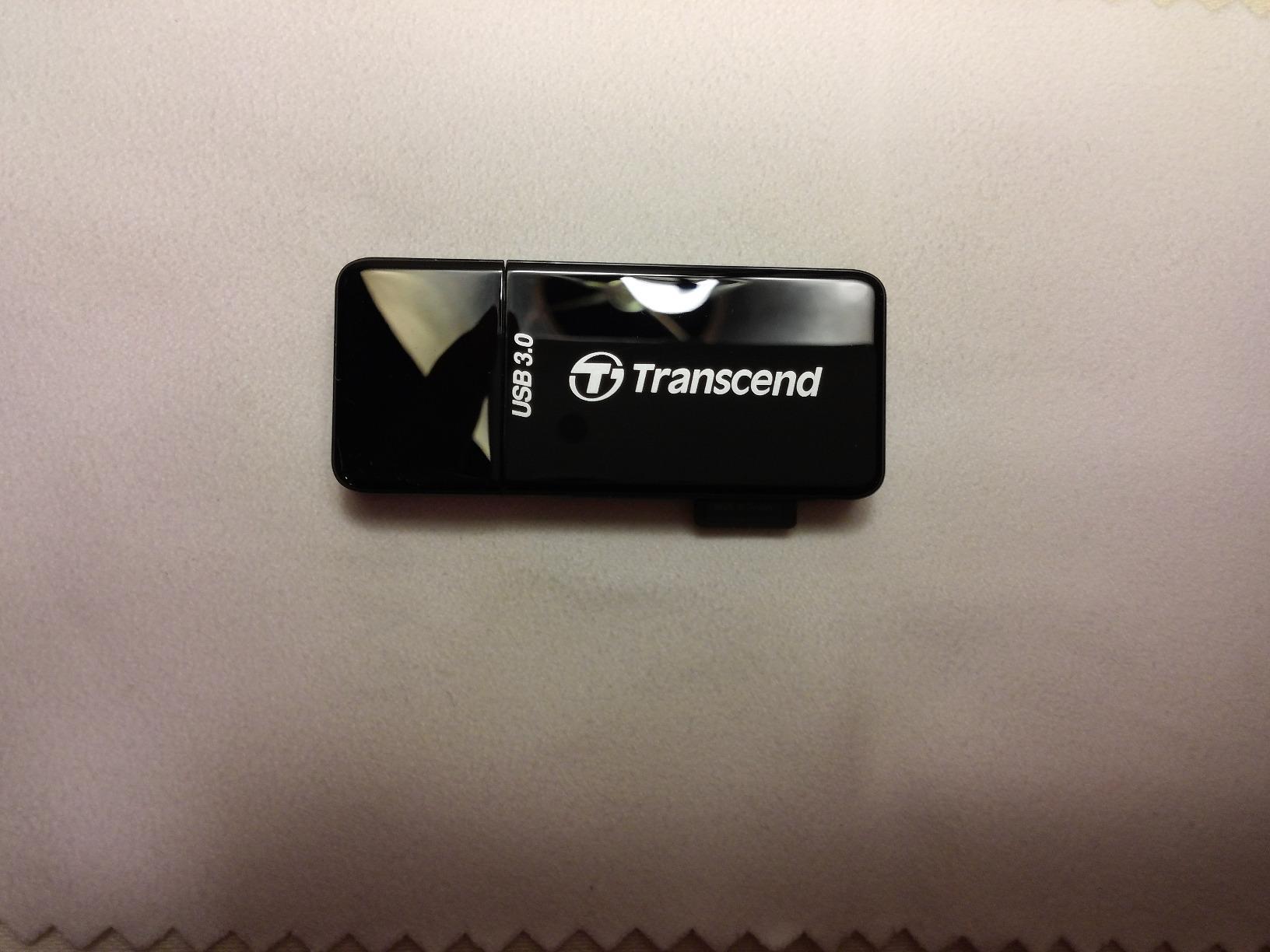

But apparently the transfer itself didn't quite work. If none of your devices has an sd card reader, then buy yourself on for around 8 dollars or your regional equivalent.
That way you would have way more control, as you could format the sd card probably with your OS.

The devices will do just fine for that. You can see that by looking at the posted user photos. You have one where an sd card adapter is used an another where the micro SD is inserted directly.
