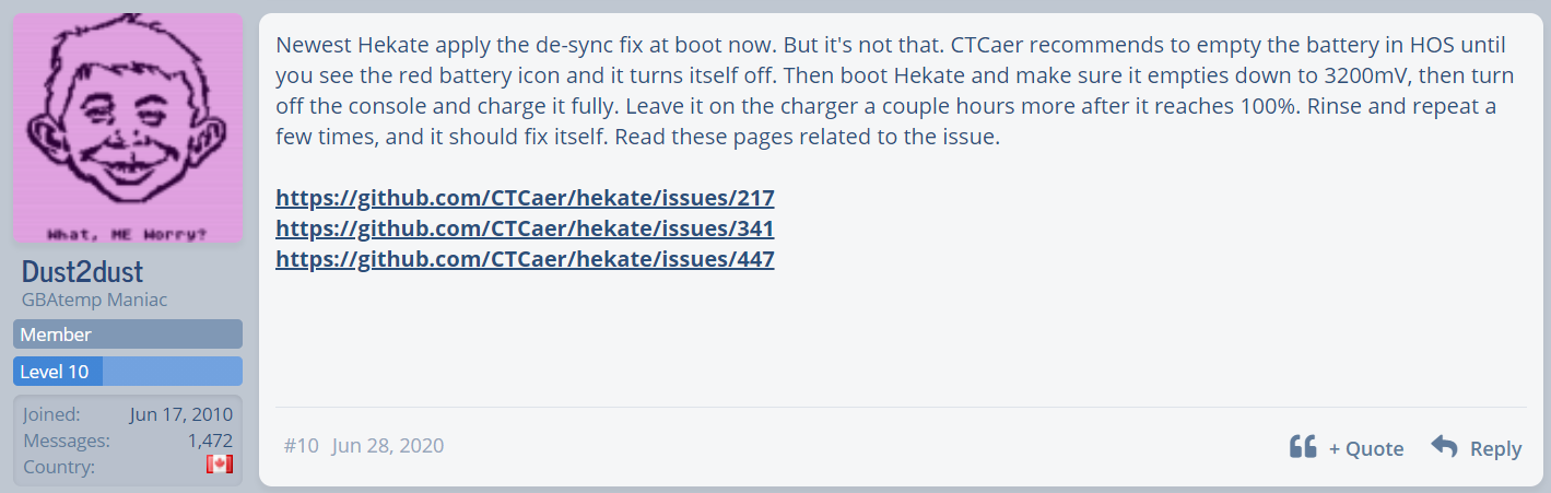

I have seen some other suggestions (such as the attached image), but I'm still unsure of the exact process I should be following.
This is what I have tried:
  1. Leave Switch on home screen until black screen shows up with red battery saying charge needed
  2. Hold power button for 25 seconds (to power off)
  3. Charge until 100% (checking by injecting hekate payload)
  4. Once at 100% I launch the fusee-primary.bin using hekate
  5. Repeat the process
I have done this twice and it still drains fast and stays at 1%. I also unplugged the battery (and re-plugged it).
Any suggestions?
