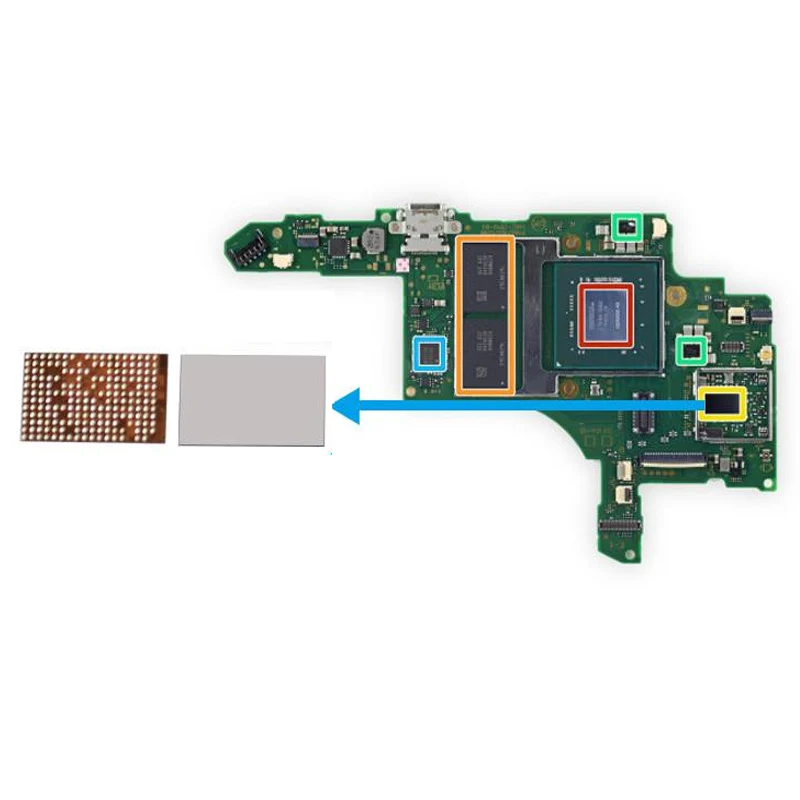

I took my new v2 switch to some guy to install a Picofly in it & when I received it back from him BT & WIFI don't work & he is unable to fix it for a week , any idea what could be the problem so I can tell him. Thanks
BCM4356 chip or the antenna are probably your culprit.
There are two capacitors next to the APU shield that if knocked off will also cause this problem. Many, including myself have knocked these off while attempting to remove the shield.
