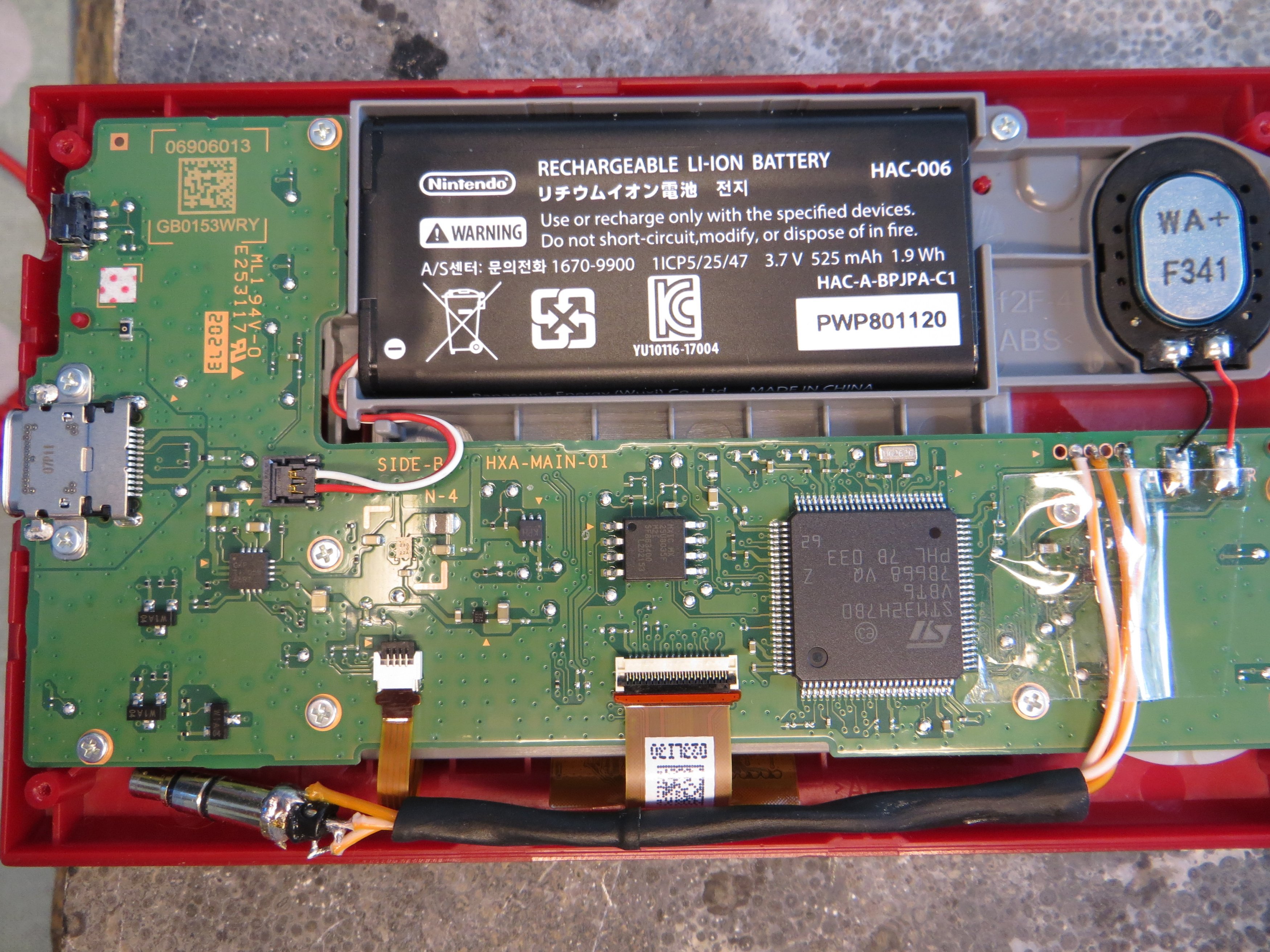

Getting ready to dump & flash...
Seemed smart to solder some wires for dumping and flashing (and reflashing etc). Needed some kind of reusable connection and chose mini-jack (salvaged the male from a monster-cord and a female from an old phone).
Got me a 10€ soldering iron and gave it a shot:
Hope it works (it should)...
