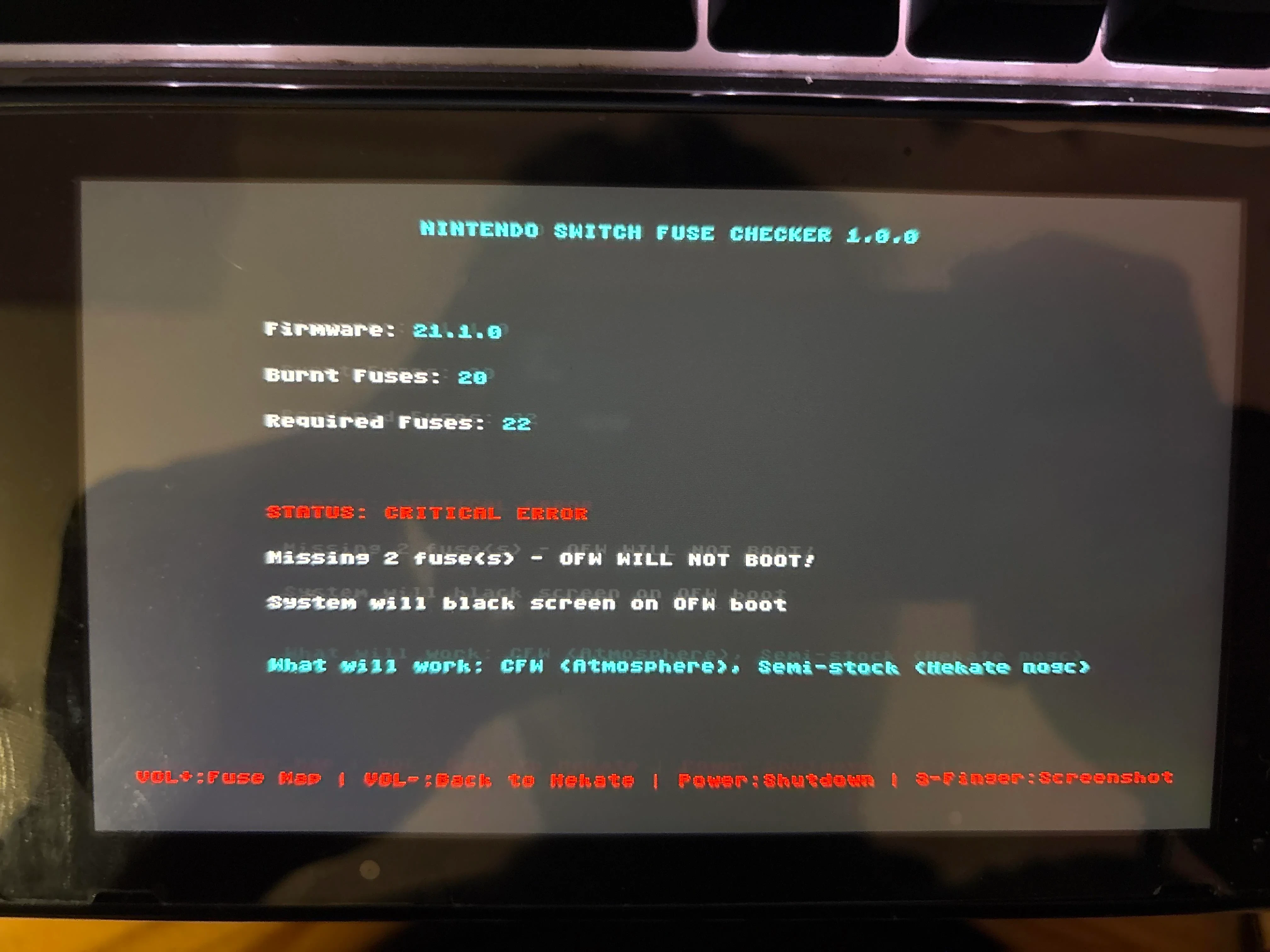

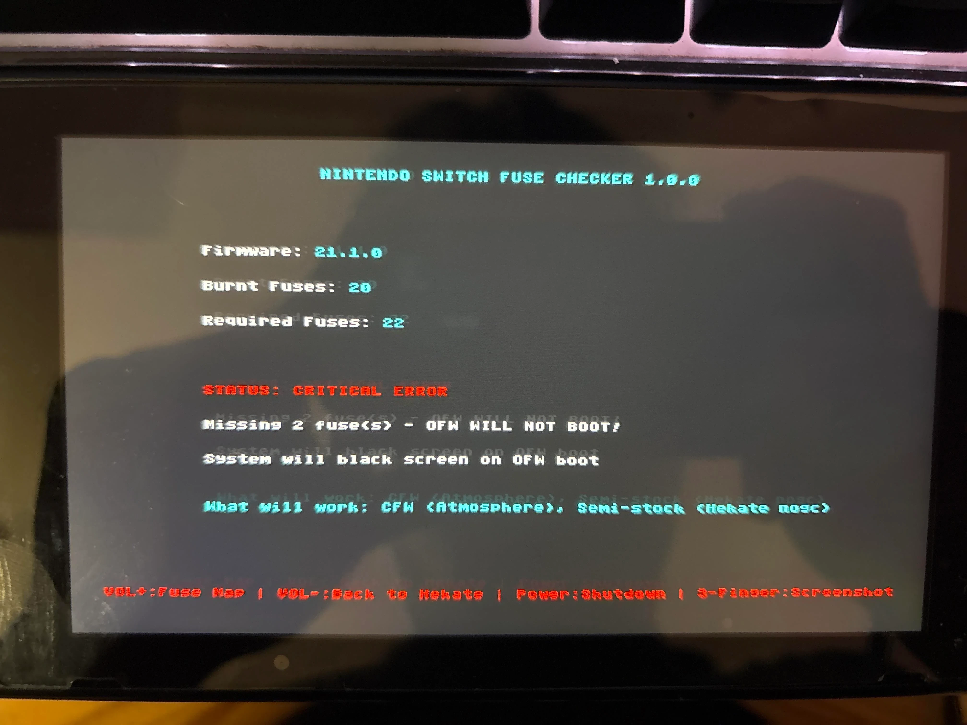

Yeah. And this tool will show you blatantly wrong BS like this. How do you guys think this is OK? Lmao.
(Not my pic.)
Well the info is correct, the expected fuse count is 22, while the burnt one is 20, so if on firmware 21.1.0 boot into ofw, fuse get burnt. You can be on higher firmware and lower fuse count if used correctly with autoRCM.
It clearly says "Missing 2 fuses. OFW will not boot. System will black screen on OFW boot." Which is wrong. Blatantly. Plain and simple. If you boot OFW it'll simply burn those fuses. It also has "STATUS: CRITICAL ERROR" there like something is wrong with your console. There isn't. He just doesn't know how the fuses work. Stop defending this crap.
I do agree with you that that is an error, if you read what I wrote I did said fuse get burnt.
