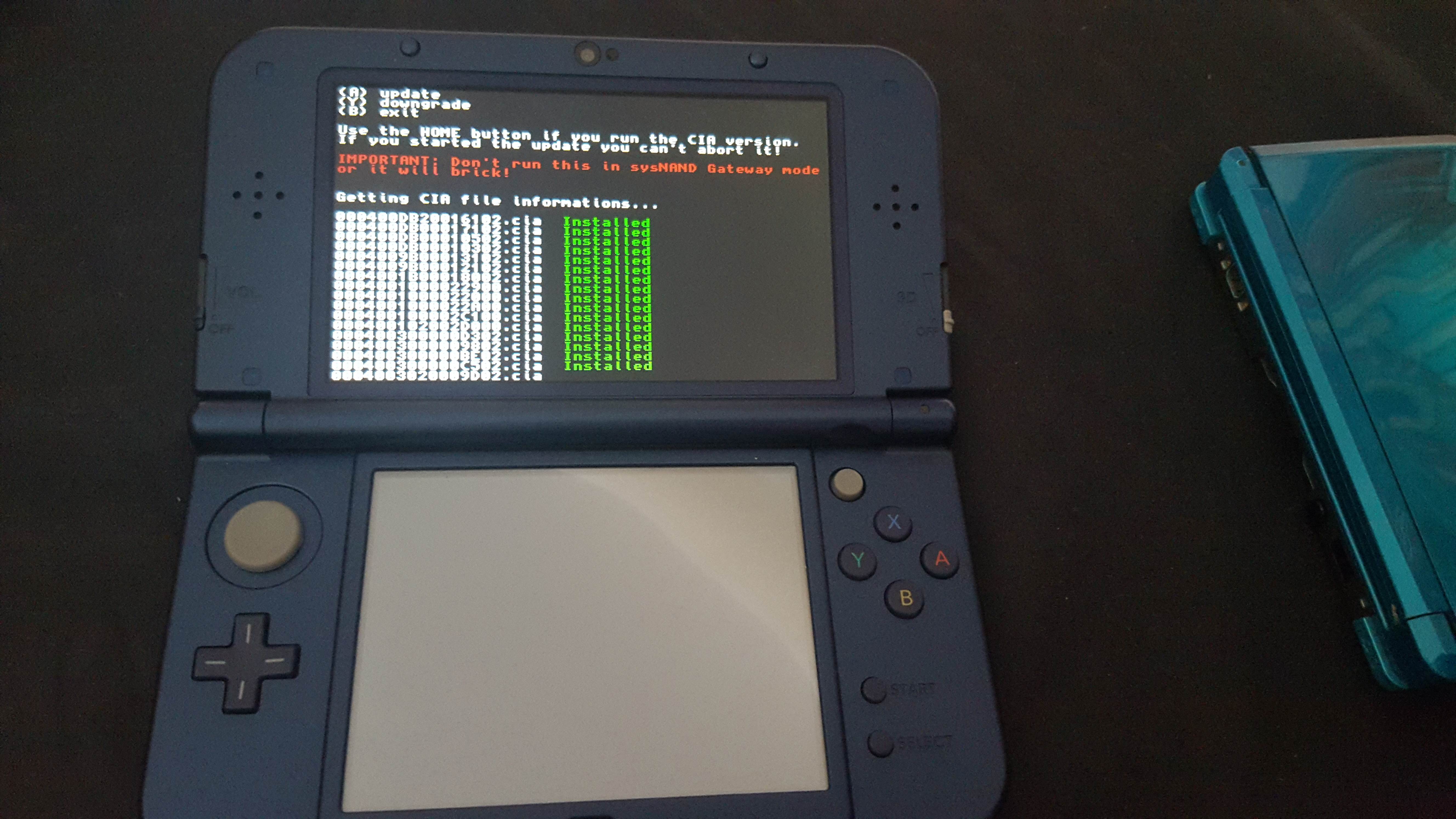

YAY! Got it, to the CIA Files info. after trying about 27x

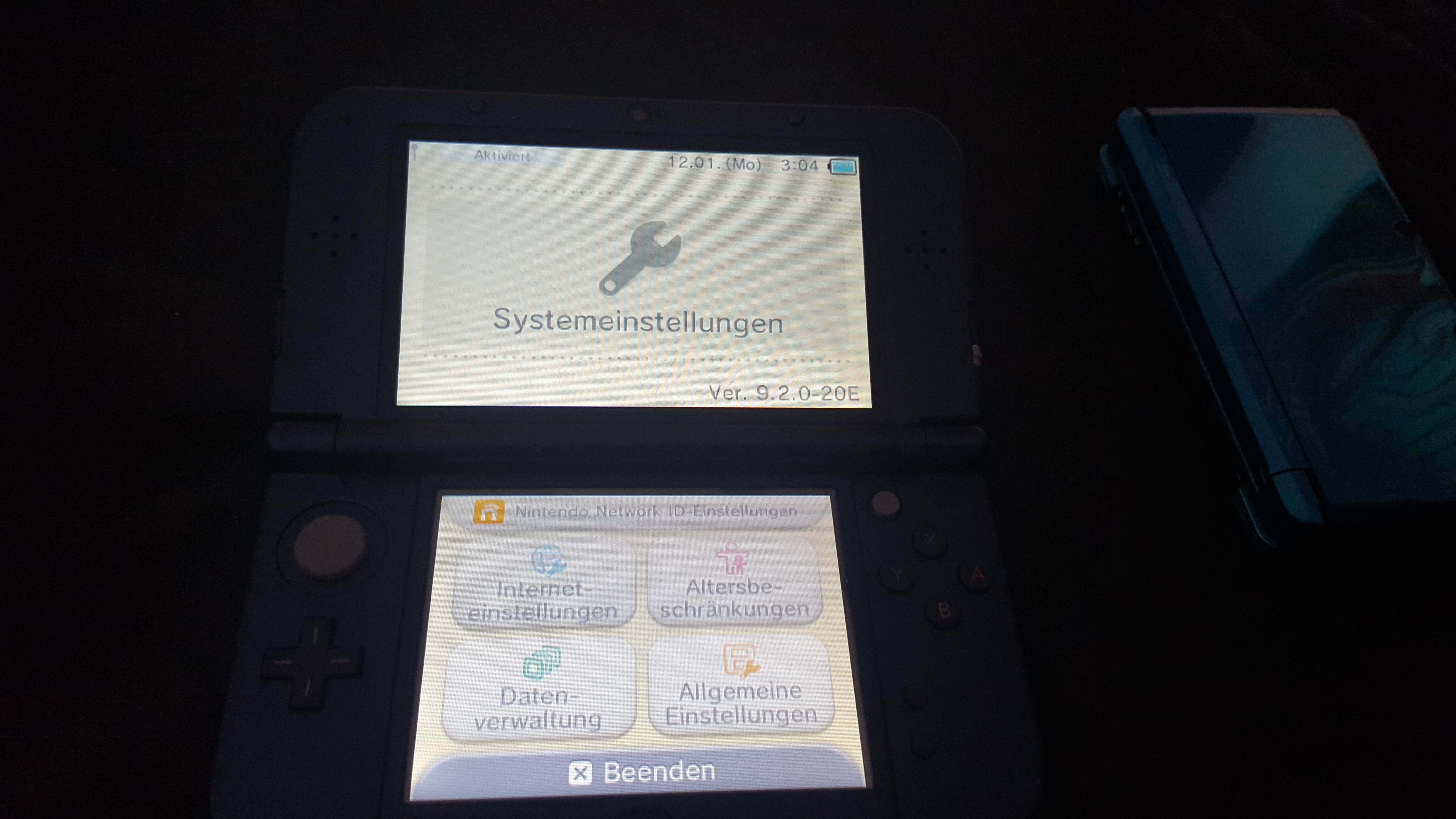

So my first try ended in:
Failed to get CIA file info
it's safe to manually reboot here and try again right?
