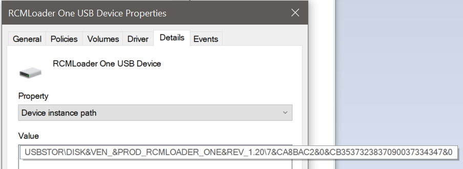

There is a way, when you connect the dongle to computer using micro USB cable on the windows device manager you can see:
the devices:
The name of the USB Mass Storage Device is a clue, RCMLoader One is the plastic transparent one, RCM Loader ONE Plus is the white cardboard one (and the Chinese clone)
and on the details of driver, on the Device path you can see the firmware version of the RCM Injector
the devices:
Oh man that's amazing info to have, thank you for this.
I should be able to properly update the RCMLoader firmware now once I get home in the afternoon :D
