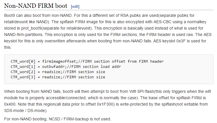

I've seen this on 3DBrew:
The 3DS can boot from something that's not the 3DS NAND? Can someone explain me it?
Thank you.
