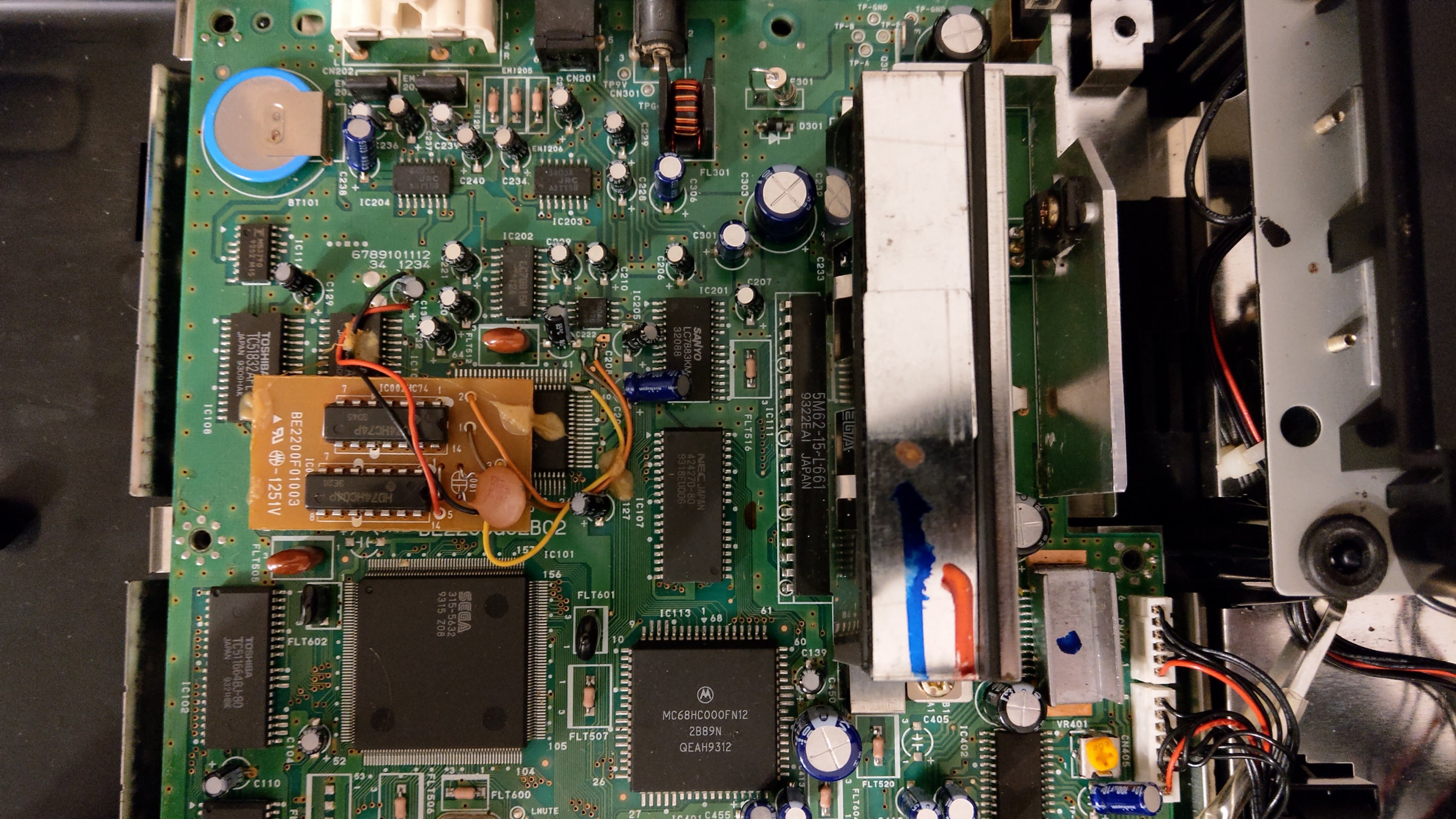

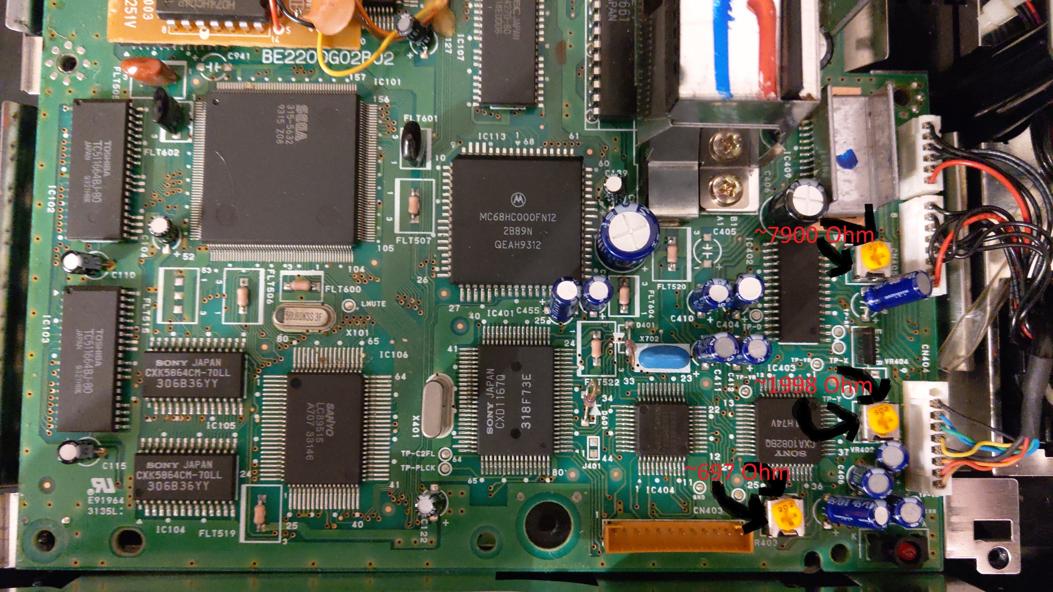

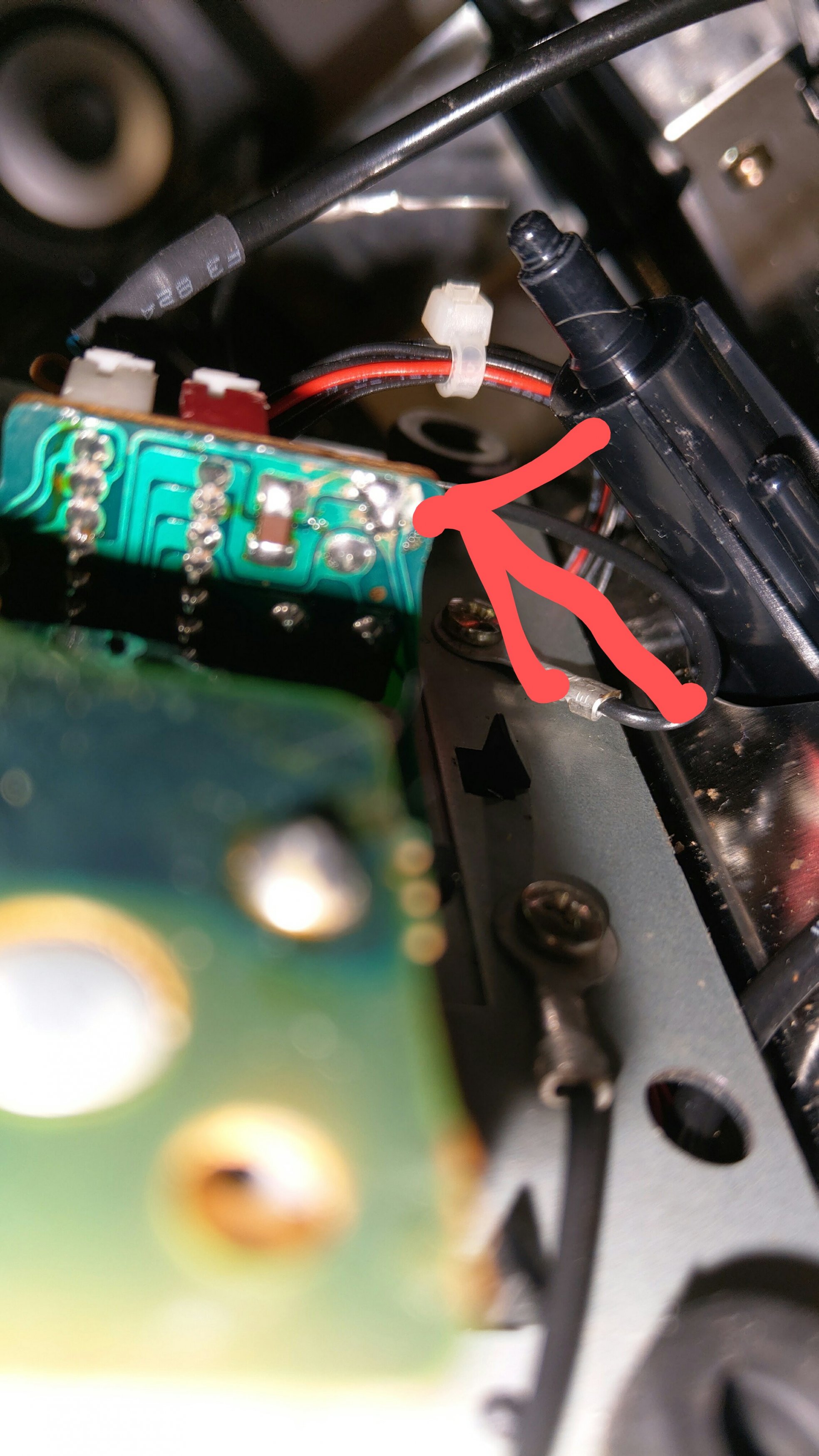

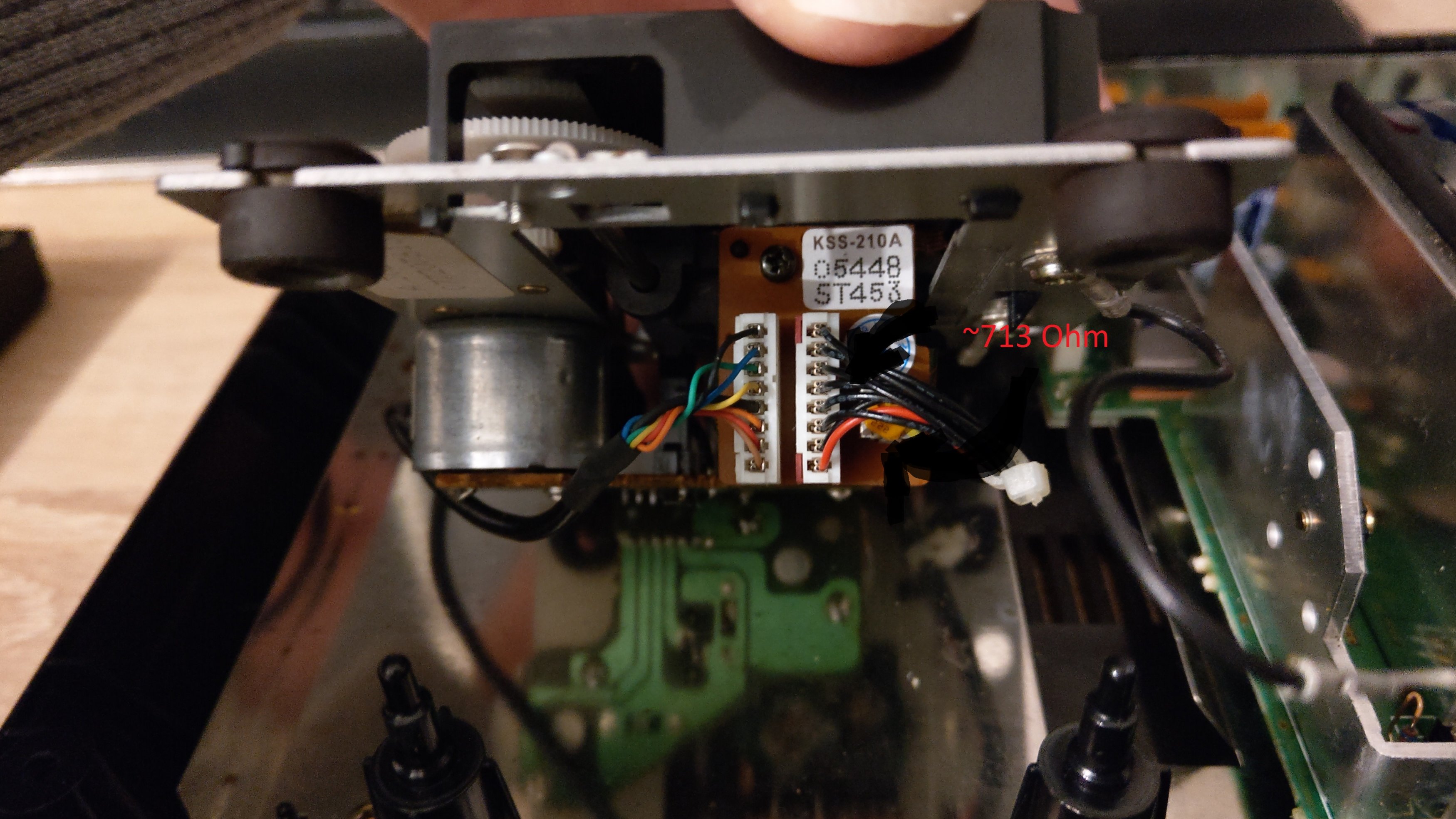

I've uploaded some pictures maybe that is more helpful

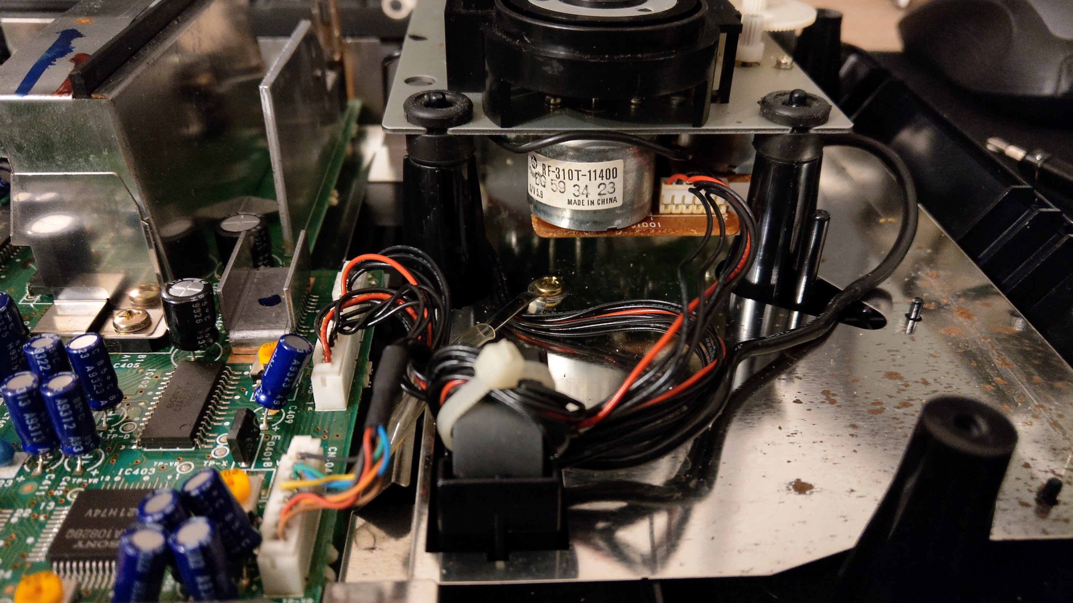

OK so final update, after found a new repair video on YouTube, I finally got it to work. And this guy was the first person I've seen that has mentioned it when replacing the laser.
I never knew that u need to remove a little solder bridge that soldered for transport reasons. So after I removed the bridge all was totally fine. Except that on the button of the screen are some graphic glitches, so maybe I need to do a recap.
Anyway thanks for all your help guys
