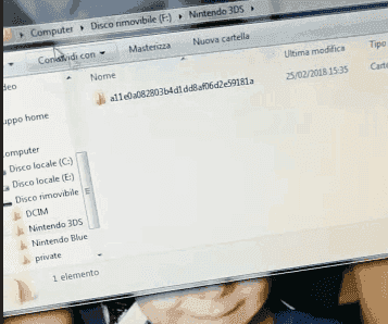

Please do give me a screenshot of how you got the id0, and please dont tell me it is yours - the id0 we need is the one of the 3DS that's getting modded. And i hope the FC you sent me was the one from the one getting modded as well.
Of course it's from the same one. Here is the screenshot. I don't know what to say anymore
that looks correct. Sorry if im sounding mean, but i simply dont want to waste time ;)
