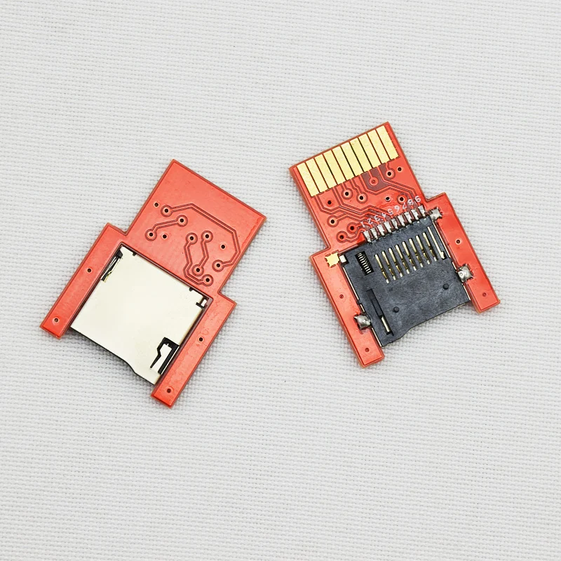

If no one has any other things to try, I think its probably a bad sd2vita. it was $3 shipped on ebay and this is what it looks like exactly:
I have the exactly same issue
I got it working. I was probably using the wrong driver linked on the youtube site (external vs internal driver)
Only use files linked on
http://wololo.net/2017/07/20/setting-sd2vita-adapter-formatting-microsd-can-done-windows/
I was probably using the uma0(removable) driver with a ur0(internal memory) config, either that or the youtube linked "gamesd.skprx" was just plain bad. I chose the internal memory driver (ur0).
So I spent $2 more for a card that I probably didnt need but this card has easy eject at least. Good luck anyone who finds this thread.
