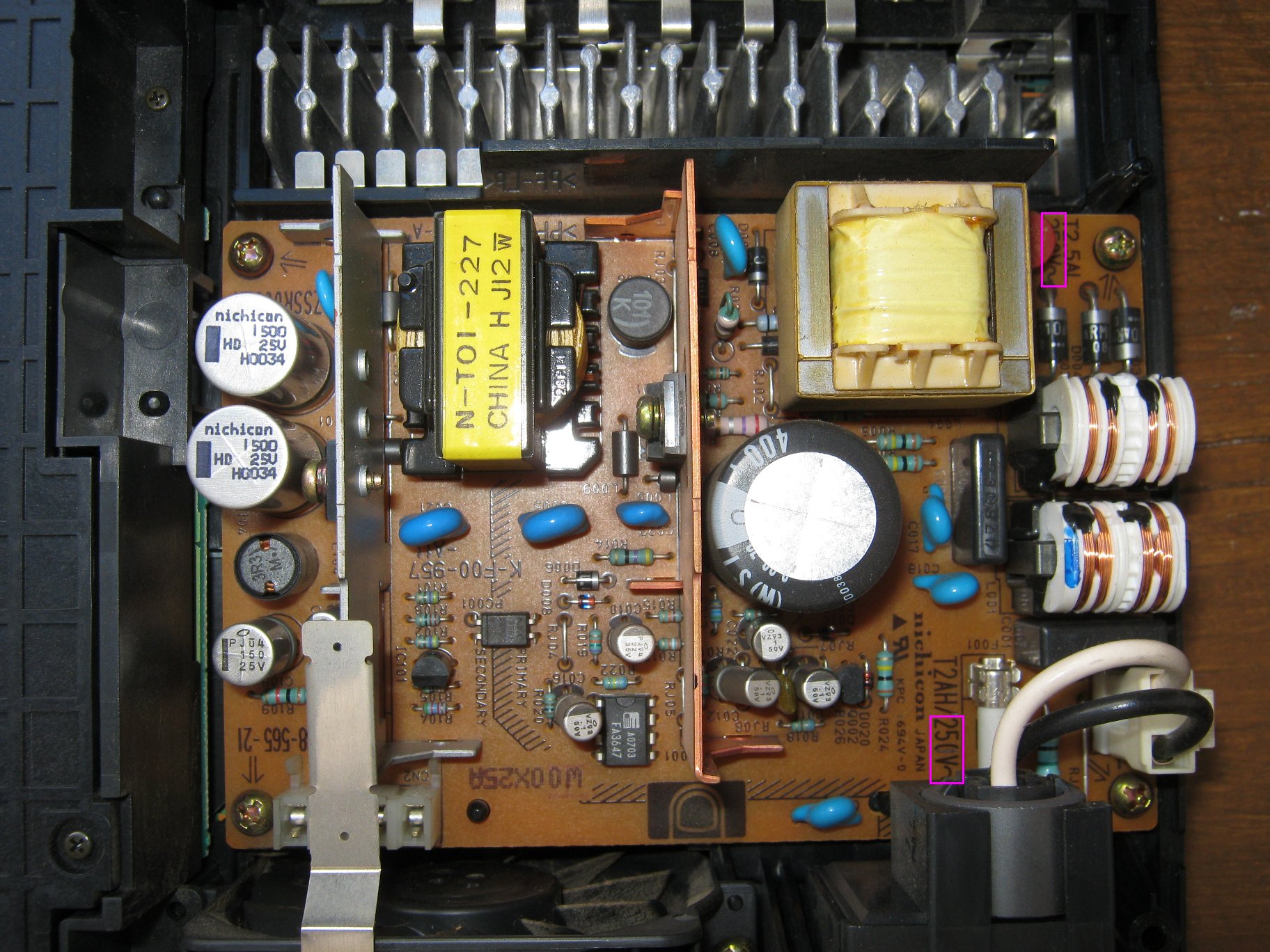

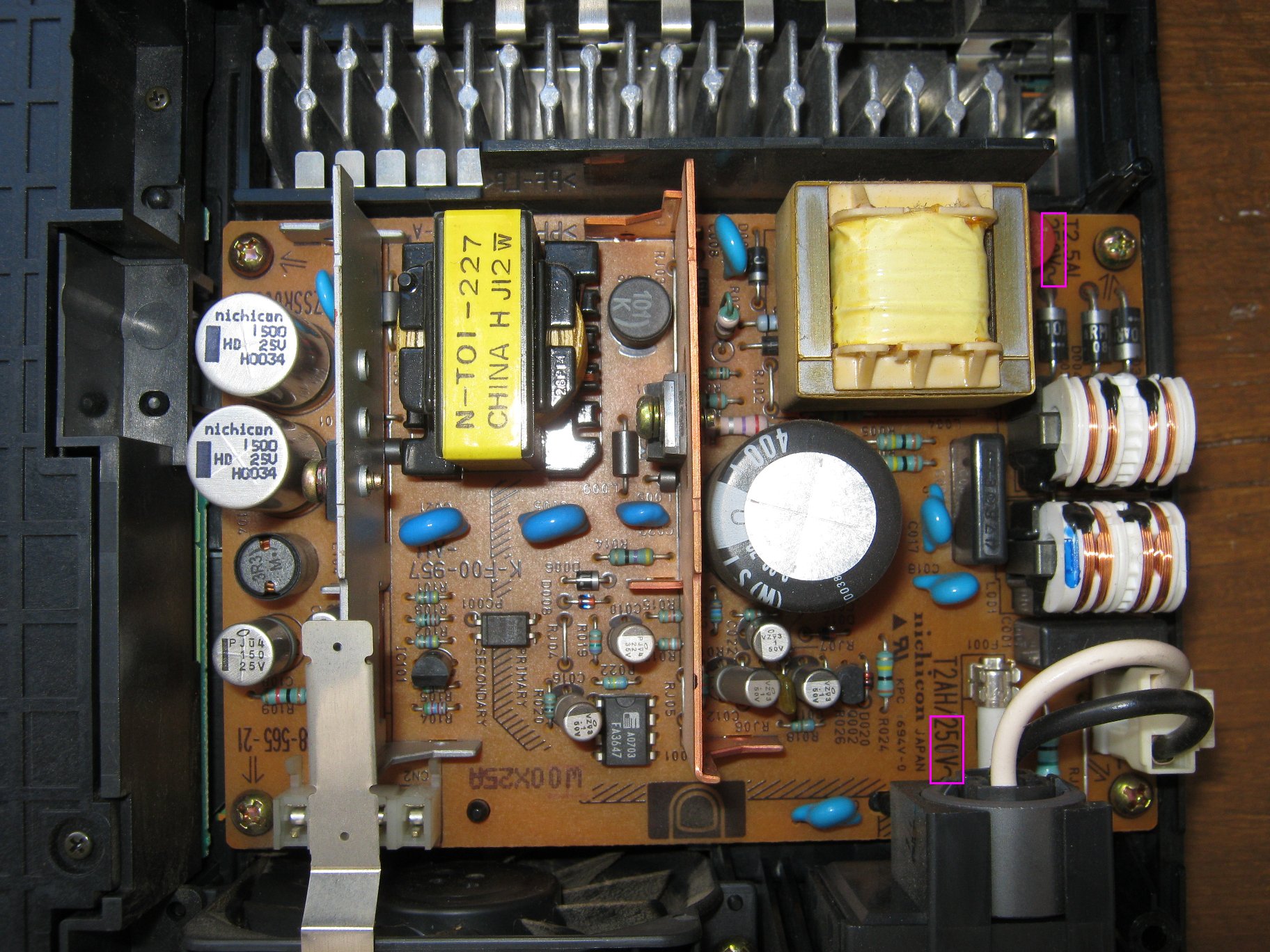

  9. KleinesSinchen
    KleinesSinchen GBAtemp's Backup Reminder + Fearless Testing Sina
    Joined:
    Mar 28, 2018
    Messages:
    2,308
    Country:
    Germany
    Didn't quite capture this very well, but anyway:
    There are two spots that say 250V ~
    alexander1970 likes this.

  12. KleinesSinchen
    Joined:
    Mar 28, 2018
    Messages:
    2,308
    Country:
    Germany
    Sorry. Should have mentioned this. It is PAL/European. SCPH-30004
    As the PSU has printed 250V ~ on it and not a range I assume it is limited to countries with the higher voltage (and I assume the 30001 PSU will have printed lower values on it).
    Sturgies and alexander1970 like this.
