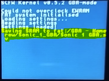

The SuperCard SD's SRAM chip is not designed to sustain SRAM data for long periods without power. This is the designed hardware behavior of the SuperCard and it cannot be fixed by conventional means (ROM patching, kernel modifications, etc...). This is the reason why I tell you that if you turn off your GBA, you need to turn it back on as soon as possible but do be careful with your power switches as that can break too. Once you power cycle your GBA, wait until you're able to see the root directory of your SD Card cause that would mean that the SRAM data has been properly offloaded to storage.
The above picture shows that the kernel hasn't fully booted yet and SRAM hasn't been offloaded to storage. To reiterate, wait until this screen clears and you're able to navigate the filesystem menu. It should then be safe to turn off the GBA afterwards.
Oops, I'm sorry. I will rely on soft reset from now, thanks for the explanation.

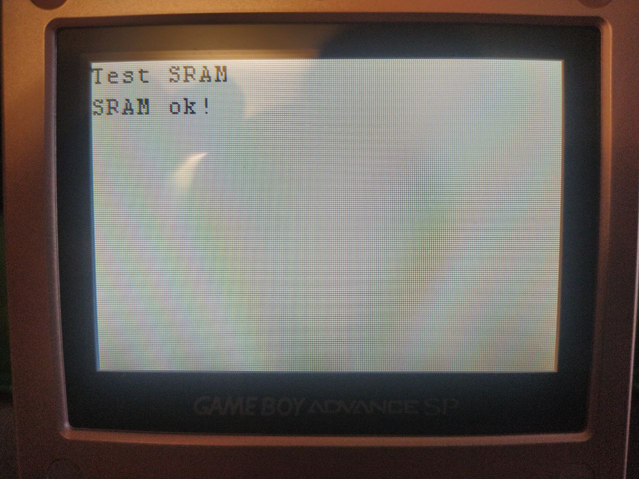

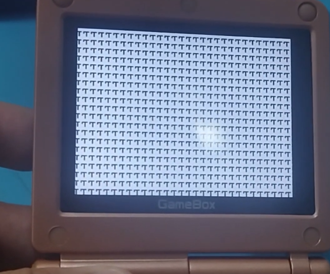

hi. got a supercard last year. and saw this today
just tested my supercard pressing L+R while turning on. and got this text on screen instead of the tiles shown in the tutorial video ()
does this mean that my cart is a fake and shouldnt install scfw?
1st pic is mine, 2nd is from video
well. just by removing the microsd to minisd adapter something broke. either the adapter itself or the carts card reader. so the project has been suspended indefinitely

Test screen is what you should see, I think the youtube video is primarily demonstrating the differences between the Supercard on actual GBA hardware and the EXEQ GameBox clone device.
The 2nd screenshot you provided is what happens on the GameBox but isn't supposed to happen on real GBA Hardware.
