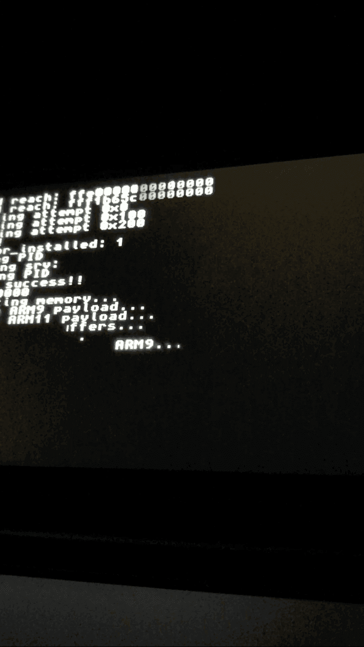

You think you can combine them because after I load safehax I get a black screen after this

Because on 9.2 you have the permission this exploit gives you normally. If you're under 11.x, you should've followed Plailect's first.
