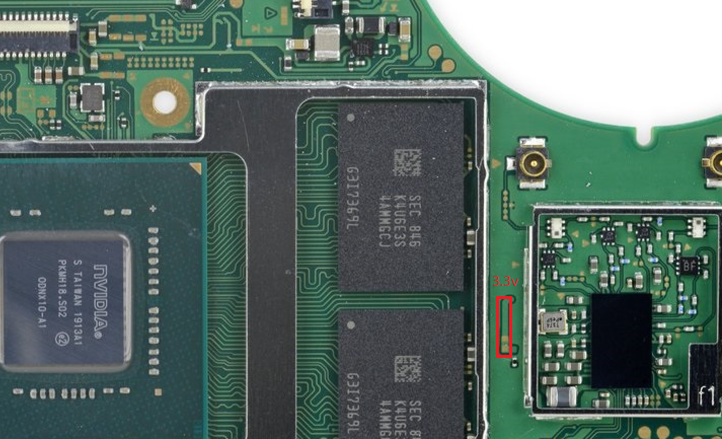

Is the image below correct? I am going to use wires rather than the connector that was provided.

When you are working on a lite with that cluster of pad pairs above the APU, remember that you are always using the left most set of pads in the row. The third set down counting from the top (dat0) and the third (clk) and fourth (cmd) set counting from the bottom. It just easy to remember 3rd from the top and 3rd and 4th from the bottom.
A (CMD) - fourth set of pads from the bottom
B (RST) - pad in the corner of the diode symbol and FL lettering
C (DAT0) - third set of pads from the top
D (CLK) - third set of pads from the bottom
3v3 - tiny cap or point that @jkyoho points out below
GND - pick a ground point

COMFIRM
would suggest you using 3.3v point from here rather the small cap you would rip it off
I dont mean this to be aggressive or rude. If you are concerned that you might rip off the 3v3 cap (one of the easiest parts of the oled install), don't do an oled install. The point suggested is probably fine, but if your skill level with regard to that cap is wanting, you are about to get in way over your head.
This alt 3v3 is fine. Its not my personal pref but it may be a better option for you.

Can you even CHECK what model OP talking about before you typing some nonsense reply. THIS IS SWITCH LITE!! stop spoiling your OLED copy paste infos
Lol good call out. I definitely mixed up posts I was responding to. Ignore my notes. Updated posts to reflect lite info instead.
