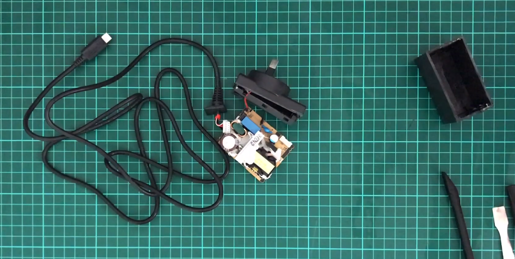

Hi,
i got an switch ac adapter with the usbc plug cut off.(original plug wasn't included)
Should it be possible to solder another cut usb c cable with plug onto it?
I've heard Nintendo isn't using the usb standard here and i don't want to fry my switch when I try this charger.
Picture:
Would be nice if someone has done this before and can give me some advice.
cheers

Good to know but your Aukey charger costs almost twice then the original charger :D
Couldn't find much about the Nintendo charger and his usb c wires.
edit: except this image from an YouTube video (Michaelblog456):

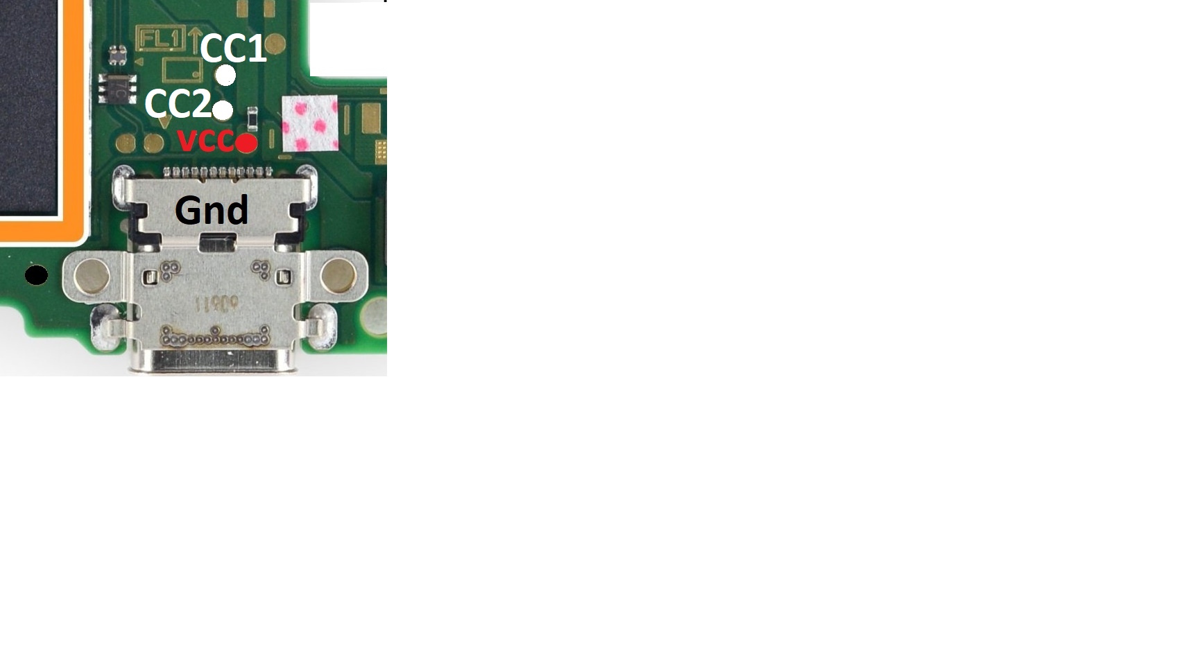

Do you by chance have a Pinout diagram of sorts for? Maybe that will help him...:grog:
No. But the cable you have there is an USB-OTG cable, it has extra hardware in it that tells one side to act as USB host, due to that it might not be suitable for what you want to do, you should find a plain cable (either an extension cable or a normal charging cable) to use.

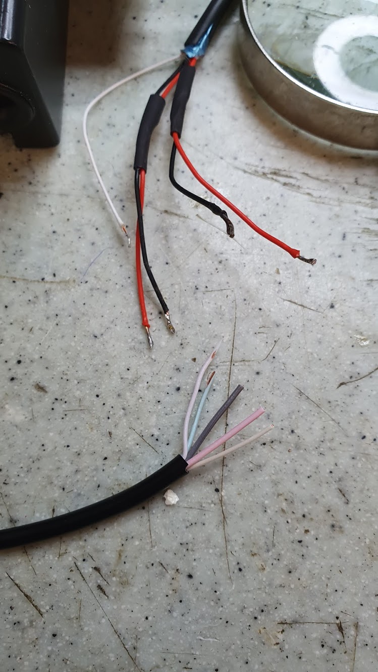

Update: After some months of waiting i got a cheap usbc charging cable from china.
Sadly the wire colors are very random:
Thick Red
Thick Black
White
Blue
and a yellowish one
Is there any way to test how the colors are assigned without disassembling the whole usbc plug?
