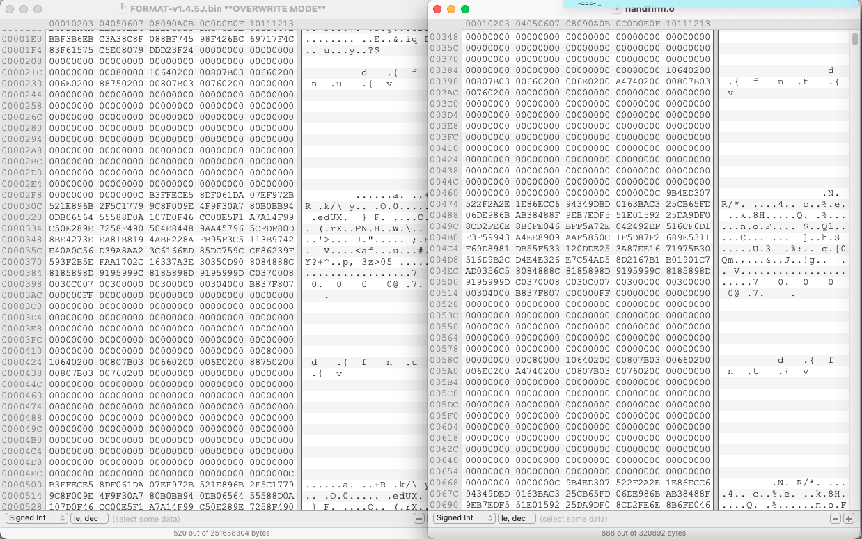

I've been trying to get a few prototype stage 2 bootloaders from the gigaleaks (search for *.nand files) to boot. I tried taking the new bootloader and pasting it into the NAND dump starting at 0x200. I just get a white screen on boot.
Judging by source code in TwlIPL I can 100% guarantee that this is actually a stage 2 bootloader. Can't find any reason there why they wouldn't work. I've tried bootloaders from before and after the release version, and some print test bootloaders with no luck. Also installed a prod version that is pretty close to release (2665-9336 vs 2435-8325).
Any ideas why it isn't working?
^ bootloader from NAND and the gigaleaks. They seem the same.
