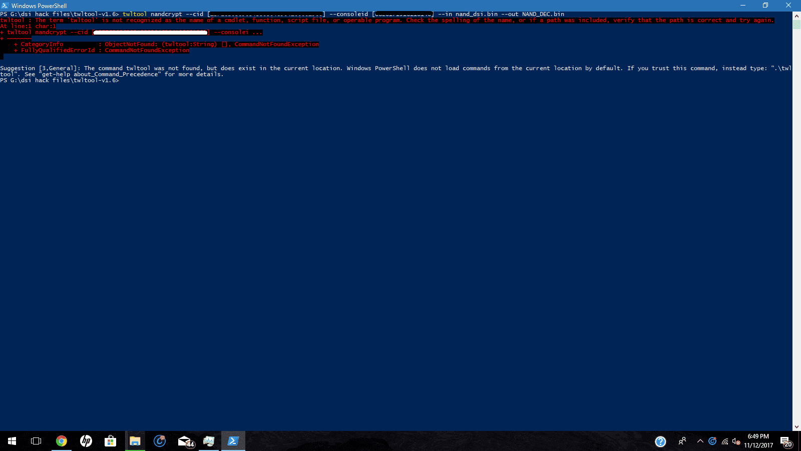

how is codes.txt supposed to Look? I keep getting an error in power shell and cant decrypt my nand? Says it doesnt trust twltool
It should look the same but with consoleid and cid entered. Make sure to keep the brackets and copy all the code to paste.
How do I do that?
Sent from my iPhone using Tapatalk
Do you see a common key generator/grabber file anywhere?
like this?
"twltool nandcrypt --cid [7CC75B907C034D303046504100001500] --consoleid [08a2370313103108] --in nand_dsi.bin --out NAND_DEC.bin"
