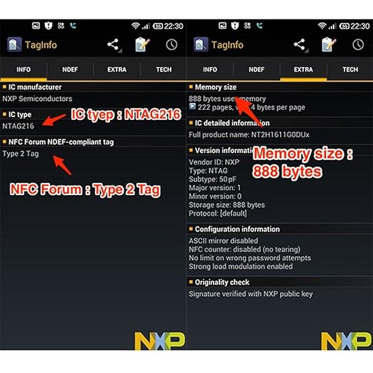

Got these ones, is there a way to check if those are really NTAG215?
Get TagInfo from the play store. I've included a screen shot of a ntag216, since I couldn't find a ntag215 one but you get the idea. Use TagInfo to scan the tag. It will tell you what type of tag it is.
