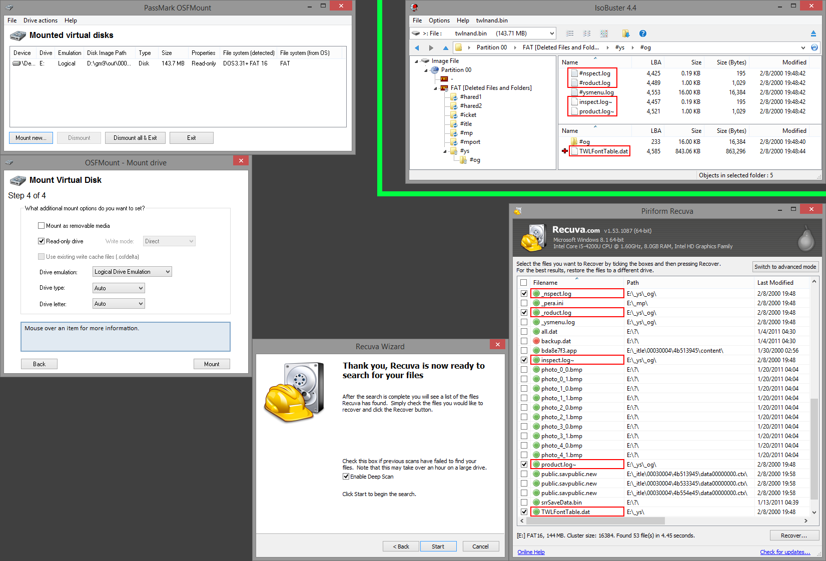

  • @AnalogMan - His Lazarus3DS and related NAND gm9 scripts are major influences in understanding key aspects about 3DS firmware recovery.
  • @Namesnipe - Shared the neat knowledge that individual tickets can be backed up from the ticket.db.

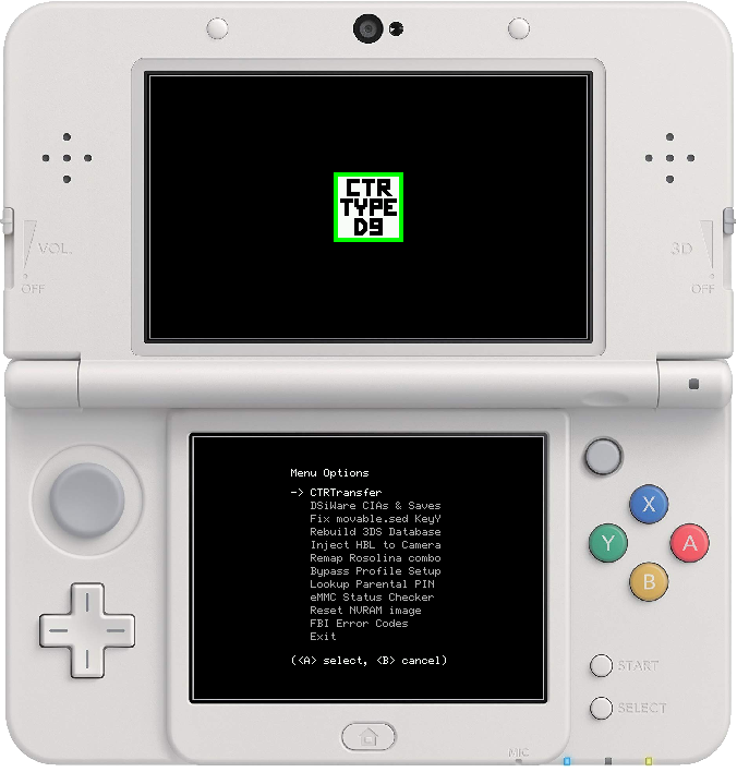

This is a gm9 script for performing a variation of Decrypt9 CTRTransfer. Homebrew 3DS users are likely to be more familiar with standard or (built-in) GodMode9 CTRTransfer. While both types are used for repairing or region changing the 3DS firmware, there are stark differences in how they go about changing or correcting the CTRNAND.
Decrypt9 Method
  • A few console unique files such as the movable.sed, configsave.bin, LocalFriendCodeSeed_B, and SecureInfo_A/B are first extracted from the CTRNAND drive. Afterwards, Decrypt9 (the program) flashes the entire raw donor CTRNAND *.bin image file onto the CTRNAND partition. Those backed up files are moved back in the drive to their respective locations and CMAC hash corrections are done throughout such as for the *.db datebase files and user's extdata + sysdata.
GodMode9 Method
  • GodMode9 (the program) selectively replaces only the title folder and *.db files. This is to surgically fix the broken system apps while keeping the rest of the user's personal and console unique files intact. Once these folders and files are replaced as needed, this is followed by CMAC hash corrections for those *.db files.
To put this into a comparable life analogy of the two, GM9 CTRTransfer is like replacing worn houseware parts, patching holes for stone walls to a structurally sound but very old house, and renovating its dainty decorations, flooring, and walls. D9 CTRTransfer is like removing your furnishings and personal belongs out of the house, knocking that house down because it's deemed too decrepit, building a replica in its place, and then moving as much of your stuff back in, assuming you haven't forgotten leaving behind anything before the teardown.
GodMode9 is the safer and less intrusive of the two while fixing most general softbricks. Although Decrypt9 is arguably more effective at dealing with severe softbricks, the older app's implementation fails to back up and restore crucial files such as hardware calibration HWCAL0.dat and HWCAL1.dat, personal legit tickets, and [seed|nag|friend|nnid|etc.]save.bin.
With those differences in mind, this script was created with the goal of combining the Decrypt9 approach of flashing a clean slate CTRNAND drive while also maintaining as much of the user's original setup like that of GodMode9.

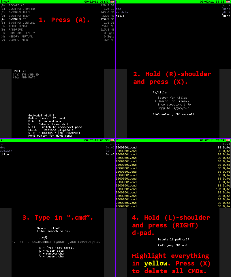

  3. Strange '?' files that are stubbornly stuck in CTRNAND or cannot be deleted/replaced by conventional means.
    • Despite H2testw checking the SD card for issues, updating the custom firmware & 3DS firmware, and troubleshooting for any and all hardware issues, your system has unexplainable boot issues, poor GUI functionality, or random crashes. You (surprise, surprise!) don't have the benefit of a clean, backed up SysNAND *.bin image to recovery from. Attempts at using standard CTRTransfer are not providing favorable results. You may very well have a broken file allocation table at hand. If those damaged files are limited to replaceable or non-unique items, this script will try maintaining anything that's salvageable.

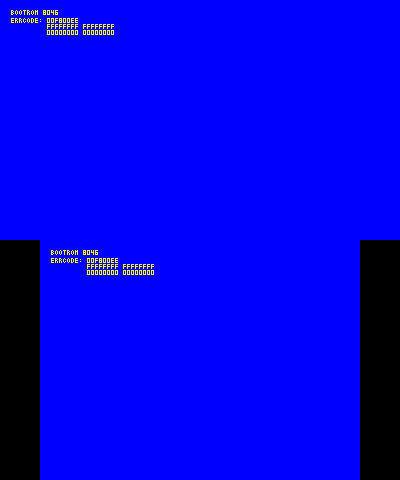

  4. The system turns on with Blue Screens of Death.
    • The nand header (nand_hdr.bin), TWL partition table (twlmbr.bin), [New 3DS only] secret sector (sector0x96.bin), and/or bootloaders (firm0.bin & firm1.bin) were corrupted from careless firmware modding, A9LH downgrade softbrick, or Gateway3DS malicious brickcode running a firmware newer than 11.2. In order to bypass the bootrom 8046 and launch GodMode9, an ntrboot flashcart would be required such as the R4i Gold 3DS Plus (recommended) or R4iSDHC series (shitty timebomb).
    • :!: This cannot fix hardware based BSoD where the nand chip is fried from a failed hardmod or physically damaged by other means such as spilled water.

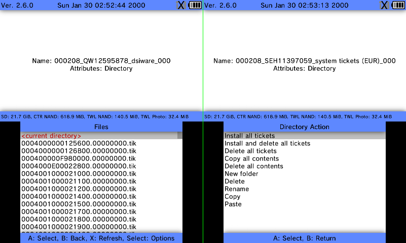

  18. Backs-up the system tickets from the donor CTRNAND image.
    • This is done to keep the user's original ticket.db in place with the private legit eShop tickets intact.
    • The console's original system tickets are also dumped on top of the donor system tickets for further preservation.

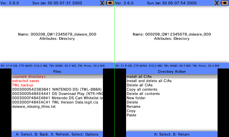

  26. Backs-up the DSiWare titles as CIAs and save files. Backs-up TWL system titles into legit CIAs if they're salvageable.
    • CTRTransfer makes TWLN titles forgotten due to changing out the title.db.

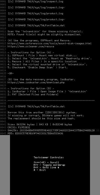

  27. Rebuilds the S:/twln.bin partition; reformat the [2:] SYSAND TWLN(AND) drive.
    • Console unique TWL nand files such as inspect.log(~), product.log(~), sysmenu.log, TWLFontTable.dat, opera.ini, and 0000 are retained.
    • If the 2:/shared2/0000 (soundsave.bin) is missing, generate a new copy.

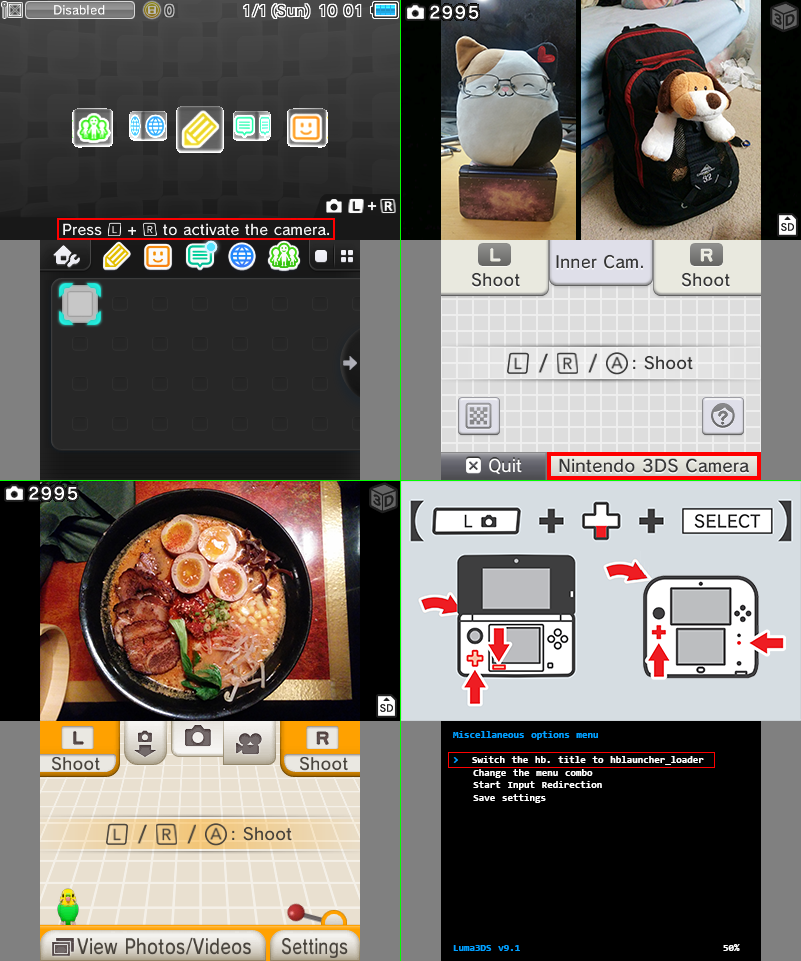

  33. Asks to Rosalina menu inject Homebrew Launcher to Nintendo 3DS Camera.

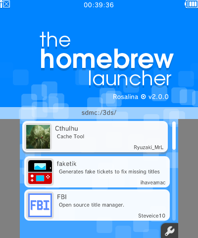

    • (1) Your setup must have GodMode9, the 3DSX versions of FBI, faketik, and Cthulhu, Homebrew Launcher, and Luma3DS.
    • (2) Extract files from [ .7z | .rar | .zip ] archives with 7-Zip or WinRAR.
    • (3) Download Links: GodMode9 , FBI , faketik , Cthulhu , new-hbmenu , Luma3DS

    • Note: In the off chance the 3DS fails to boot HOME Menu with the below (or similar) error, fixing this requires manually finding and deleting the (ext/sys)data subfolder that is causing the hang-up: Debugging "gamecoin"-type brick
    • XX02 = [ JPN: 8202 | USA: 8F02 | EUR: 9802 | CHN: A102 | KOR: A902 | TWN: B102 ]
  12. Open the Nintendo 3DS Camera to access Homebrew Launcher. If region changing the 3DS firmware and there are no system titles shown in HOME Menu, press the { (L)-shoulder + (R)-shoulder } button combo to launch the camera applet → Nintendo 3DS Camera → Homebrew Launcher.
    • Note: If you have a [ o3DS | o3DSXL | o2DS ] and it gets stuck with black screens, press the { (L)-shoulder + (DOWN) d-pad + (SELECT) } button combo to open Rosalina menu → Reboot. This should restart the system and open Homebrew Launcher.
    • Note: If the shoulder buttons and/or cameras are broken, rerun the Inject HBL to Camera with an inserted 3DS game cartridge.

  13. Install the system tickets and DSiWare CIAs with FBI. Restore missing tickets for nonlegit titles with faketik. If you have a lot of games, mass unwrap them all with Cthulhu.
      • The tickets and CIAs folders are named in the following formats found at sdmc:/gm9/out/
        • <date>_<serial>_dsiware_000
        • <date>_<serial>_system tickets_(<region>)_000
      • :!: See the FBI errors 0xD8E08066, 0xD8E0806C, and 0xD8E0806A section found below if the tickets or CIAs fail to install.
    • restore_nonlegit_titles_tickets-png.210822

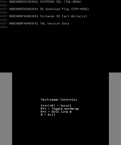

    • Note:A log report is created for DSiWare games that fail to get converted into CIAs. Find replacement CIAs based on the TitleID list.
Conditional: This last step depends if the [2:] SYSNAND TWLN was found to be missing console unique files.
17. Image mount the twlnand.bin and run a data recovery to retrieve lost or deleted files listed in the twlnand_missing_files.txt.​
  • Option (A) OSFMount + Recuva
  • Option (B) IsoBuster
  • sdmc:/gm9/out/<date>_<serial>_dsiware_000/TWL backup/twlnand.bin
  • sdmc:/gm9/out/<date>_<serial>_dsiware_000/TWL backup/twlnand_missing_files.txt
  • missing-twlfonttable-dat-png.175091

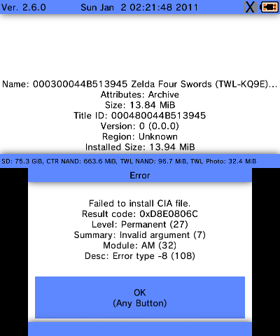

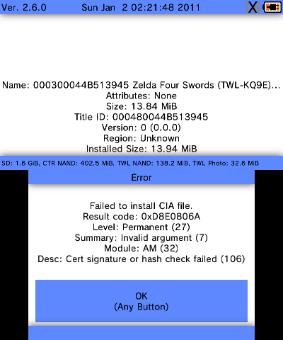

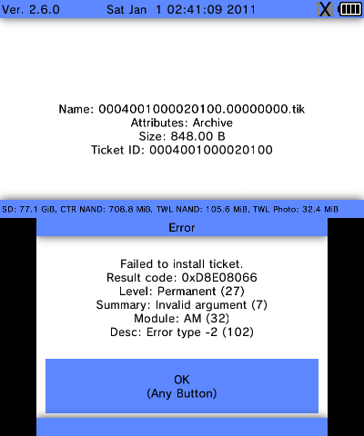

  • 0xD8E08066 - The system tickets may fail to install due to something called the certs.db (certificates). Your setup at one point either corrupted it or erased & regenerated that file with a dummy nonfunctional copy. A replacement copy borrowed from the CTRTransfer image would then be required. The script can replace that file if you come across this issue. Do not use this option if the problem doesn't exist; certs.db is partially involved with transiting 3DS online play.
  • 0xD8E0806C- The backed up DSiWare titles may fail to install. This is likely to occur if the CTRTransfer was used to region change the firmware. To fix this, install a different DSiWare *.cia file that's not from that backed up set. I have no clue why this hiccup occurs...
  • 0xD8E0806A- The backed up DSiWare legit game titles may fail to install. To fix this, either redownload these previously purchased games from Nintendo eShop or convert the dumped legit CIAs into standard CIAs.
    • DSiWare CIAs & Saves → Convert CIAs (legit to standard)
    • Install the files in '3. cias (converted)' first followed by '5. tickets (legit)' to retain your private legit dsiware tickets.

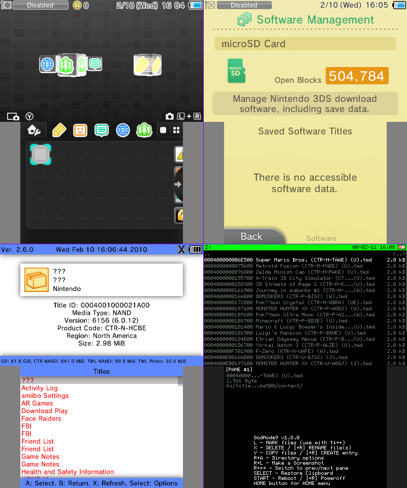

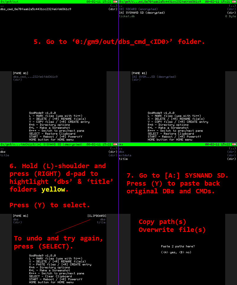

Relisting or rebuilding the 3DS database files.
In the event the title.db and import.db found in 0:/Nintendo 3DS/<ID0>/<ID1>/dbs are corrupted, all games, DLCs, and updates would be forgotten.
  • HOME Menu: <blank>
  • System Settings → Data Management → Nintendo 3DS → [Software|Downloadable Content]
    • Being asked to reset or delete all software and savedata.
    • Saved Software Titles has gray question marks [ ? ].
    • Saved Software Titles is <blank> or has no icons.
    • For missing tickets, this can be fixed with faketik. ← (This is not a database issue.)
  • FBI → Titles: SD titles in green do not appear.
  • GodMode9: They can still be found when doing [A:] SYSNAND SD → Hold (R)-shoulder and press (A) → Search for titles...
You can rebuild the list with one of these three options.
  • Option (A) - Quick
  • Option (B) - Full
  • Option (C) - Manual

1. (Re-)installing a CIA over a previously installed game will overwrite and delete its save currently in place. The Rebuild 3DS Database options were designed to fix the import.db and title.db without losing the saves and to keep whatever legit tickets you might have acquired from real Nintendo eShop purchases and updates.
2. During the options' script runs, do not press the (B) button. There is no way to idiot proof the CIA building process. If you press (B) button, you are forced to manually rebuild those titles into CIAs if they were interrupted. Just plug the 3DS system to a AC charger, flip the clam shell closed to let the script do its thing, and leave it alone. Except for Option (C) and if everything goes smoothly without error, the script will turn off the 3DS/2DS to let you know to move onto the next part.
3. Each option has two parts (1 - starting , 2 - finalizing) with an intermediate step of installing CIAs. Do not mix and match the parts between different options.

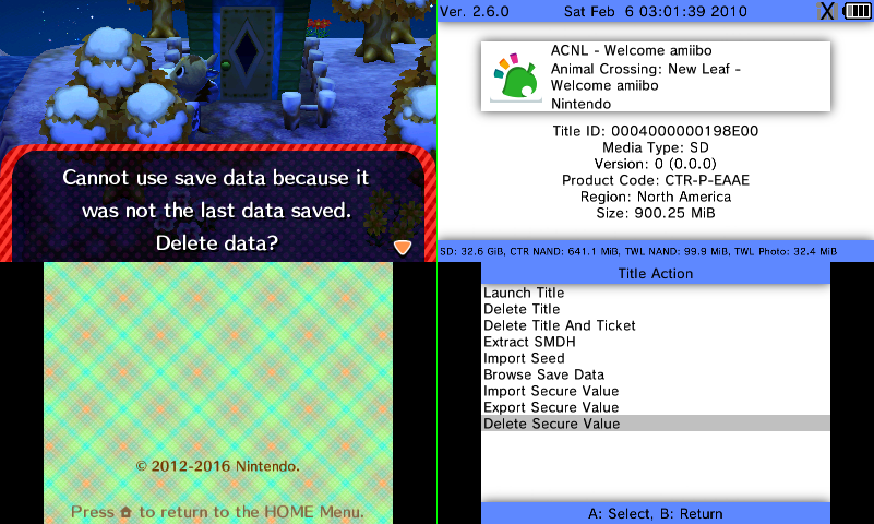

4. Certain games have anti-cheat save protection that will erase itself if tampering or swapping is detected.
Two well known examples include:
  • Animal Crossing: New Leaf (including Welcome Amiibo edition)
  • Super Smash Bros. for 3DS
To bypass or reset the secure value, either:
  • (1) Backup & restore the saves with Checkpoint/JKSM.
  • (2) Delete the secure values for games that are known to have this using FBI. Do not try to delete the secure value for games that don't have it.
  • Update January 23, 2020: Version 1.4 automatically removes the secure values when restoring the setup/saves in part [ 2a | 2b | 2c ].

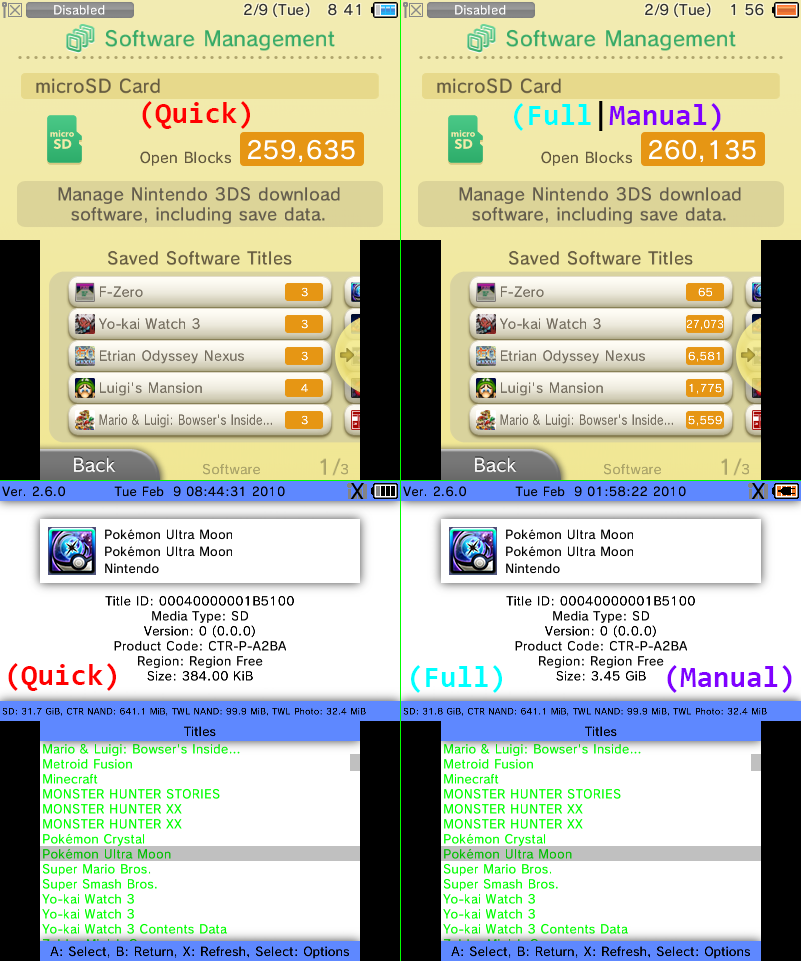

Option (A) - Quick
The fastest of the three where dummy CIAs are generated, and all installed titles (saves included) are relocated offside to a temporary title_<ID0> folder. Once the dummy CIAs are installed:
  1. The original ticket.db is restored to keep the user's real tickets in place.
  2. To prevent accidental reinstallations of the dummy CIAs, the cias (dummy)_<ID0> folder is deleted.
  3. The titles are moved back to the title folder.
  4. Their individual *.cmd header CMACs are corrected.
:!: A minimum 256 MB of free space is required when making the dummy CIAs.
:!: Installing dummy DLCs with lots of contents can make FBI appear to crash or become stuck frozen. However, the progress is rather really slow for these titles. Look at the top row's moving clock for proof; be patient and don't force shut off!
:!: The sizes and blocks will be reported wrong in FBI and System Settings. There's no away around this annoyance except to use or redo rebuilding the database with one of the other two options.
:teach:If curiosity got the better of you, where you completed both parts (1a) Generate Dummy CIAs and (2a) Restore Setup, and you want to restore your SD setup just like how it was before having started Option (A), this is entirely reversible with the backed up files found in dbs_cmd_<ID0> folder.
option-a-description-instructions-png.210260

Option (B) - Full
This is the slowest option when rebuilding the database. Alongside with Option (C), however, the final reported sizes and blocks in FBI and System Settings will be correct. For each title that is successfully backed up as a CIA, its <TID LOW> subfolder within title/<TID HIGH> folder will be deleted. In case of errors, outside files and titles that aren't made into CIAs are not deleted but moved over to a collection title_<ID0> folder for your later examination. If found, saves are decrypted and extracted to a separate saves_<ID0> folder regardless if their parent games were built into a CIA.
Once the CIAs are backed up, and the titles are reinstalled:
  2. The saves are individually restored depending if the parent games were found to be reinstalled.
:!: A minimum 4 GB of free space is required to account for building the largest possible CIAs.
:!: To avoid misuse or misunderstanding, option (B) requires a certain action outside of the script. Read the option description on what to do before using (1b) Backup CIAs & Saves.
:arrow: Unlike Option (A), the cias (proper)_<ID0> output folder is left alone. You can keep copies of those backed up CIAs on your computer.
:arrow: If your SD card has less free space than the total amount of all the CIAs, use:
  • FBI → cias (proper)_<ID0> → <current directory> → Install and delete all CIAs
option-b-description-instructions-png.210261

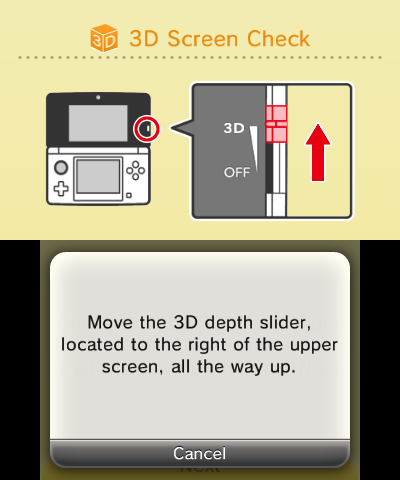

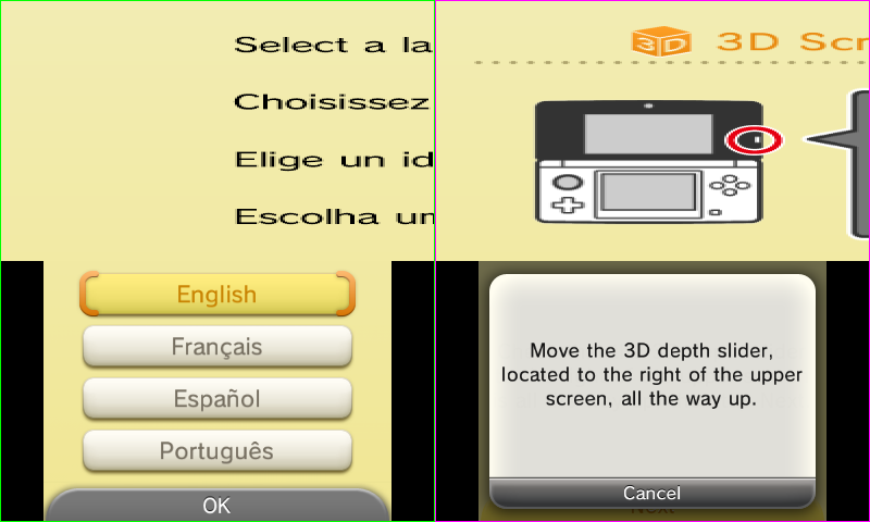

Bypassing the new user profile setup.
3DS systems that have broken 3D slider switch will get stuck at the 3D Screen Check after performing a system reformat.
Those who have hacked their o2DS by following outdated 2.1.0 CTRTransfer downgrade guides may also get theirs stuck at that screen, albeit with a distorted appearance.
This pitfall scenario can be skipped with this script. Once HOME Menu is reached, filling out personal information and user agreements is still mandatory for access to online services and system updates.
  • System Settings → Internet Settings → Spotpass →
    • Automatic Software Downloads
    • Sending of System Information
  • System Settings → Other Settings →
    • Profile: User Name, Birthday, Region Settings
    • Date & Time
    • Language

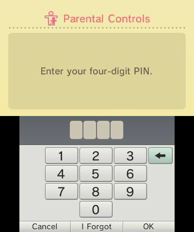

Looking up the Parental Controls PIN number.
Did you forget the four-digit password to the Parental Controls? Did you receive or purchase a 3DS system that the previous owner didn't unlock? No problem!
