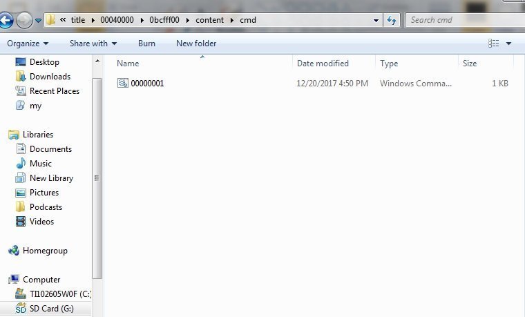

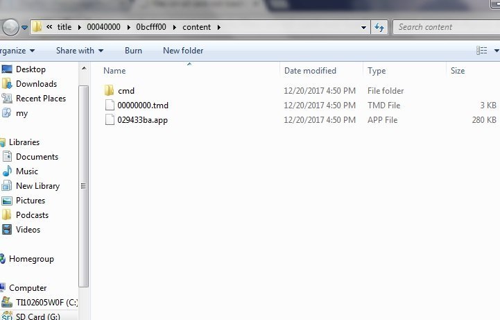

@Lirx, can you do several things so we know what we're working with?
  1. Take a look on the SD card and see if the *.app, *.tmd, *.cmd, *.sav, etc files are still present in:
  • sdmc:/Nintendo 3DS/<ID0>/<ID1>/title/0004000/##XXXX## subfolders.
These would be deleted from Format System Memory and are not recoverable, not even with data recovery programs. :(
However, if those are still present or you made a backup of this exact Nintendo 3DS folder beforehand on computer or another SD card, you games might be recoverable * depending the outcome of 1.

okay. too late. i have an o3ds btw

okay soooo what do i do from here?

I need you to verify those files with those extensions still exist in their subfolders. This lets me know your data is intact with a slim possibility of recovery depending what we find in step 2.

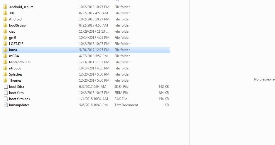

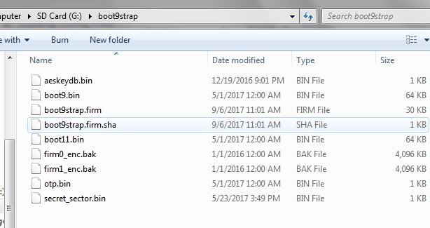

btw i have an old3ds so i think im screwed on the eshop thing without reformatting.. i heard that i have to have a second Japanese 3ds to fix it to transfer data.
alright...step 2

:p i cant change it back on an o3ds..:*(

Awesome! We have the first part of the picture of whether or not the games are recoverable.
Since you're really new at this, for your safety I want you to follow these steps. Some of these may not make sense, but this is to make sure you don't accidentally softbrick your o3DS.
2. Make a copy of that Nintendo 3DS folder and set it aside on your computer.
3. Take a spare SD card, copy everything off it, and reformat it as FAT32 + 32 KB cluster size with either Windows File Explorer or guiformat.
  • A minimum of 4 GB will suffice and is recommended.
  • If you do not have any other SD cards, you'll have to use the one you do have and copy everything off it.
4. With it still empty, do a full Write + Verify Test with H2testw. Do not skip this step.
5. If the card passes, delete the *.h2w test files.
  • :!: If an error was reported, stop the test. Replace the hardware failed card and go back to step 3.

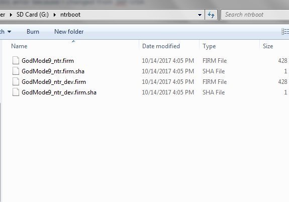

6. Build a test custom firmware setup with the CFW starter kit found here. Do not use any files from your main setup at this moment.
7. Insert the card into the 3DS. Turn the system on and hold (Start) to access Luma3DS chainloader. Select GodMode9.
8. In GodMode9, press (HOME) button → Scripts... → NANDManager → <X> Backup SysNAND → etc.
  • You should find these two files at 0:/gm9/out directory:
    • ######_XX########_sysnand_000.bin
    • ######_XX########_sysnand_000.bin.sha
  • This is your NAND *.bin image for recovery purpose.
9. Copy those two (2) files over to your computer.
Once you have done this, this will let us know we can safely proceed with the wetwork of modifying files on your CTRNAND drive. I'll explain more about this later.

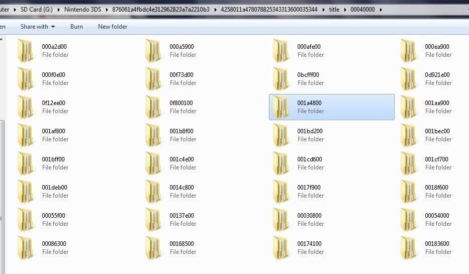

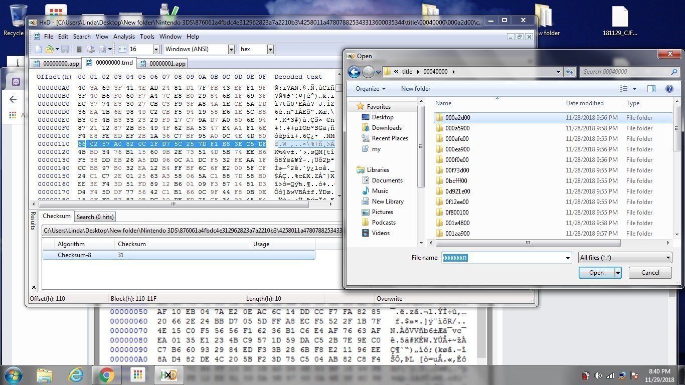

Okay for part 3, I need to explain some very important things so you understand what you'll be doing and why.
Edit - You will not be doing anything from this post except read and learn what is what.
The titles [games / DLCs / updates] and saves found within the Nintendo 3DS folder is encrypted by something called the movable.sed. This *.sed file is found on the 3DS internal SYSNAND CTRNAND drive that you will be navigating in with a homebrew app called GodMode9.
Within the movable.sed, there is 0x10 bytes string known as keyY. This is the part that encrypts and decrypts (locks & unlocks) the data in the Nintendo 3DS folder.
There is a mathematical formulaic relationship between the keyY and the <ID0> subfolder.
  • sdmc:/Nintendo 3DS/<ID0>/<ID1>/title/...
  • <ID0> is 32 characters string.
  • From the attached picture found at post #4, your <ID0> is 876061a4fbdc4e312962823a7a2210b3.

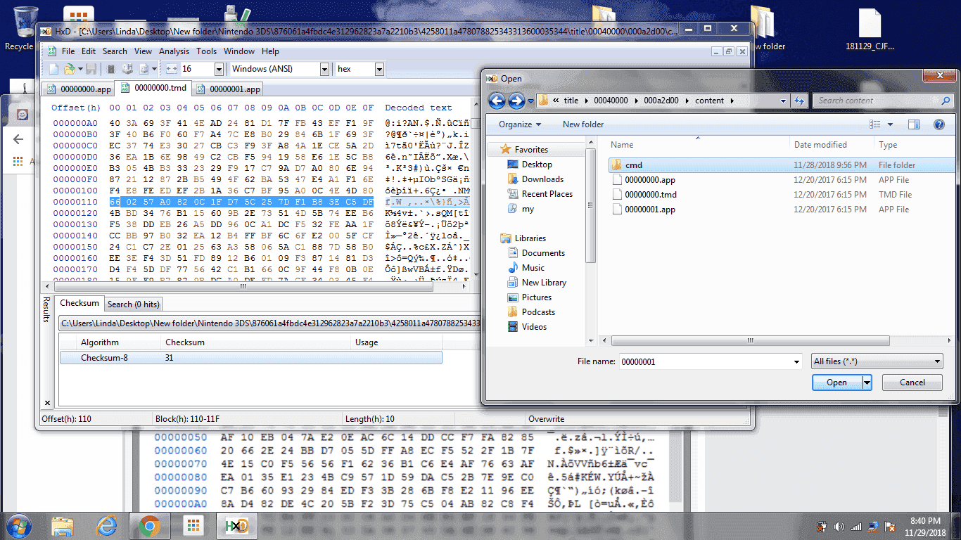

i dont know how to bring up the SHA Algorithm (this is insane stuff ahaha. sry if im giving u a headache) i cant pm yet...to new on here...
(btw where we left off. i havent touched my sd card or 3ds yet.. after the steps we discussed..)
im trying heehee u told em not to do anything so im probably not doing anything wrong...I dont know If im in the right spot or not but i posted screenshots of what im looking at... I think i have to post 10 times to PM u or something...
:3 thank nu again
:3 thank nu again
I see you're practicing how to highlight select bytes to calculate hash. This is very good to get this out of the way.
Just remember when the moment comes to do this with the movable.sed, you don't post pictures of that file.
After highlighting blue the section you want to find its hash checksum,
  • Analysis (top bar menu) → Checksums... → SHA-256 → OK.

  • keyY = E6 0C E7 03 00 00 00 00 D4 95 5B AC 87 BD C7 00
    • SHA-256 hash of this "supposed" old keyY.
      A4616087314EDCFB3A826229B310227AF5525B2CBE739A5E8AF47B1AEA25DC6A
      Take the first half and lower case the letters.
      a4616087314edcfb3a826229b310227a
      Split into 4 equal parts and add spaces.
      [a4 61 60 87][31 4e dc fb][3a 82 62 29][b3 10 22 7a]
      Reverse the order in each sections.
      [87 60 61 a4][fb dc 4e 31][29 62 82 3a][7a 22 10 b3]
      Remove the brackets and spaces.
    • <ID0> = 876061a4fbdc4e312962823a7a2210b3
    • This second calculated <ID0> matches the one previously seen and mentioned in post #4.
15. Make sure to hex edit the values at 0x118 and 0x120 by -1 for every Format System Memory. For @Lirx's case, she performed only a single reformat. Save the file, eject the SD card from computer, reinsert into the 3DS, and boot GodMode9.
Part 5 - Inject the movable.sed back into CTRNAND.
16. Go to 0:/gm9/out/movable.sed and press (Y) to [CLIPBOARD] select this file.
17. Go to 1:/private directory → press (Y) → Copy path(s) → <A> yes → button combo → Overwrite files(s) → <A> yes.
  • This will replace the *.sed file with the version you hex edited.
18. Press (A) on movable.sed → Calculate CMAC → <A> yes (to fix it) → <A> yes → button combo → <A> yes.
  • This will automatically make corrections for the AES-MAC hash between 0x130 – 0x13F.
19. Back out with (B) button. Hover over highlighting white [1:] SYSNAND CTRNAND. Hold the R-shoulder button and press (A) → Fix CMACs for drive → etc.
  • If you have the backed up Nintendo 3DS folder made prior to Format System Memory, you might need to Fix CMACs for drive for [A:] SYSNAND SD.
Part 6 - Check for title recognition in System Settings.
20. After creating a new user profile, go to System Settings → Data Management → Nintendo 3DS → Software. Check to see if the titles are marked with X's like this. This means the games, DLCs, and updates are missing their tickets.
21. Continue the data recovery process with the guide found at:
