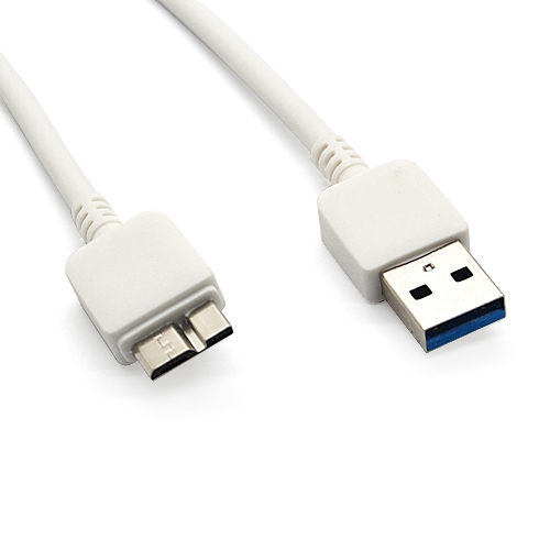

I have a Samsung Galaxy S5 (which is OTG compatible, the OTG checker app says so). The USB cable with it is USB3.0 (one end is A with blue in it and the other end is one of those special Micro ends with an added part on the side like most of those external USB3 HDDs have). I ordered a USB3.0 Type A to Type C OTG adapter on Ebay. So my regular communication/charge cable that came with my phone plugs the micro+ end into the phone and the other type A end into the USB-C adapter and then into the Switch. Only nothing happens when I use either Rekado or NXLoader. Does my combination of cable/adapter not work?

The white cable is the issue. Try getting a Samsung S8 cable plus a USB adapter (usually small) for your phone. Should work just fine.

Why is the white cable the issue if I may ask? I thought it just had to be USB3? It has to be USB3 because when I plug my phone in a USB2 port on my PC it says it can run faster if using a USB3.0 port (and it does).
If I bought a USB-A to USB Micro adapter instead to plug into my phone and used it with my Switch charge cable would that work?

The white cable won't allow communication with the Switch, that's why. The Switch needs USB C cable (only) and an adapter to communicate with your phone. You may also use the USB C cable without adapter with your PC (assuming yout installed the proper drivers).

I'll take your word for it, but just out of curiosity why does the protocol matter? Does the physical USB-C connector itself have some special protocol? Because I was using a USB-C adapter to connect to the Switch (as pictured above). Why didn't that count? Because it is USB3. Is that not all that matters? Just looking for more info. I like to learn. I just thought that any connection of USB3 to USB-C OTG was all that mattered. Obviously it clearly doesn't, but I'd like to understand the reason a little more.
At any rate, I have an official Switch connection cable that I've already been using to connect to my PC to deliver payloads successfully so I guess I'll just get a Micro adapter for the Type A end of that cable to connect to my phone instead.
EDIT: If I understand things correctly, this should work, yes? Or this?

This is the one to get: https://www.ebay.ca/itm/Micro-USB-t...036140?hash=item33ff265c2c:g:mFsAAOSwyApcO6KH

Thanks. Forgive my curiosity again, but why not the other one? Both will connect to my phone. Though, admittedly that one is cheaper.
Sorry @MusicallyInspired for the short answer. I was in a bit of rush.
I tried your experiment and it didn't work. I connected my phone cable to the Switch adapter I have to try and send the payload and it seems the adapter does not allow to send data. It has to be the USB C cable.

Some usb cables are "charge only" meaning some of the pins are missing or not connected. Usually this also equates to not being able to fast charge.
Meanwhile other cables are "charge and data" meaning they have the other pins on them and thus can communicate data (what you need to send a payload for example). Maybe the converters you have to be aware of this as well? (I've always avoided converters when I can).

My white cable came with my phone and is definitely capable of fast charge. I also use it constantly to communicate and transmit data between my phone and my PC. As for the adapter, it's OTG. It's printed right on it. The whole point of OTG is to transmit data. Which is why I was confused why my initial solution didn't work.

I think OTG adapters are only working in one way. It's USB-C -> USB-A and not the other way. Have you tried with a micro-USB -> USB-A OTG adapter and then a USB-A to USB-C cable ?
