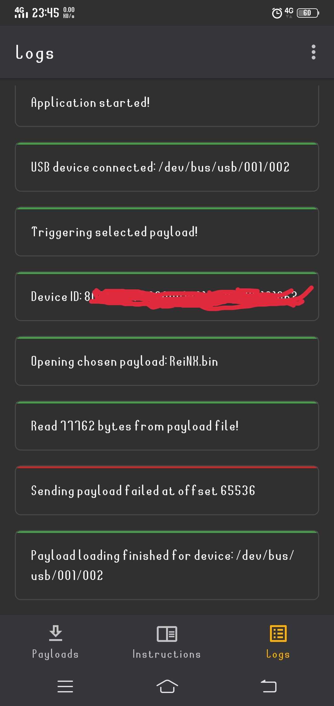

hello, i have an otg and usb c cable and a vivo v11 phone this phone support otg
this is the otg (i try my flashdisk in it and it appear the otg work as intended)
images
and i can confirm my usb c can send payload flawlessly when i try to inject thru pc
however whenever i try to inject payload using phone it always show the same error code (offset 65536), i also try using nxloader and the error shown the same number 65536
i try using different payloads and still the same error
what does this error offset means, where did my poor phone go wrong pls help!
error ss

That error is almost always when using a bad cable. Perhaps your USB A to C cable is too long or faulty? Here is someone with the exact same issue, using the same OTG adapter https://github.com/MenosGrante/Rekado/issues/12
uhh yeah same problem, hmm weirdd i can use my cable just fine when i push with pc jst like he said, soo which cable i should get, i dont understand waht he mean by original cable :(:(
