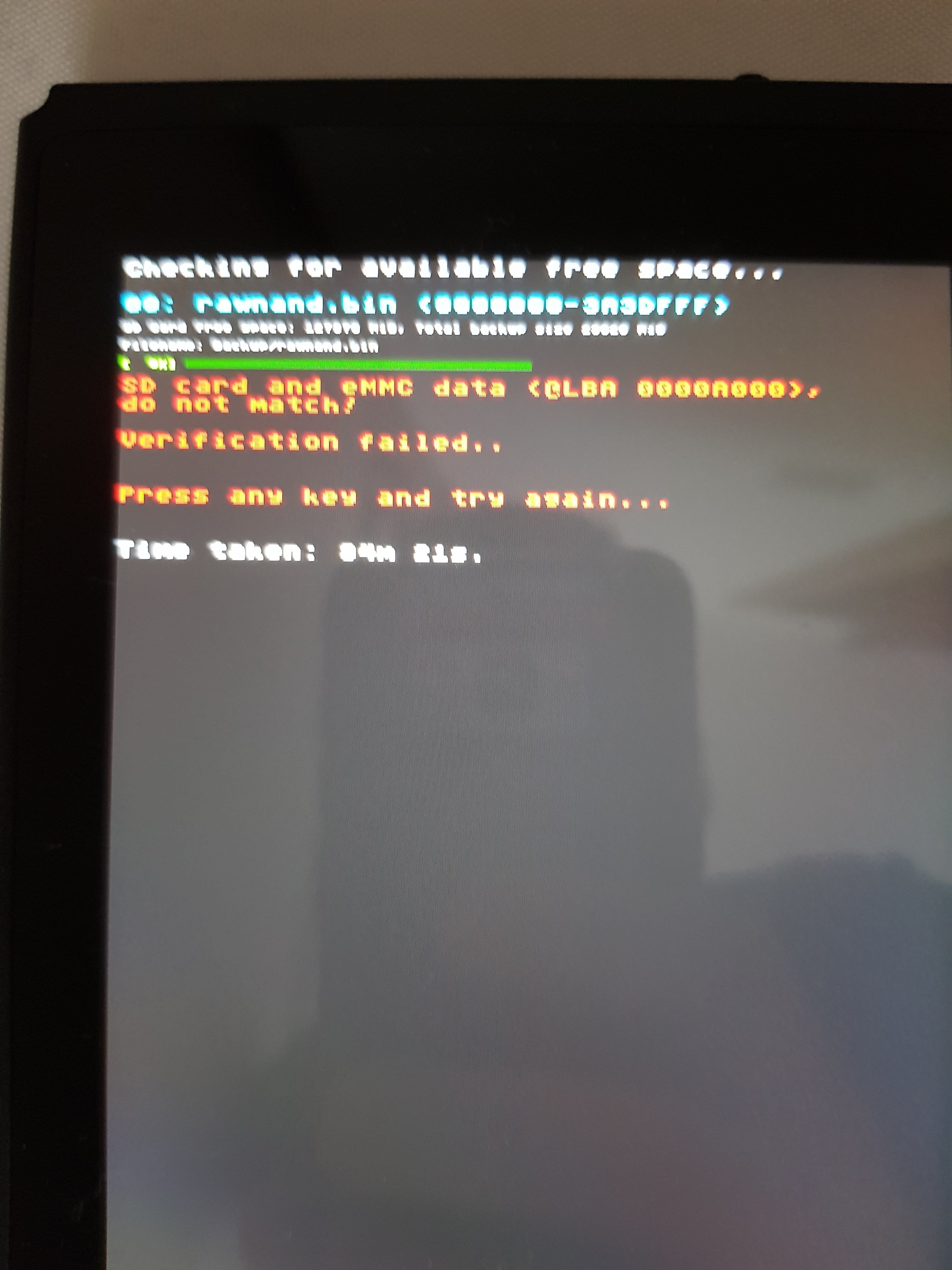

rawnand eMMC GPP backup verification failes! FW 2.3. i have test this with 3 other sd-card fat32 an exfat. i got everthing this error. anyone why?
new v3.2 i used
That's where the error occurred, not the actual error.
so next! everytime this issue
verifikation failed! 0000A0000
Can you open rawnnand.bin with a hex editor @0x1400000 and take a screenshot?
The best would be to test your sd card with h2testw.
Because it fails to compare the nand and sd card data, almost right away.
If everything is OK, try to do a partial backup, by copying the "partial.idx" file attached in OP to your root of your card.
creating new file calls partial.idx and copy to root of sd ? ok i try tis like your guide
