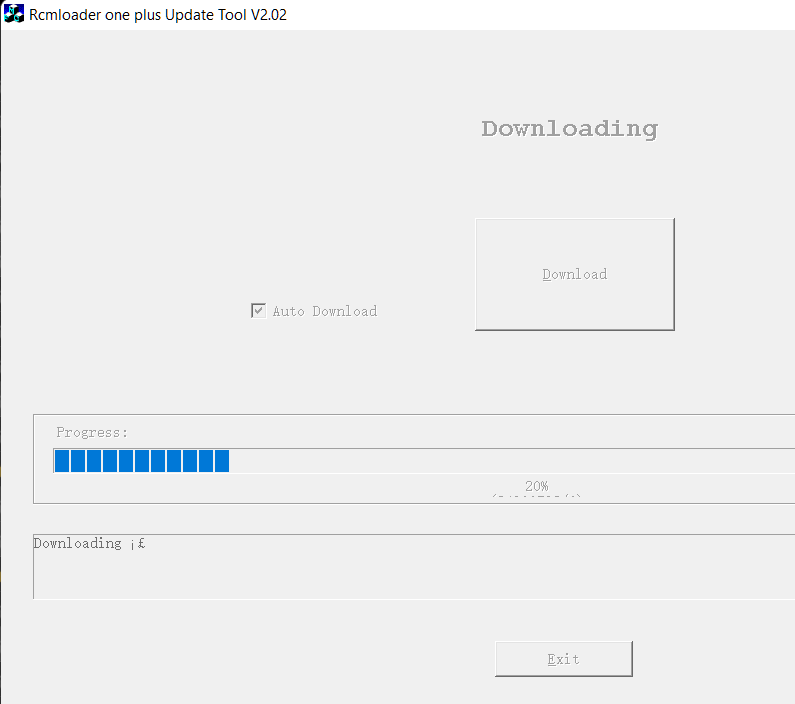

For me the history is:
brought a RCMLoader One Plus V2 (White cardboard box), at first it worked fine, I was able to inject hekate_ctcaer_5.6.5.bin as payload. Then I did try to add others payloads and get a strange error, because pressing the "+" button only could change the payload to Green one, pressing again only show green light, try to format the drive as FAT and extract the file downloaded from: https://www.xkit.xyz/wp-content/uploads/2021/11/USB-FLASH-DRIVE-files_20211117.zip on to the fresh formatted drive, then ejected the drive but pressing the + button give me nothing, no light no flashing, nothing!.
I did press the reset button but no luck, connecting the unit to the computer but no USB Mass Storage drive is detected, only a HID device.
Download the firmware updater http://www.xkit.xyz/wp-content/uploads/2021/09/RCMloader_One_Plus_Update_Tool_V2.02.zip and follow the instructions.
after almost 1 hour the updater is stuck on:
The "Downloading !£" keeps scrolling but no progress is made.
After disconnecting the unit from Computer, blue and green light keeps flashing.
Anybody knows how can I unbrick the unit? thanks a lot for your help
try to contact the support at the email on they support page, but get no delivery. and I can not use QQ so no contact has been possible.
Does anybody have a full updater wich reformat the USM drive, I think that cause the brick.
