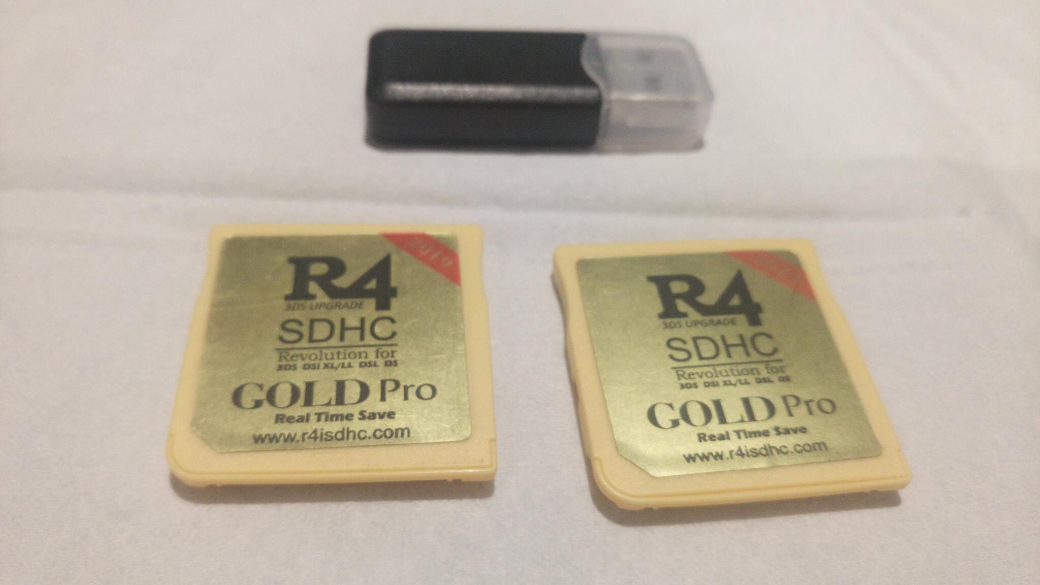

To help you to find the right Kernel/Software for your Flashcart,it helps a lot if you be so kind and post an Picture of your Flashcart.
Please the front,back and the electric contacts (there is maybe an Internet Link on it).
Then we maybe can help you.
Thank you.:)

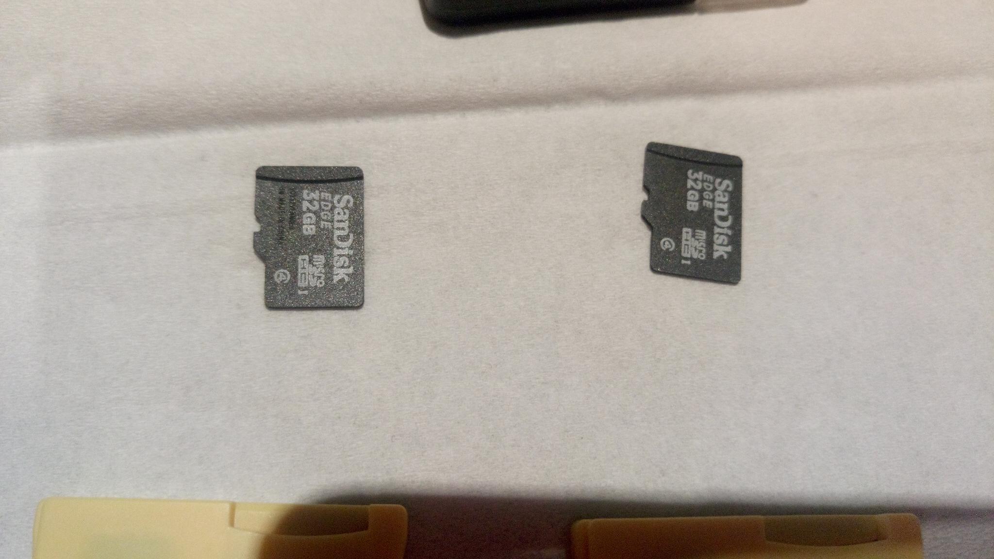

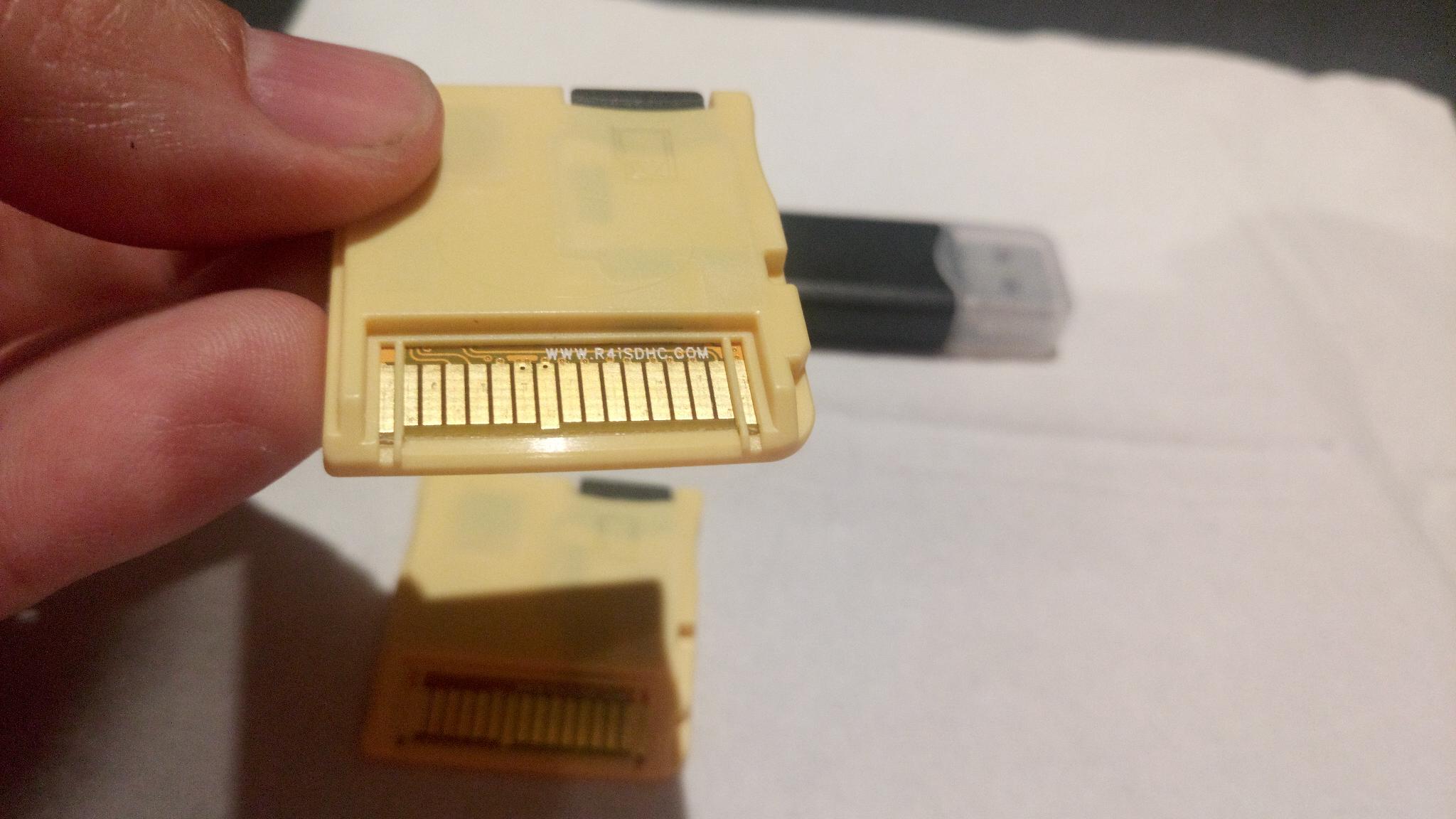

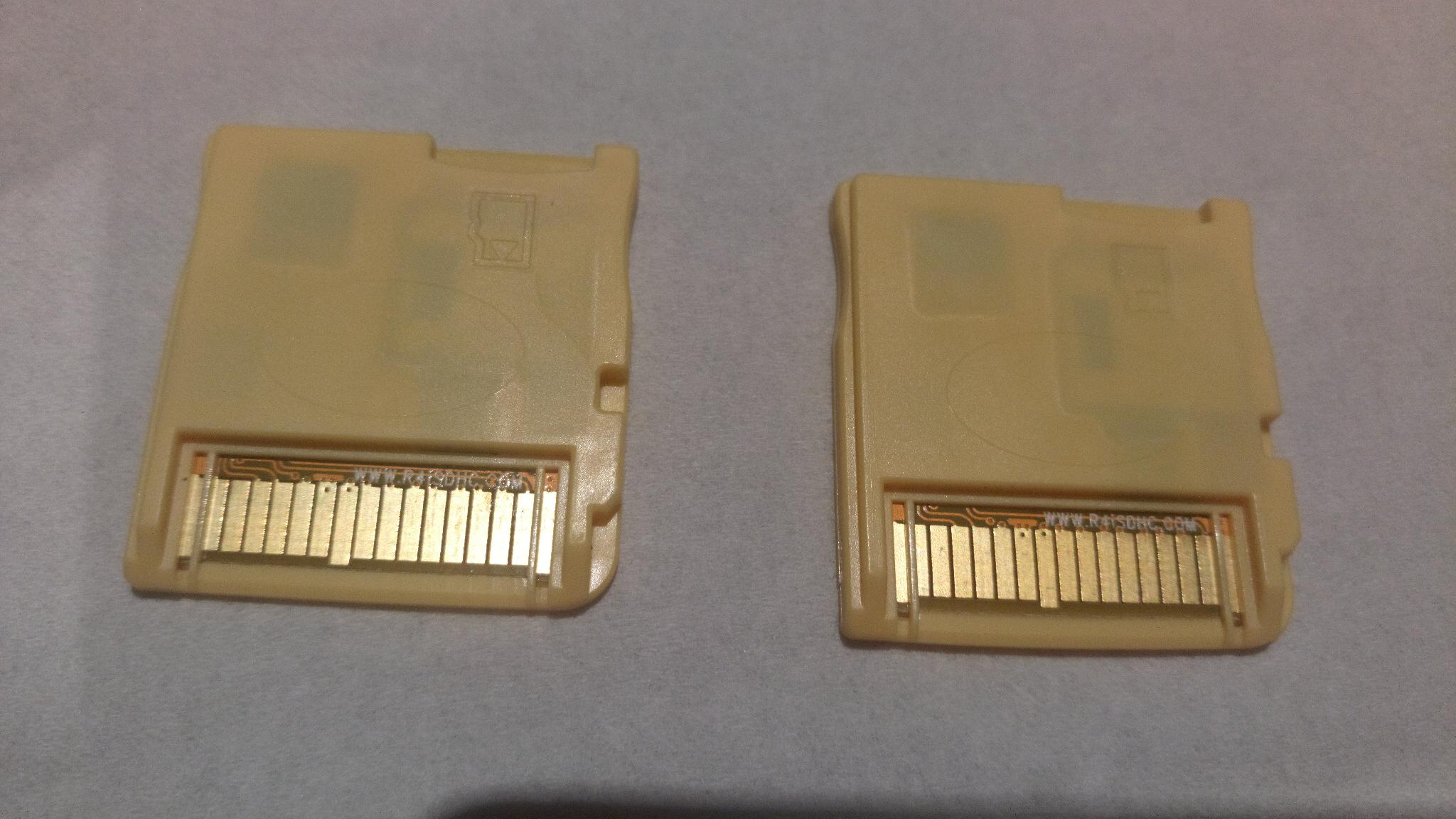

Some photos attached below.
They were purchased online using Taobao (Chinese shopping app). From memory, before I destroyed them, they showed up as one of the Bomberman games in the DS Home screen (I think it was Bomberman). One of them still does, but I need to find my DS charger to make sure.
Any help would be much appreciated!

That is the flashcard i own and has a timebomb date of september 3rd 2019 so if you get it working install ys menu. I know that it did imitate Touch! Bomberman Land by Nintendo.
