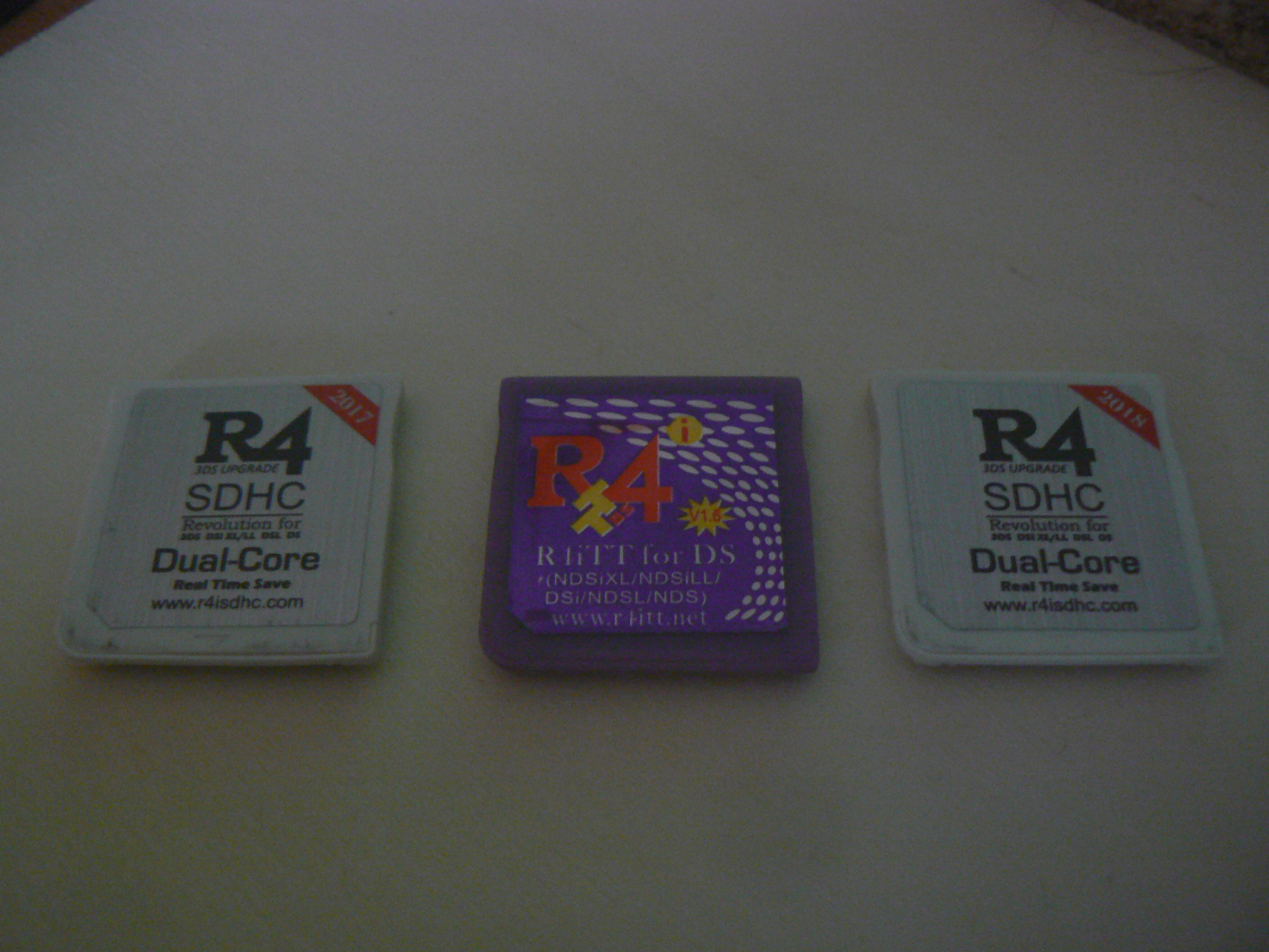

You said you have this one ?
https://gbatemp.net/threads/identification-needed-for-r4.542043/
