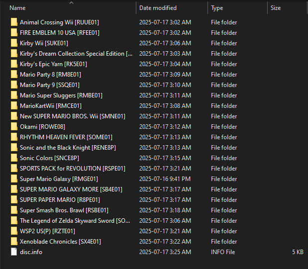

Hey guys I am having some trouble with Wii flow. My wii games are recognized but send me straight to the Wii home menu when booted. Can someone take a look at my syscheck and point me in the right direction? Thanks.
Some things to note:
-I am using a Samsung t7 SSD plugged into slot 0, it is formatted with ISFSHax USB partition plugin.
-My gamecube games dumps boot and work perfectly fine, no problems.
-I uninstalled and reinstalled all my cIOS to rule that out.
-Ive used wiiflow start configurator and set it to force 248,249,250,251. None get wii games to boot

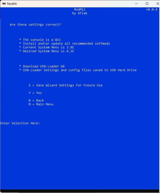

Screenshot:
Yes that's normal because you're not on 4.3, modmii will have u use a different exploit that accomplishes the same thing but doesn't require Mac address information from you

I have just finished reading carefully the extremely helpful guide generated by ModMii (WOW!!!!).
The guide indicated that the exploit used is Bannerbomb v1 (first time I've encountered this exploit) and the way to run the exploit seems to be different. Where in order to run LetterBomb one needs to go the message board, in order to run Bannerbomb v1 one needs to go into the options menu, choose data management etc.
I must say, I am confused.
My understanding is that one of the steps in the guide generated by ModMii will also update the wii menu from 3.4 to 4.3.
I also understood that one should be careful, even avoid, updating a modded wii system.
In this case, on the one hand, the exploit (Bannerbomb v1) is used for older systems (if I understood correctly, for 3.x-4.1 systems), so, logic says that the order of ModMii guide is first to use the exploit and after that, somehow, the system will be updated to 4.3. I have full confidence that there will not be an issue with the system update, but I am confused.
On the tutorials I saw, there always were 44 WADs installed.
But, in this specific case, ModMii generated 45 WADs.
Is the extra WAD the system update from 3.4 to 4.3? [WAD #44 is named: "SystemMenu_4.3E_v514"]
Correct. Video guides will often forget to mention that the wads listed in ModMii guides are unique to your situation, so the number of wads as well as which specific ones will differ from whatever video you saw.

I finally came around to go ahead with the softmodding. I have the time and with the research done the past few weeks made me feel comfortable enough. I am aware that I don't fully understand all the ins and outs.
Anyway, unfortunately, I came into a dead end. I have 2 different MicroSD cards and both failed to load on the wii.
Both were formatted to FAT32 and I tried several cluster sizes 4, 16 and 32KB.
One MicroSD card is a 64GB Samsung EVO.
The other is a 8GB Silicone Power (SP).
I tried 2 different SD adapters (from Micro to full size SD).
The cards are read perfectly on the laptop. I tried a USB to MicroSD adapter and the laptop's built-in SD card reader.
When I connect the card to the wii, nothing "pops up" on the main screen. My understanding is that I should see a SD icon on the bottom left side of the screen, but nothing apears.
The guide that was generated by MiiMod suggested using Bannerbomb v1.
As instructed, I browsed to: Wii Options, Data Management, Channels, SD Card.
On the screen there was a notice: The device inserted in the SD Card Slot can't be used.
I wonder what would you suggest from this point.
The wii is - RVL-001 (EUR) the was never modded, probably never connected to the internet.
Current version is: 3.4E.
Should I connect it the the internet, have the system update to 4.3E and try again the MiiMod with the new parameters?
Should I try and look around for a full size SD card and try with it? If so, what is the recommended minimal capacity?
Any other ideas / suggestions?
Thank you
If you're instructed to use bannerbomb v1 it's because you're on an older system menu version. The sd icon on the main menu is not found on some old system menus. So if you follow your modmii guide, it will show you how to launch bannerbomb v1 via the wii options / data management menu
Edit: also u can fully softmod the wii except for bootmii without an SD card

If you have internet on your wii you can use str2hax instead of bannerbomb. After having done so, the hbc should be able to read your larger card, u can softmod/upgrade to a newer system menu which will then also hopefully be able to read your larger capacity sd card should u need that functionality
DONE!!!
Thank you so much!
The wii console was modded. I followed the ModMii generated guide to the letter.
I used a 2GB MicroSD card and an adapter from MicroSD to full size SD. Worked perfectly.
After completing the guide I managed transferring one of the CDs to an external USB HDD, ejected the CD, and lunched the game through USB Loader GX and it worked.
