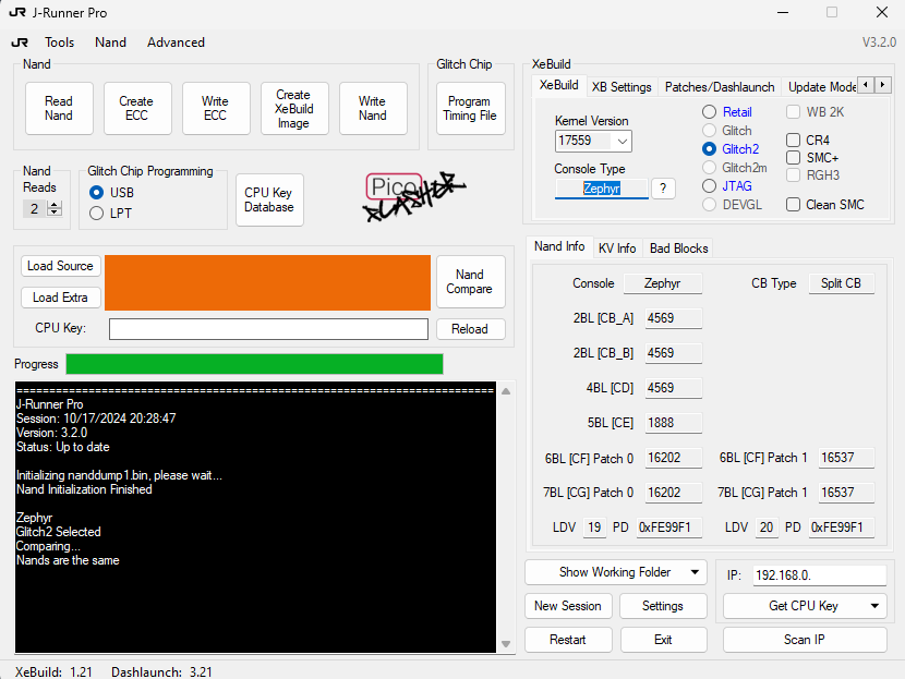

Just a small update, and maybe I need a confirmation to just give up. I read that I could use a Raspberry pi to read the nand, so i gave it a try.
Long story short, I was thinking that I have a Jasper board, but I have a Zephyr one.
I did all steps like a Jasper board. Diode, resistor and Jrunner with a Raspberry pi > Read Nand. As you can see, the sad news for me, I can not use RGH3.
So, what are my options? ModChip? Maybe just give up?
