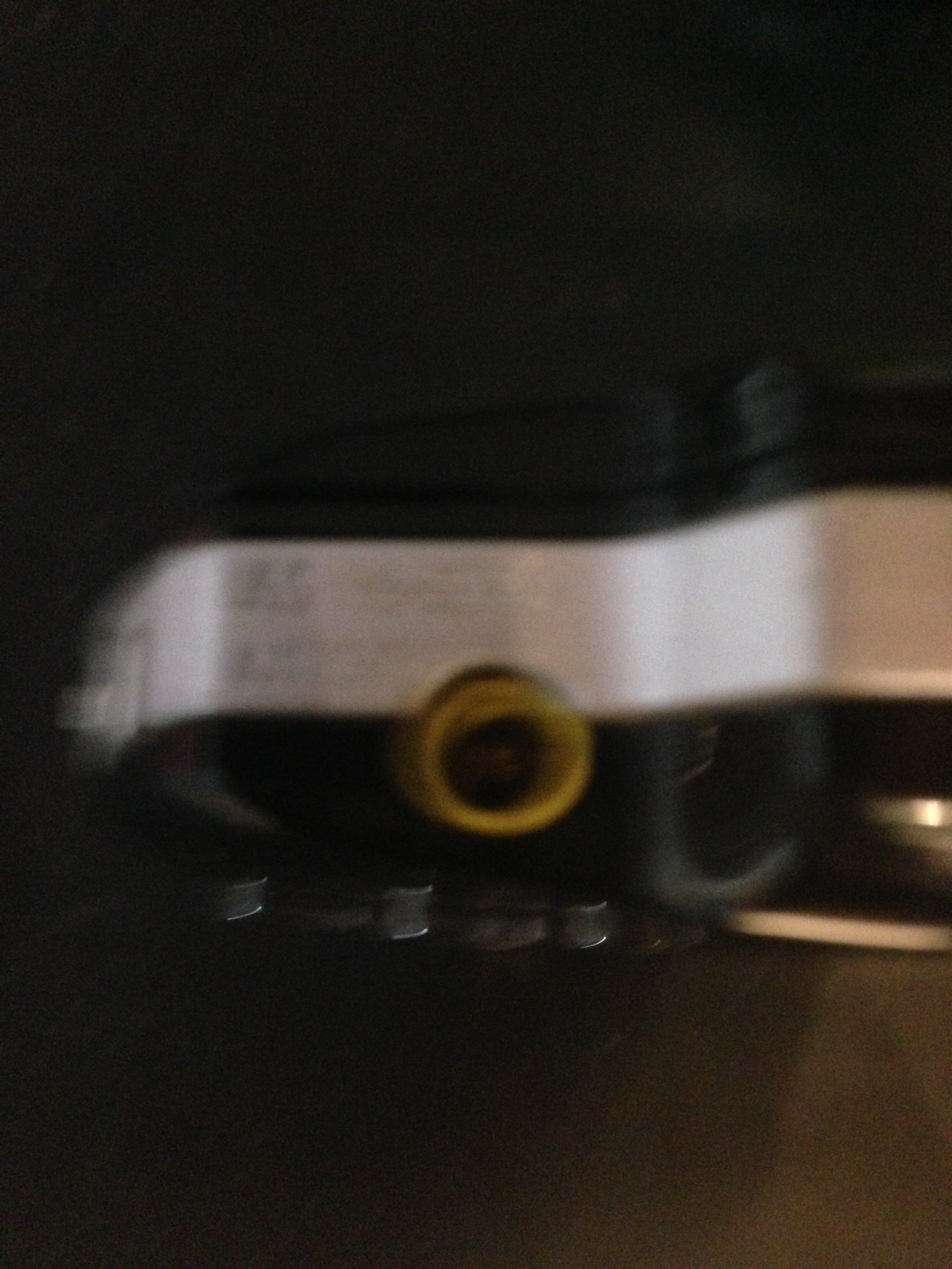

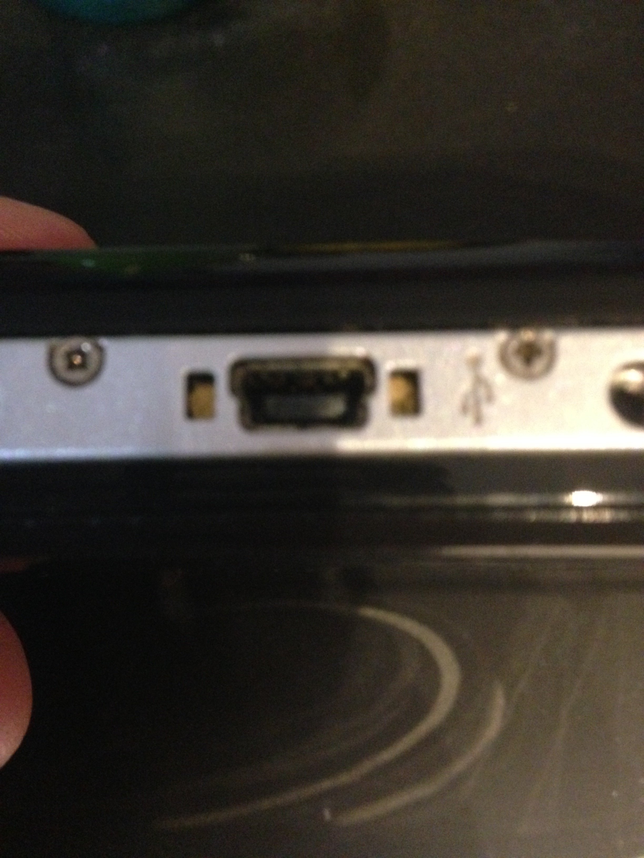

Hello, so I need some help. I have a PSP that has a broken charging port [The yellow one]. Is there any other way to charge it [Like the top ps3 cable port]?

nope i have a psp 3001c those are just pics from google :teach:
i'll update the pics to my psp
aaaaah
Well, considering that you'd have to open it up in the first place, I would say "buy a new charger socket", they're cheap from China and no precision soldering required: https://www.ebay.it/itm/191332523401
For permanent CFW, the newest is 6.61 LME with the Infinity permapatch
ok pictures are updated...

I heard that you could change it in setting to charge through that top port...
Officially it only works while you are in USB memory stick reader mode (CFW fixes the issue), but you still need to boot the console and leave it on - if you run out of battery you're screwed (unless you cheat with an external battery charger)
Hmmm would it be possible to charge it then put cfw on it.... then change in settings?
or should I just buy the replacement?
Sure: again, as long as you never run out of battery or have a standalone charge
My opinion is to just get a new socket, no reason to give yourself this arbitrary and uncomfortable restriction
