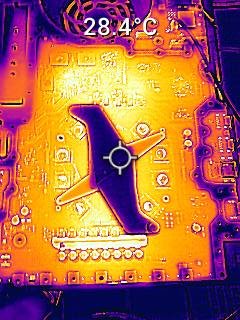

I have a PS5 on my bench with single beep BLOD. It flashes blue light for around 3s and then goes off. Second try is beep only (Init phase only). Then third again 3s.
All fuses are good. Init phase is 311mA then 7mA. Good so far.
Thermal cam Shows every relevant component flashes warm and then shut off. RAM, CPU, SSD Controller, Rail Mosfets.

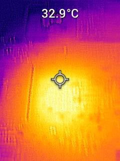

i have the same error, the PS5 made 1 beep but does not turn on, after 3 seconds again push the pwr button on the ps5 Turn on but still flashing on Blue light,
also i check the PS5 with a thermal camera and have the same behaviour, the 8 GDDR6s, voltage controller and the SSD controllera are wamr arround 80 ªC
Could you help me to know wich is the ram 5 and why this ram?

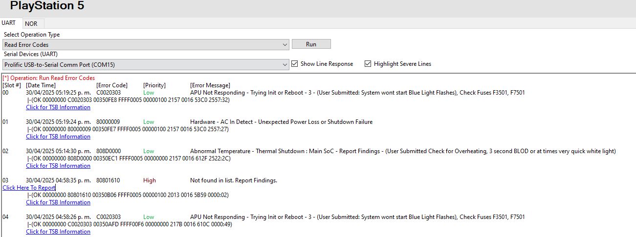

Your APU temperatur readings are to high:
53C0 = 83.xx °C
612F = 97.xx °C
5B59 = 91.xx °C
610C = 97.xx °C
I would check the liquid metal on the APU for oxidation/dryspots.
Reactions: raveisrael
53C0 = 83.xx °C
612F = 97.xx °C
5B59 = 91.xx °C
610C = 97.xx °C
Thank you, the temperature and the failure regarding the APU was due to i was turning on the ps5 with out heat disipator, the ps5 restars after some seconds for the overheat, when i put the thermal disipator the ps5 does not reboot by over temperature
So i traying to solve the code 80801610

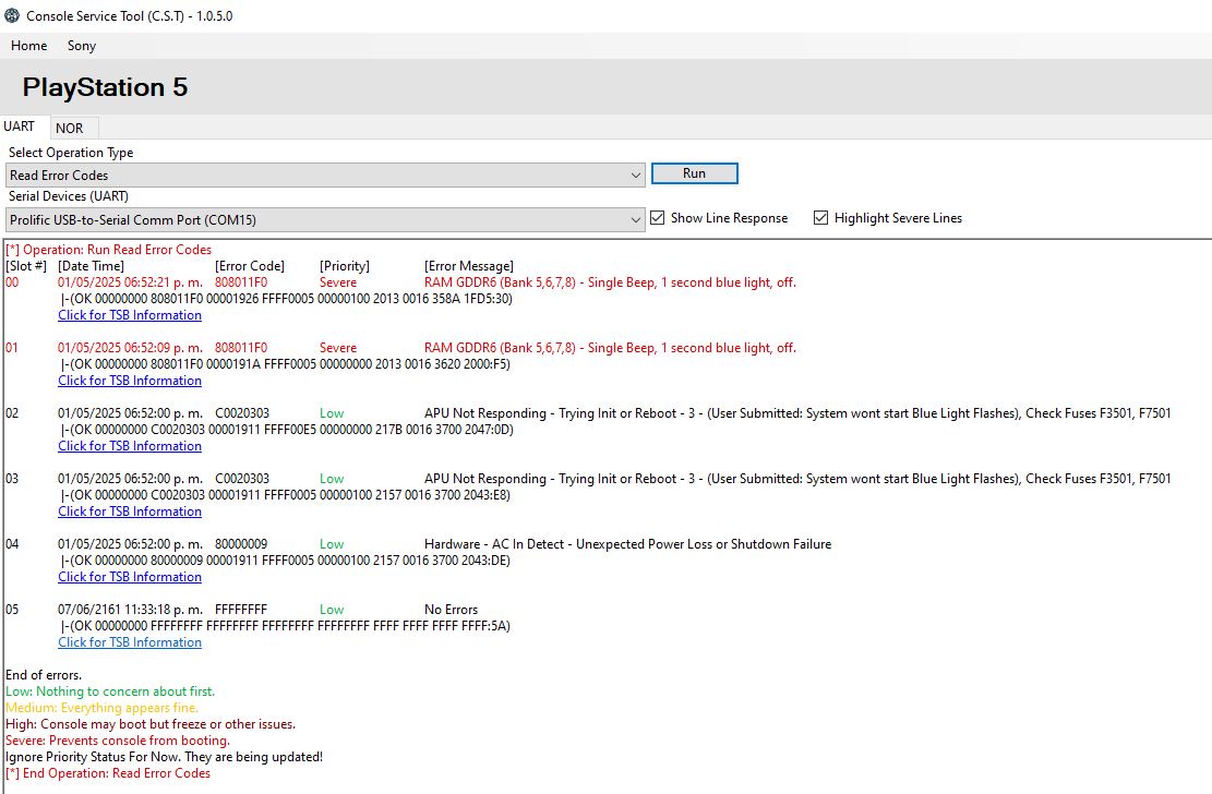

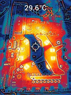

Hey Guys Hello,
Now im checking the DDR6 number 5, and also i detect a detached component ( one capacitor 0402 of 1 Uf, replaced by a other PS5) and also i found a hit in a trace (is not open only has not solder mask)
well after the repair the GDD6s were not warms any more, only the SSD controlled is warm
i erase the codes and i get new ones
01 01/05/2025 06:52:09 p. m. 808011F0 Severe RAM GDDR6 (Bank 5,6,7,8) - Single Beep, 1 second blue light, off.
|-(OK 00000000 808011F0 0000191A FFFF0005 00000000 2013 0016 3620 2000:F5)
Click for TSB Information
02 01/05/2025 06:52:00 p. m. C0020303 Low APU Not Responding - Trying Init or Reboot - 3 - (User Submitted: System wont start Blue Light Flashes), Check Fuses F3501, F7501
|-(OK 00000000 C0020303 00001911 FFFF00E5 00000000 217B 0016 3700 2047:0D)
sometimes start with one beep and turn off and somethimes is blinking stalling in blue light
