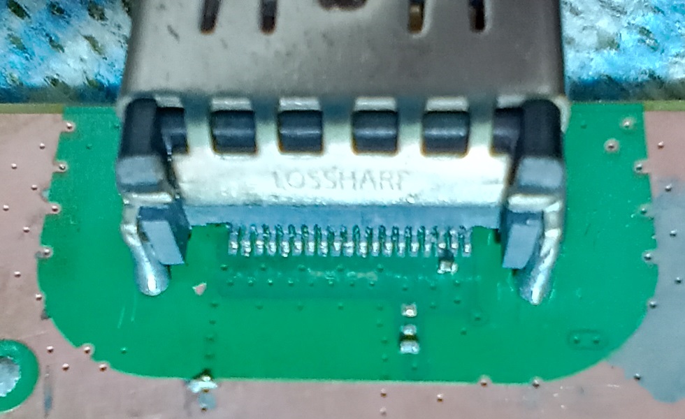

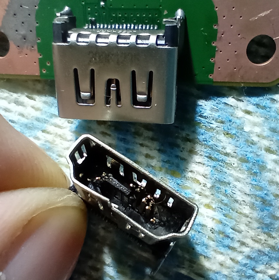

The picture on the TV keeps flashing after the PS5 was dropped and the HDMI connector replaced. There are times when it is normal for 3 to 5 seconds, after which it flashes again. Any suggestions?
Hello everyone.
Did you get the hdmi port swapped by a shop? If so take it back there. Sounds like not a great connection on the port to board.
Reactions: Jehmyson
I replaced it myself, I
I replaced it myself, I have some experience in soldering small components, so I didn't have much difficulty soldering the connector

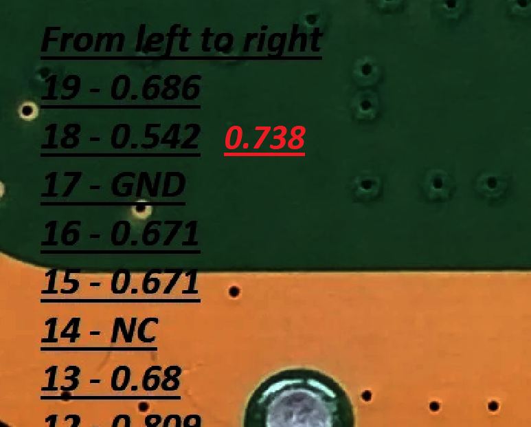

The 100nf capacitor looks askew, take meter and get diode readings on all 19 pins, red probe on ground and let me know what your readings are. Also have you check all the pins are solidly connected by trying to move them with tweezers? Lastly try looking inside the new port, if there is flux, clean it out with a toothbrush and ipa.
Reactions: Jehmyson
Tnks! All pins are solidify and tested. No flux residues, everything cleaned with isopropanol, however, I tested all lines and the only one that made a difference was line 18, with 0.738 where it should be with 0.542. I don't know why.
Your 5v current limiter IC is blown. You need to replace it with a TPS2553DDBVR. This IC regulates 5v on pin 18. You may have a chip with diff marking because sony just sources the cheapest IC available, but you can change it with a new TPS2553DDBVR. It's readily available on digikey. If you're not sure which IC it is, it's the 6 legged IC behind the hdmi circuit.
Reactions: Jehmyson
